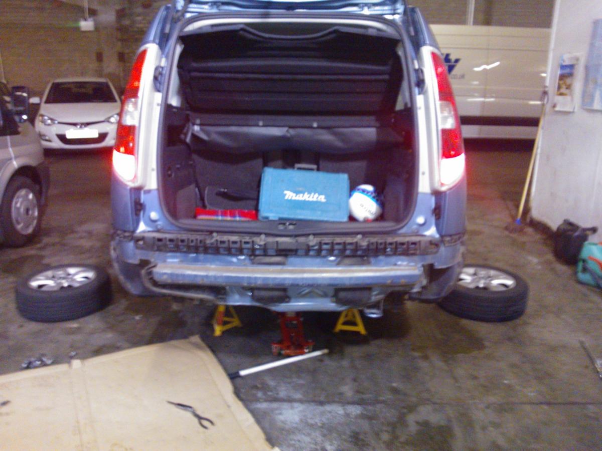

Thanks Redman, I realise this is an old post but it's the best I can find. Going to try it next week and wondered if there are any other tips that may be useful? I have a fixed tow hitch fitted (that's what I am accessing) Did removing the wheels help?
Edited by bryanb
Thanks again Watson, can't think why I said Redman. Anyway I did the job without a hitch. I found removing the wheels was useful.
I would like to add that I have reversing sensors in the bumper, their cable is long enough to gain reasonable access but would have to be removed if you wanted to take the bumper away from the car.
Great post, I followed easy guide that you laid out and surprised myself by doing it. I didn't have time to take wheels off but managed it just fine. I would just like to Post Script about the plastic rivets and reversing sensors.
I bought a bag of 10 new plastic rivets beforehand as I knew I'd probably break the old ones (which I did of course) and the point of removing the rear bumper was to re-glue the sensors back in position. The wiring is held in with metal clips that pop off easy enough and clip back on just as easy.
I pulled the sensor wiring plugs off using a small screwdriver to push in the tiny locking lug then wiggling the plug off. The bumper just comes right off then.
The sensors are stuck on using what looks likest black mastic type goo that dries to a brittle crisp, I cleaned this stuff off easily and used a 2 pack type fast set glue. Solid. Well pleased.
Thanks Watson, big salute.
