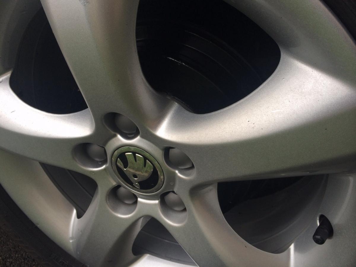

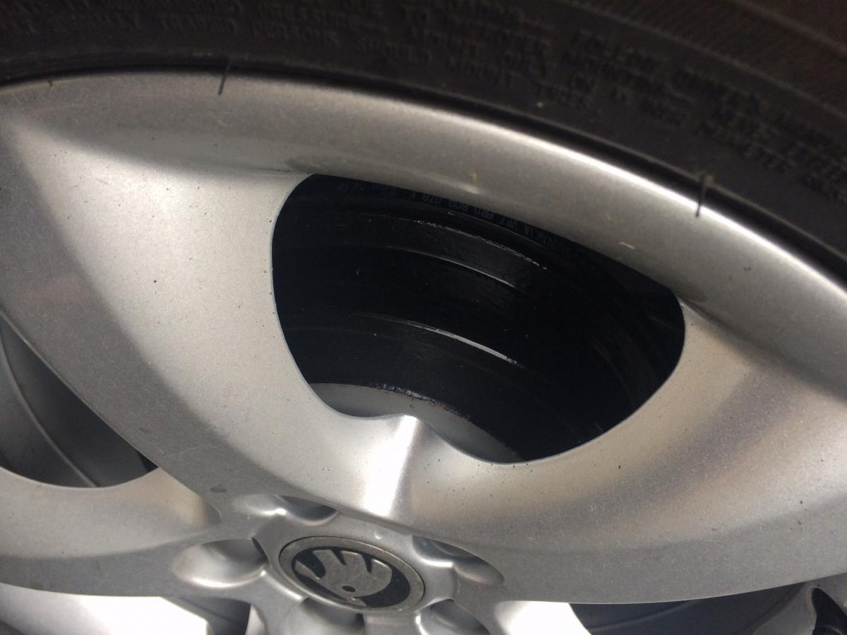

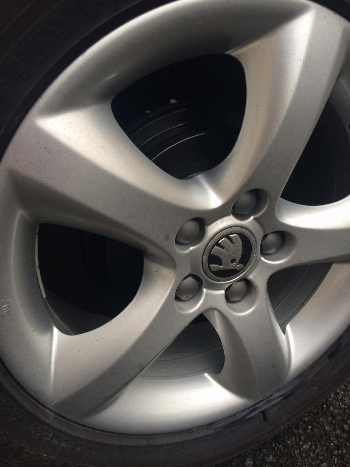

I did my rear drums in smooth black
My drums hadnt got rusty yet so didnt need too much rubbing down.
All i did was remove the wheel, give it a rub down with some wet n dry, remove dust, and paint with a brush.
I was careful not to paint where the wheel makes contact with the drum for obvious reasons.
One coat was good enough as its pretty thick stuff.
Put some copper slip where the wheel meets the drum to help stop the wheel seizing on in the future and put the wheel back on.
It dried nicely and looks good imo.

Pictures arent much good are they haa.
And the wheels abit dirty! Impossible to keep it clean this time of year isnt it.
