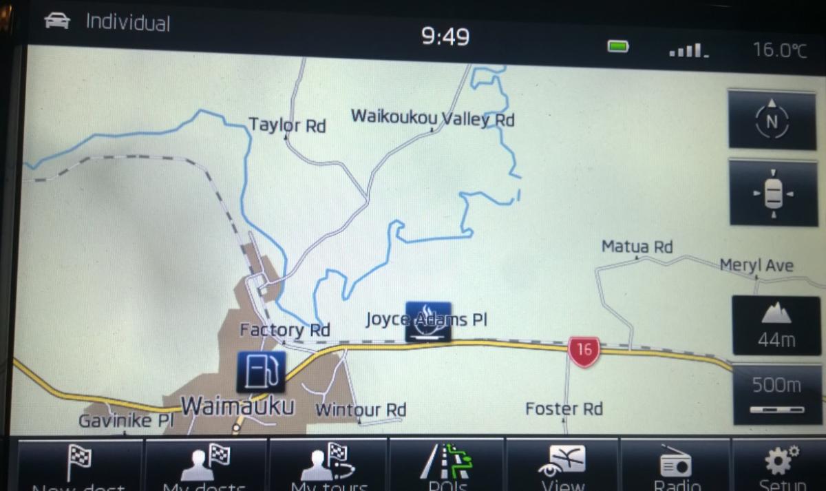

shlte. Well, in NZ anyway! I've tested it on a couple of trips out of town when I knew the way and there are a number of roads that just aren't included - not minor dirt roads or anything, these are proper roads with houses etc. They're the fastest way between a couple of towns. I loaded up Google maps to do a side by side comparison and it was like I was in different locations! The Columbus trip from A to B was 37 minutes, the same trip in Google maps (with its fancy extra roads...) was 17 minutes.

Interesting - which roads is it missing Kitset?  I haven't had any problems with mine (I'm in Tauranga) except that its missing some of the new Hamilton ring road - but to be fair those roads are only a couple months old and I've had the car since March!
The area I was driving is north of Auckland, between SH16 and SH1. https://www.google.co.nz/maps/@-36.7187024,174.5130134,13z
It's rural, but there are dozens of roads and quite a lot of activity - vinyards, businesses, houses, etc. Here's the same area in the Sat Nav (it's zoomed out, but if you zoom in there are no more roads than shown).
The Sat Nav effectively shows only two roads (Kahikatea Flat Road and West Coast Road - neither shown in my image) off SH16 between Riverhead Road and the town of Wellsford - a distance of 80km. There are actually dozens and dozens of roads in the area, many of which save considerable time than staying on SH16. Sure, if you used the Sat Nav you'd get where you wanted to go, but potentially waste a hell of a lot of petrol on the way (and miss a bunch of very fun roads!). And too bad if you wanted to visit friends who lived in the area, or take a trip to the wonderful Matua Valley Wines on Waikoukou Valley Road - they don't exist on Skoda's maps!

Keep forgetting to update - I had a look the other day and can see many roads between Kumeu and Wellsford (including Waikoukou Valley Rd). However I'm not sure if Skoda updated the maps when it was in getting a towbar a few weeks ago.
Excellent, thanks for checking. Those are definitely missing on mine, I was driving on Taylor Road but the car was on no man's land on the screen! Looks like I might have an old map version. I'll contact the dealer and find out how to update.
Don't suppose you could have a quick look at your map version? Mine is V03959800BL0033 ROW. I've sent an email to the service team at Giltrap, but it would be good to know if you do have a different version.
Mine is V03959800SK0030 ROW 2014 - so it looks like a different version - as I say they may have updated mine when the towbar was done a few weeks ago - wish i'd taken a note of what it was originally!  Hope this helps.
