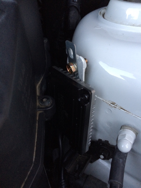

Anyone got some pics of where they've mounted the ballasts ? Particularly on a Tdi drivers side where space is limited
Used cable ties for mine and just randomly tied it to where i could...it doesn't matter that much i don't think as long as it doesn't move about or rattle about
That's what I plan to do, im going to stick it to the inner wing on the passengers side as there is plenty room but on drivers side it is limited with space due to the fuel filter
I tied mine to these metal pipes that run down, got no clue what they are or what they are called but i'll refer to them as metal pipes :D
On passenger side with the bolt provided [emoji106]
Sorry no pic of drivers side but it's bolted to the metal beam above the light
Air con pipes
