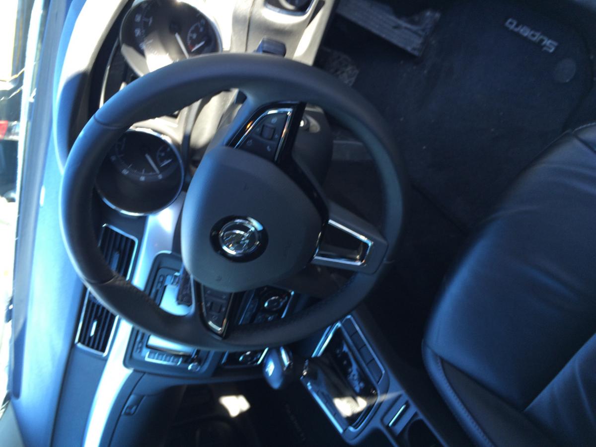

Okay paddleshift steering wheel now fitted and all multi functions are working! Just needs to get the paddleshift coded via VCDS.
Pictures to follow tomorrow...

I ordered my steering wheel which comes with the paddleshift and airbag from Skoda dop from the Czech rep and it was £287 delivered.
Fitting is:
- Disconnect battery leave for 5 mins.
- Unclip two airbag clips on rear of airbag. Lift airbag out and unclip the two connectors (yellow and black) for airbag and multifunction then fully lift out the airbag and place out of the way.
- Using m12 spline bit remove bolt in centre of the wheel and lift off steering wheel
- Place new steering wheel on and refit bolt and torque to 50nm making sure the steering wheel remains straight.
- Connect black and yellow connectors from rear of airbag to steering wheel then give the airbag a firm push to clip into place.
- Reconnect battery
- Turn on ignition and test out steering wheel functions then drive 100 meters to clear all warning lights which will be on having disconnected the battery
- Get a nice Briskoda member to VCDS code the paddleshift. Total cost wheel £287 a bit of manual labour and some beer tokens for VCDS coding
Edited by Chunk11
Due to xmas the wheel took approximately 6 weeks to arrive and the fitting approximately 20 - 25 minutes. You may have seen some of the problems I had with fitting my wheel but that was down to them sending me the wrong loom/connectors. Without this accidental issue everything is straight forward.

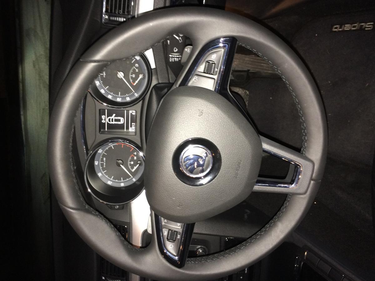

Not sure why my two latest photos have rotated themselves sideways?
Edited by Chunk11
Been to a very kind brisky members house today and had the paddleshift activated so spent lots of time on my journey today unnecessarily changing gear via paddleshift...

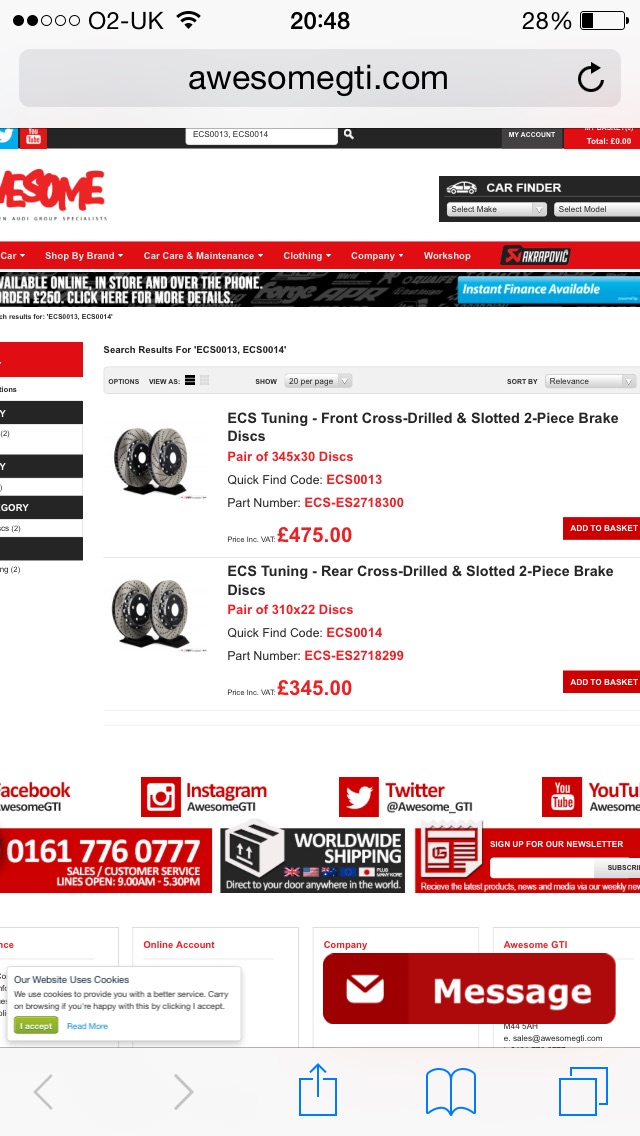

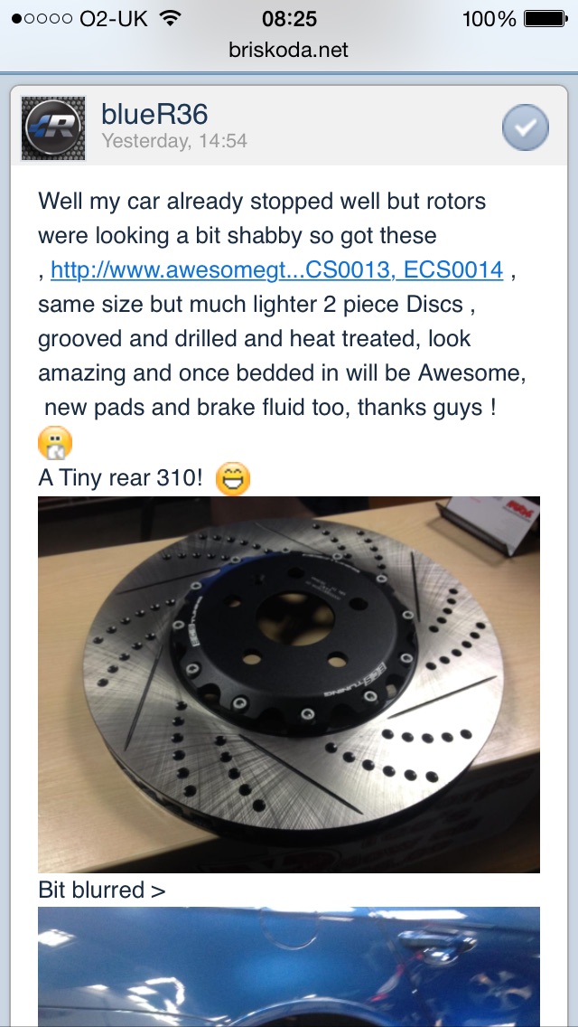

Right the next two mods on my list:
- ECS drilled/grooved discs with uprated pads £1000
- Cat back exhaust £600
Hopefully if I can work some decent overtime should be getting these in the next couple of months!
Sorry for making you spend your money chunk !
Ha ha no problem it was getting spent anyway your just guiding me in the right direction...
