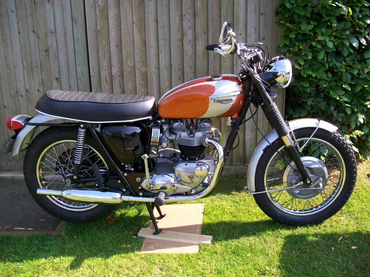

I used a similar product supplied by CASTROL in order to reduce the pinking on my classic bike (see attached). The CASTROL version was also combined with a chemical to mimic lead which this was intended to protect the valve seats.
In then end I bit the bullet did a head conversion and installed electronic ignition so it ran without pinking on what passes for petrol these days.  I then no longer had a need to use an octane booster.
