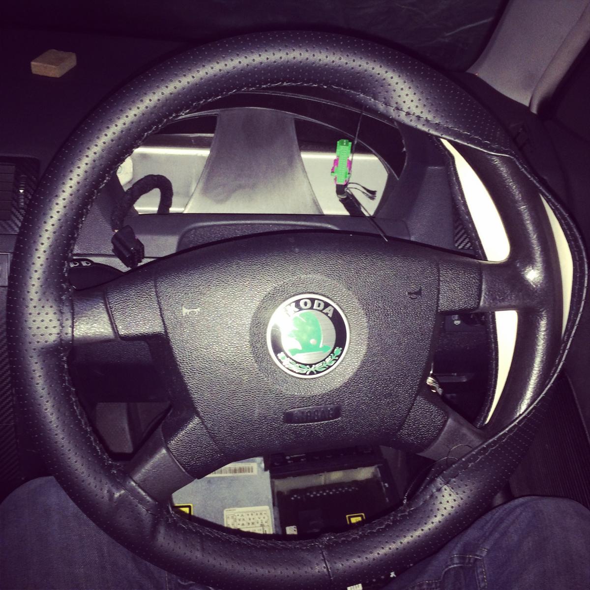

2.) leather steering wheel cover ( i don't like the vrs wheel so stitched a cover onto my existing one ) not yet finished!

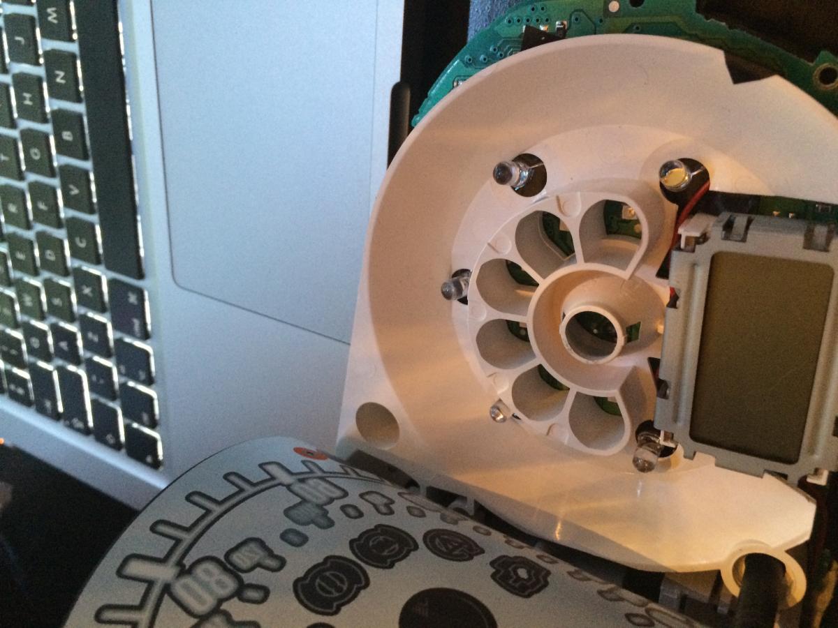

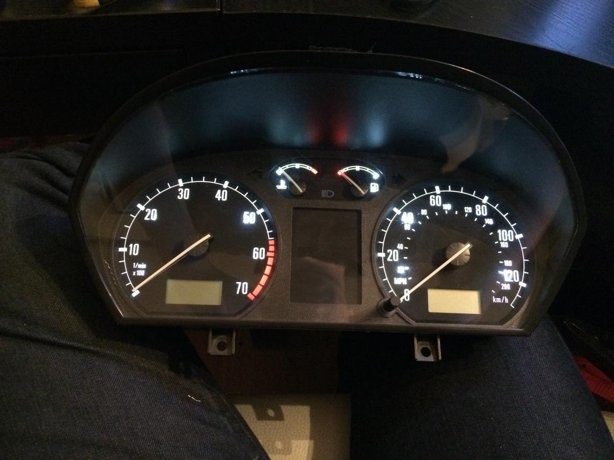

3.) interior light colour changed including the dash which didn't involve tampering with the existing smd's on my new speedo ( my original was blown up by me , trial and error i guess )

How did you change the instrument illumination colour without changing the SMDs?
the original smds  are still in place, i had a semi genius idea as i didn't want to blow up another cluster what i did was :
create my own LED circuitry using 5mm and 3mm LED's and wired them up to the illumination pins on the dash connector :)
works a treat
works a treat
Wow, that's bloody clever mate! :)
That's absolutely ingenious 'tombirch95' wish I was knowledgable enough to attempt the same..sigh...
it doesn't take much skill mate,you can learn the skills needed with a youtube video, simple solder work and your all good. need any help let me know
