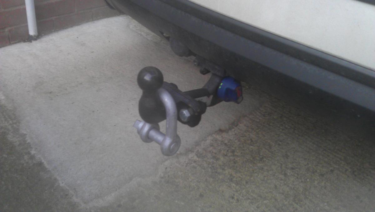

As winter is coming, I thought I'd have a look and check everything is there in my car and how the tow eye connects. When I took the cover off at the rear, I saw that the tow bar I have has no hole for the tow eye to screw into. Good job I checked and it may be worth some others do too.
My solution was to get a load rated shackle (3T SWL) that is wide enough to go around the neck of the tow bar but wont fit over the ball.
I don't intend to pull people out, but sometimes needs must or I might need recovery myself.

I am aware, I would never attempt a snatch recovery with it, which is what they're almost always doing when it goes wrong. But lacking anything else to attach to at the rear, I thought I'd at least make it as safe as possible (eliminate chance of it slipping off). If I can get one for a reasonable price, I can get a ball and pin replacement as I went for a flange type.
3 tonne is too low. You should have a shackle that is at least double the weight of the car, so 4 tonne minimum, and the higher the better.
Personally if mounting on the tow ball I prefer a strop with a loop on the end to go over it, and a shackle for the other vehicle.
That one I linked to should be OK then ?
You should be able to take the shackle out of one end to leave a loop, but from memory I couldn't tell you if the loop is big enough to go over a towball.
Yours looks fine, and yes it does look like it has a big enough loop to fit over the ball.
The one thing to make sure of is that the "pull" is not upwards from the ball, otherwise the loop can pull off.
Just been out to check, yes I could fit my arm right through the loop so definitely OK to go over a towball !
Attached is a photo, the shackles are pretty big. The £1 coin is a crude attempt to give some scale...
I have a loop I can put over the hook, but I wanted it to be secure. The shackles I have are about as meaty as muddyboots' (the D one for going around the towbar . Ill get a picture of the assembly.
I've checked and they're tested to 6 tons with a 12 ton minimum break limit.
The problem with using shackles on tow balls is if they can fit over the top of the ball. If they can it could mean that with an upward pull they could fly off. If they only fit by undoing the thread that is better.
At least if just a strop comes off it won't hurt as much!

These shackles are untested. Tested ones have the rating forged into the bow and generally have a painted pin.
Thats why I went for a shackle thats smaller than a towball. It slides around the neck, but its too narrow for the ball.

The shackle:
Where did you get it from ?
