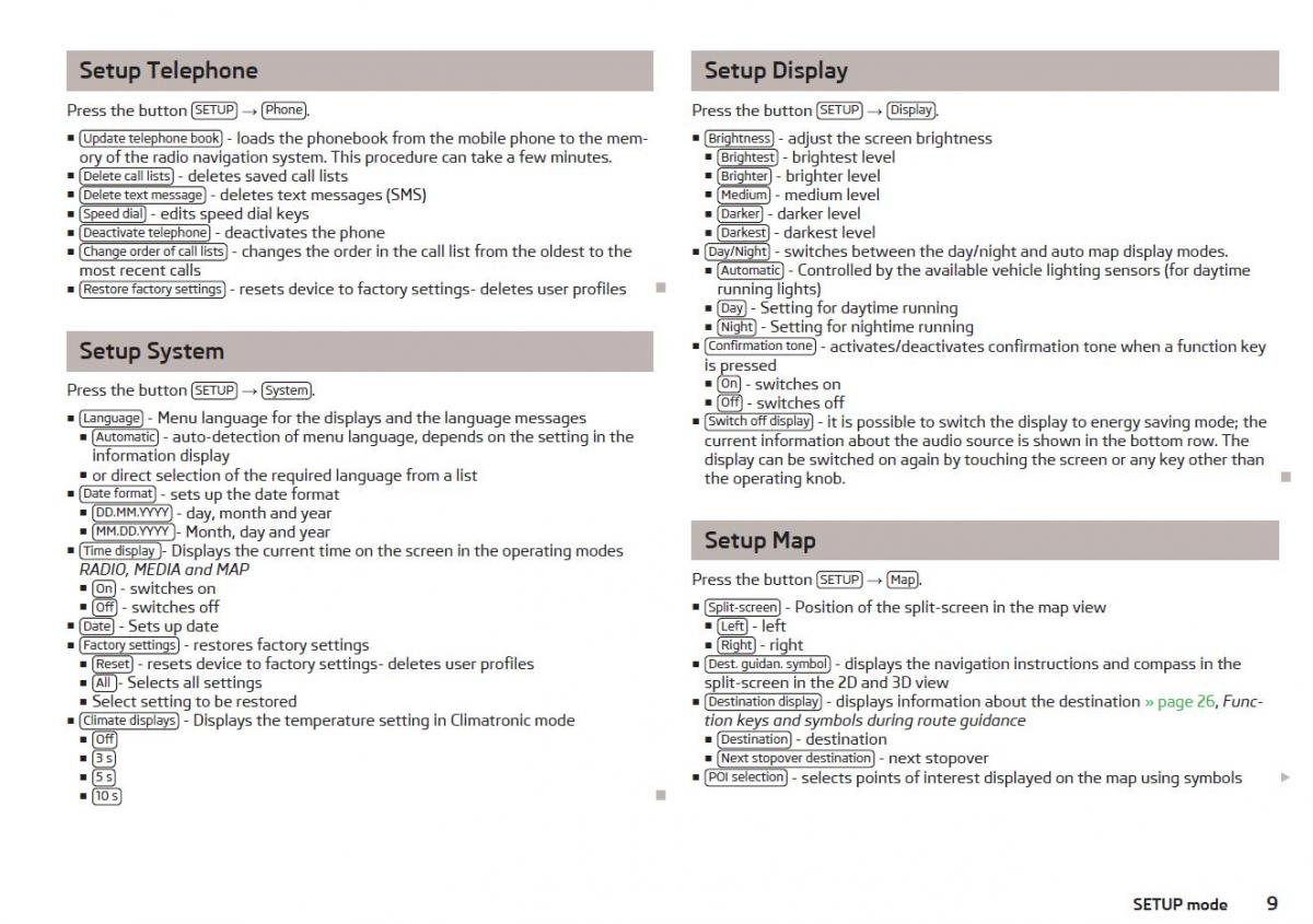

Of course the other way to get a manual is to download it here.
https://www.google.co.uk/url?sa=t&source=web&rct=j&ei=TplxVPv4H4rcatzVgpgJ&url=http://www.octinfo.com/download.php%3Ffile%3Dmanual/octavia3/A7_Octavia_Bolero_InfotainmentRadio.pdf&ved=0CC0QFjAC&usg=AFQjCNGNKxxV3qpfTHN4zXktutjyq7Ia2A&sig2=Kp7-B8P6JmZWm-CBR-KZ7A
It may be that the Octavia Bolero is newer/different, but bottom of page 8 explains how to set the clock up, to display when the unit is off. Hope it helps.

On the Superb Columbus it is in the "set up" menu, I did mine, under "set up system" and "time display"

Yipee! Yep, it works.... the time pops-up after a few seconds in place of the Station name. Thanks Stuart! :)
