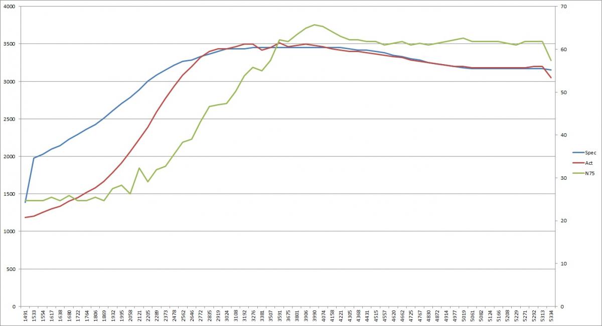

I'd be curious to see a group 11 log of your turbo. :)
Ask and you shall receive.... ;)
ScreenShot2014-11-23at150344_zps3e672121
ScreenShot2014-11-23at150420_zps71fe23eb
Mapping is not finished yet don't forget! John's been slowly upping the boost up the revs, so more will come higher up if he's happy :)

Looks a smart boost curve.  Mine looks to be coming in fractionally later but that could be down to either mine being the 2566vk hybrid, or that simply there's a little more setting up to do.  Mine only currently peaks at 3000 (as running a 2 bar map for testing) but it shows a very similar climb of boost.
At the moment mine looks to be:-
1 bar at 2200rpm
1.4 bar at 2500rpm
1.8 bar at 2700rpm
2 bar at 3000rpm and holds steady to 5061rpm
I think my limiter is set to 5100 but I might get that raised a bit :D  I see yours is 5300 :D
What % is your actuator at 4000rpm on a WOT log?
My duty cycle is about 72% at 4000rpm (+/- 2 %) which is apparently bang on.  Not bad considering it was set up using a vacuum gauge at a suggested level.  Only the stopscrew has needed winding out about 225 degrees to encourage earlier boost.  It might still need bringing out more.
See it in graph form. Worth mentioning this is boosting higher then what XMAN recommends (2.2bar) but Alex is greedy :) Aiming for smoke free so EGT will be sensible.
Going of the logs from Alex's car and running it through some calculations to work out volumetric efficiency I predict the following. This is aiming for little to no smoke and assuming no other bottle necks to the airflow the higher up the boost you go.
1.8 bar - 220 bhp
2.0 bar - 235 bhp
2.2 bar - 250 bhp
2.4 bar - 265 bhp
2.6 bar - 280 bhp
2.8 bar - 300 bhp
3.0 bar - 310 bhp
Considering I've been running at 2.45bar in the mid-range, how have my injectors been coping John?!
As I noticed quite a difference in performance when you upped it from 2.2!
I'm definitely greedy though ;)  Might as well make the most of what you've got!
