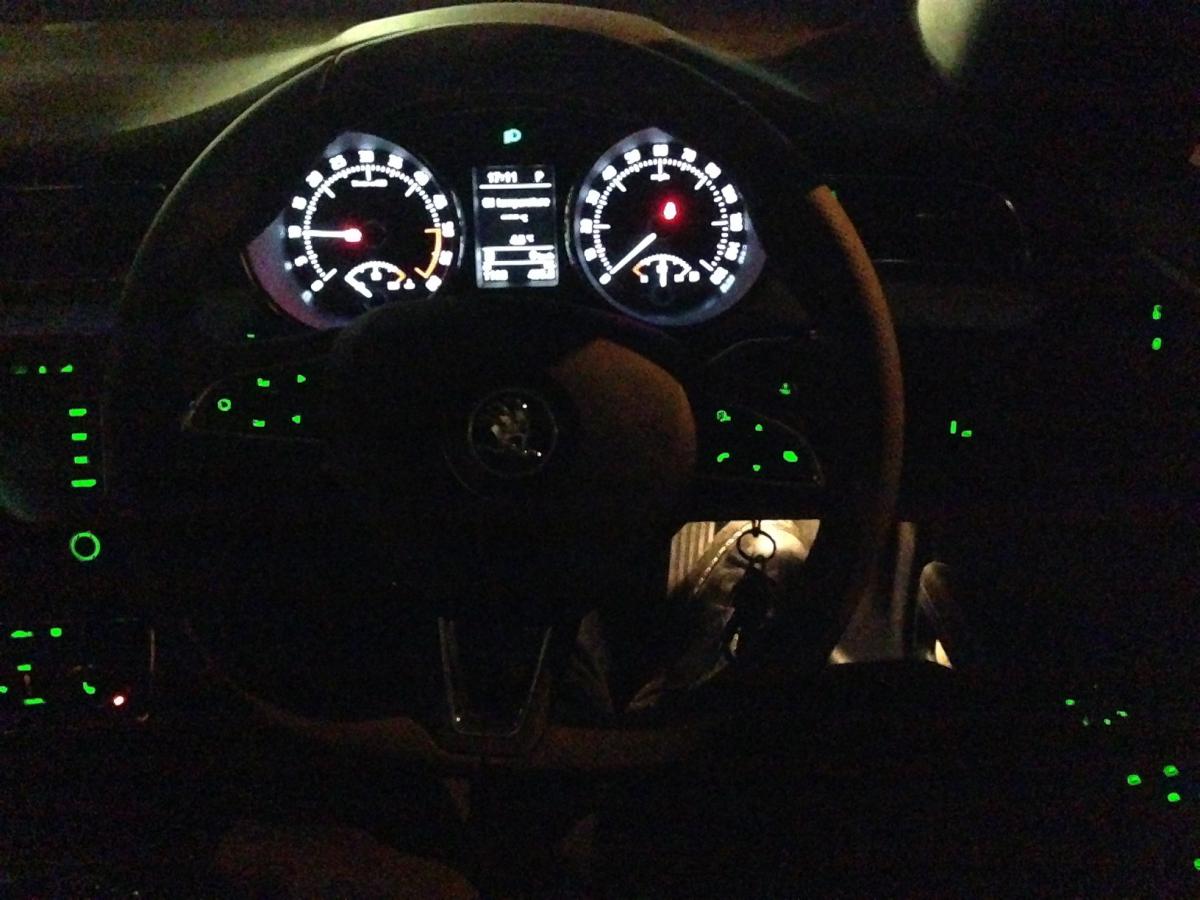

Steering Wheel Swap
Decided to get the best from the DSG I needed a Steering Wheel with paddles, so bought this...
http://skodadop.com/en/fabia-ii/interer-fabia-ii/multirul-s-lepestkami-shkoda-oktaviya-iii-rs-s-krasnym-shvom-facelifting.html
Fitted in about 15 minutes, after leaving for an hour with battery disconnected.
All mutifunctions work fine, just need someone with VCDS to get work some magic to get the DSG to recognizethe paddles now?
Well pleased so far!!!!!
There will be a Multifunction Steering Wheel for sale, complete with Airbag.

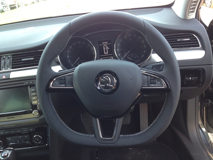

No a Skoda one which comes complete with airbag and wiring etc, its from a company called, cars-equipment.com unfortunately i cannot upload a photo but its a flat bottomed silver stitched 3 spoke with multifunction and paddles, My parts manager found it and emailed them to ask if it would fit a 2014 superb and they said yes so we ordered it up so cant wait.
Edited by sherlocks VRS
Sounds smashing. You will need to get some photos up when fitted...
Here is my new wheel, fitted and coded and all working
Looks splendid!

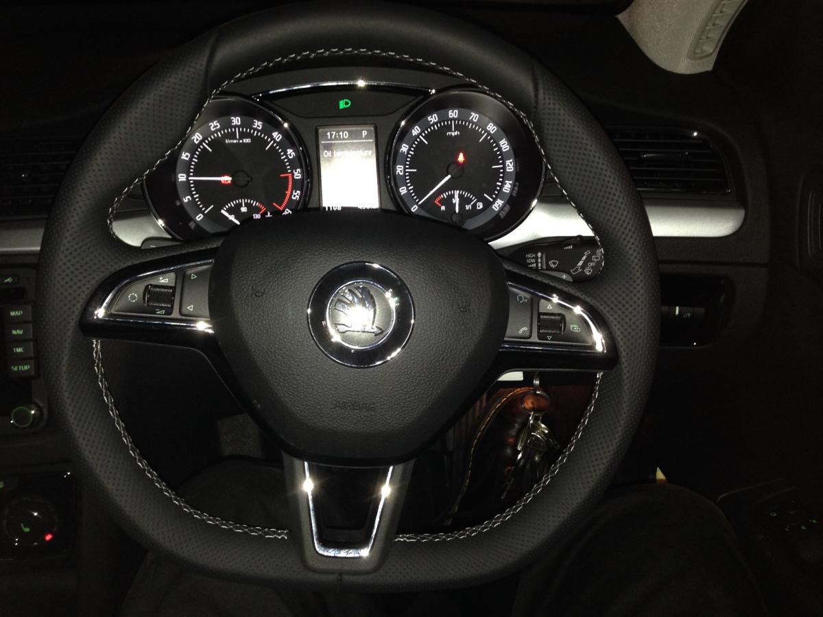

Well I bit the bullet and order one of theses http://cgi.ebay.com.au/ws/eBayISAPI.dll?ViewItem&item=262625067200#ht_500wt_1414 and fitted it.
I went to Controller 16, Byte 1 and ticked Bit 4.
Went for  a quick bolt around the block and the paddles work wonderfully......however, none of the other buttons work now....no volume control, no voice control, no MFD selections etc... basically my MFSW is no longer a MFSW!!  :wall:  :wall:  :wall:
BTW.... before I purchased I asked the seller if it would fit before I purchased and was advised google was my friend!!  I found another online seller (can't recall which one now!!) and they said the wheel would fit as well as the original airbag... but I didn't ask if all functions would work!!
I am hoping one of the Coding Doctors can assist with a cure??
Edited by crankoz
Got an autoscan? It might have the wrong buttons fitted, the part number for them should be in an autoscan :)
