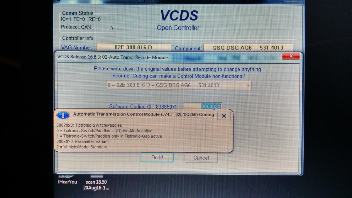

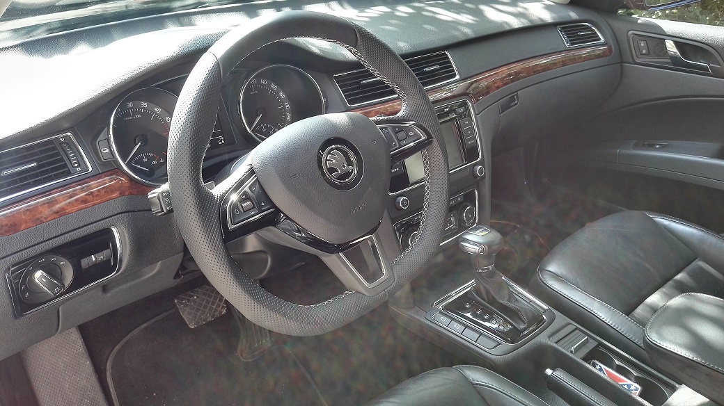

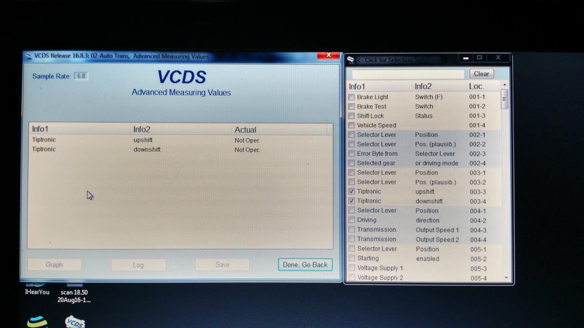

Steering Wheel Swap
Thanks langers2k...never thought the buttons could be the issue....they're a simple ??swap...yeah

Looks good - first one I have seen in a Superb with the silver stitching. Seems to work well - matches a bit with all the chrome trim on the wheel, dash and shifter.
Thanks :)
That's what I had in mind, to match stitching with chrome! It was little bit strange to park with flat bottom steering wheel, but I've got used to it after one week. Very nice feeling, much better than ugly old 3 spoke one.

Well...I received the new buttons today and installed them ...no issues I thought! Now what happens is all multifunction buttons work BUT the paddles don't work! Checked VCDS and the correct option ticked...so as a test I unchecked the option saved and exited VCDS then reconnected VCDS deselected the option for tiptronic went for a short drive and no change....BUGGER!!
What can I check now?! Autoscan doesn't show errors either
The buttons ordered where 5EO 919 719 G WHS...
Update...
I have double checked settings in VCDS ... all correct.
Further searching found this video https://www.youtube.com/watch?v=OW_BZrnFihM that shows how to check to see if paddles are working before test drive by going to Advanced Measuring and testing the buttons.
Mine didn't show signs of working... see below screenshot
I also checked Auto Trans and there were options but I am not sure if I should change anything here??
Edited by crankoz

Sorry, hadn't noticed your reply.
Might be worth adding a new autoscan as your previous one didn't have tiptronic buttons enabled in 'Address 16: Steering wheel'. If it's still coded to 1002140000 then try 1012140000.
I had a quick look around and found a very similar Superb with DSG and these buttons installed on rosstech forums: http://forums.ross-tech.com/showthread.php?3391-Skoda-Superb-3T-2014-facelift-No-rear-DRL&p=34594&viewfull=1#post34594
Thanks langers
My Address 16: Steering wheel is coded to 1012140000 and looks identical to the example you provided.
Anyways....my latest Autoscan is here:-
That all looks good to me, everything appears correctly coded and from the measuring blocks it's seems to be expecting tiptronic shifters.
It might be worth posting the above autoscan on rosstech's forum as I'm really not sure what else could be wrong.

These flat bottomed wheels look lovely.
So, as a numptie, the Octavia 3 version steering wheels fit straight onto the splines of the Superb MK2 steering wheel column? And if I have all the buttons and paddles it should be a straight swap (air bag module too?).
Thanks in advance for the help....
Dave
Dave
Yes they do look the ducks guts Dave....
Splines are all the same from what I know and you can use your original airbag too...
