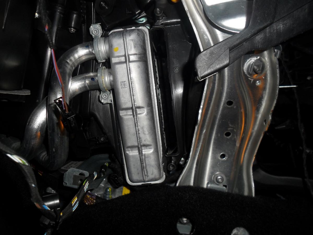

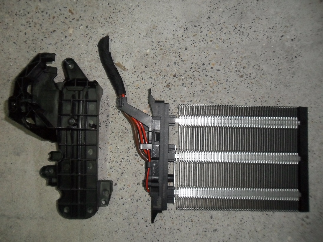

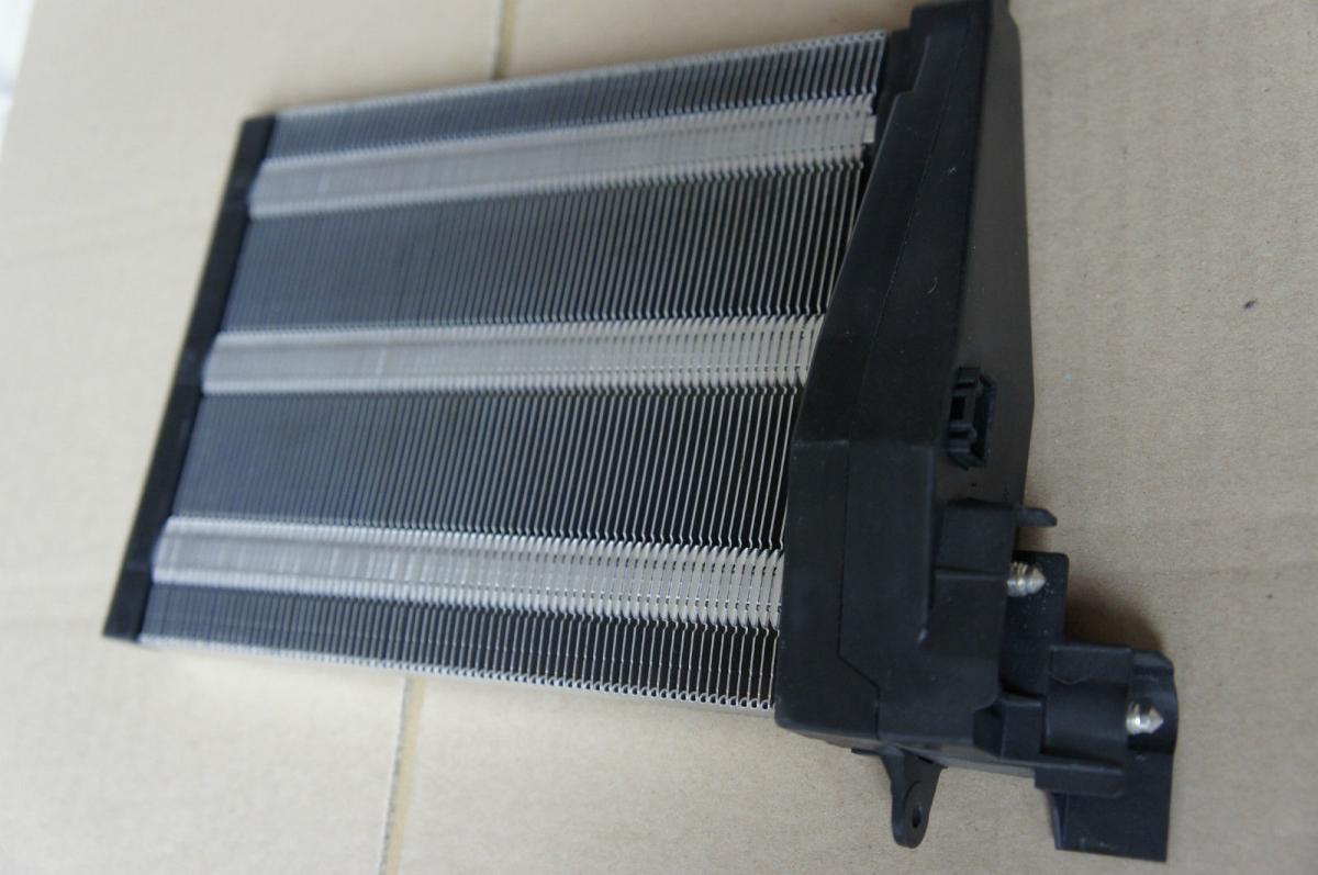

Just fitted one to mine, does make a difference. However, I think the one I fitted was faulty, was wired in correctly to battery and can-bus but didn't last long. I opened it up to look at the circuit board inside as there are 5 resistors that can give up. Looks like 2 of mine have done so, just need to find someone to solder on some more - bit too fiddly for me. In the mean time I fitted the more basic one through some relays and a switch - just need to remember to switch it off as the car warms up. Which one are you fitting to your car ? My car's a 2008 2.0 tdi elegance estate. Your car should have the climatronic set up so you could go for either.

When I bought my unit I got the small plug that plugs into the heater and some loom also so that I  could strip out the canbus wires which already have the correct colours, I then found these wires behind the climatronic unit, stripped back some insulation and soldered the new wires to them. I then got in touch with mikeholroyd from Whitby who was very helpful installing it using a vagcom and doing a test so that we knew it worked.

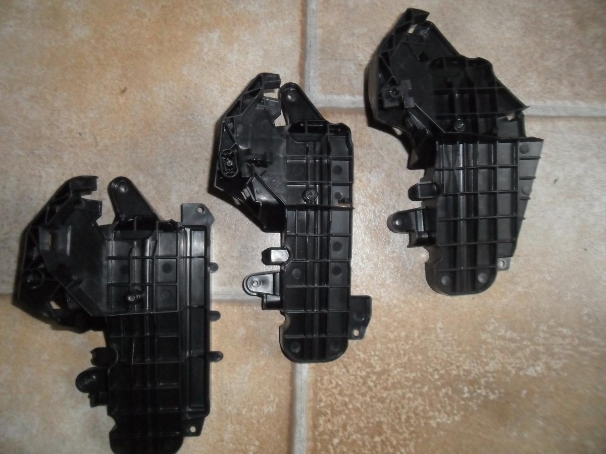

Did you get the cover with yours as there are different covers for either no heater, a basic heater or the climatronic one.

I'm not sure on the 2010 models, it will depend on the heater box that is installed. The set up I used was found in vw golfs and passats around the 2008 era. It fitted into a slot just in front of the heater matrix and was controlled either through relays or electronically through the canbus fitted to models with climatronic. Depending on the one fitted there was different covers to match as in the photo's.
