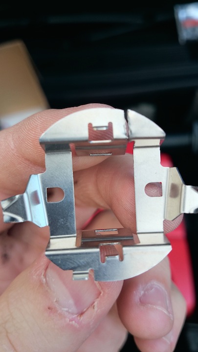

http://www.mytreg.com/uploads/1280908113/gallery_5373_28_1962841.jpg
That's how i cut my original lamp holder, and mine was loose and trying to get it to twist and lock took time but it did go, and touch wood haven't had any problems with the lamp falling from it.
I was trying to cut it earlier but nothing would cut through it lol, i also tried filing it..what did you use?

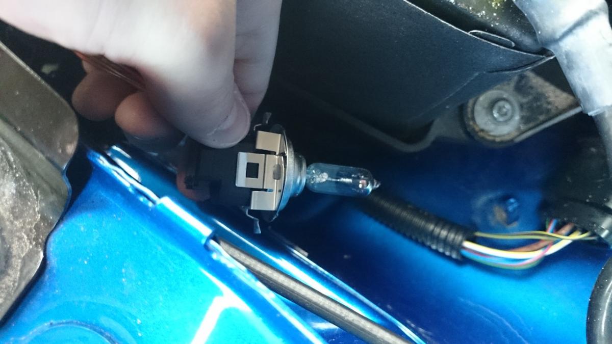

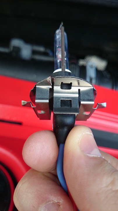

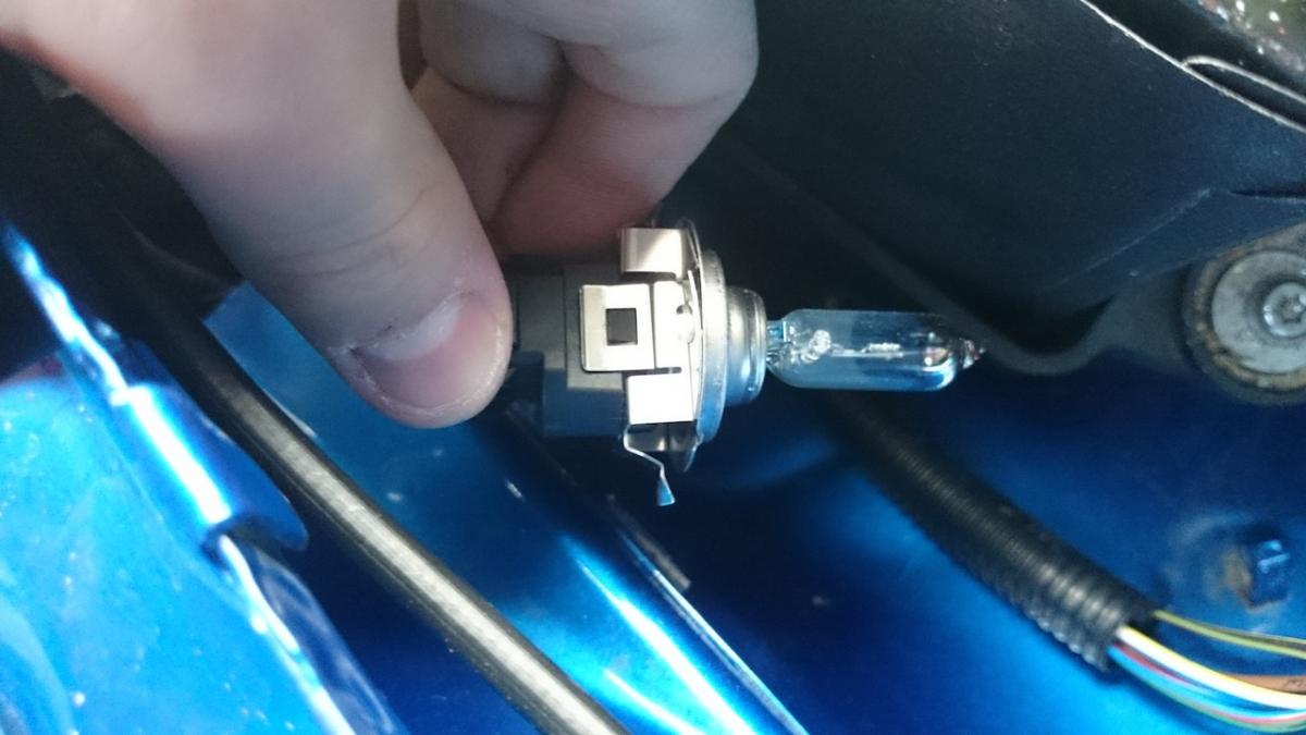

I don't know if these will be of any use?
I;ve just returned my car to halogens and it took literally no more than 15 minutes, apart from the 25 minute journey to TPS to get some new rubber seals for the lamp unit.

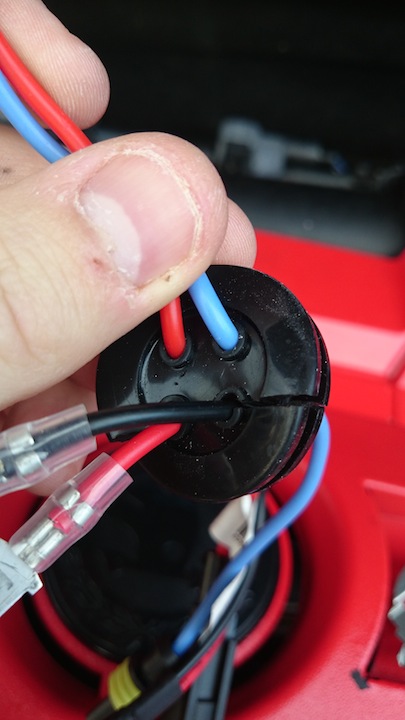

Do you have a pic of how the ballast all plugs together?
I know hes struggling with that too cos he PM'd me lol
Top man. Im sure thatll help him lots!
Give me two minutes and i'll lay it out on the table
Cheers! Saves me going under my bonnet in the ****ing rain to get a pic that wont be as clear haha.
