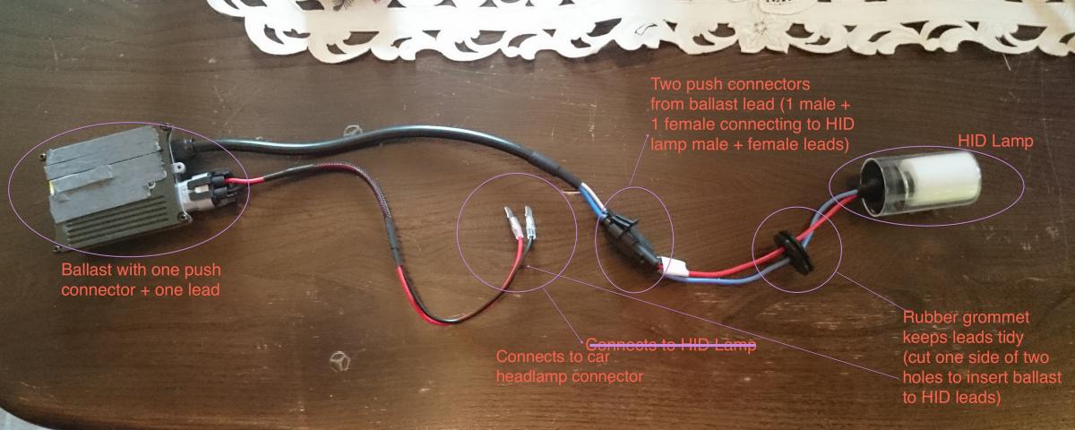

Apologies for the picture c*ck up!
Hope this helps and makes some sort of sense.
The two leads from the ballast unit with crimped connectors connects directly into the headlamp connector block on the cars wiring.
Much better than id of been able to do! Nice one!
Worth noting Ang. Some of the kits have an extra box in the wires, but it just plugs into the ballast (quite impossible to plug em in wrong).

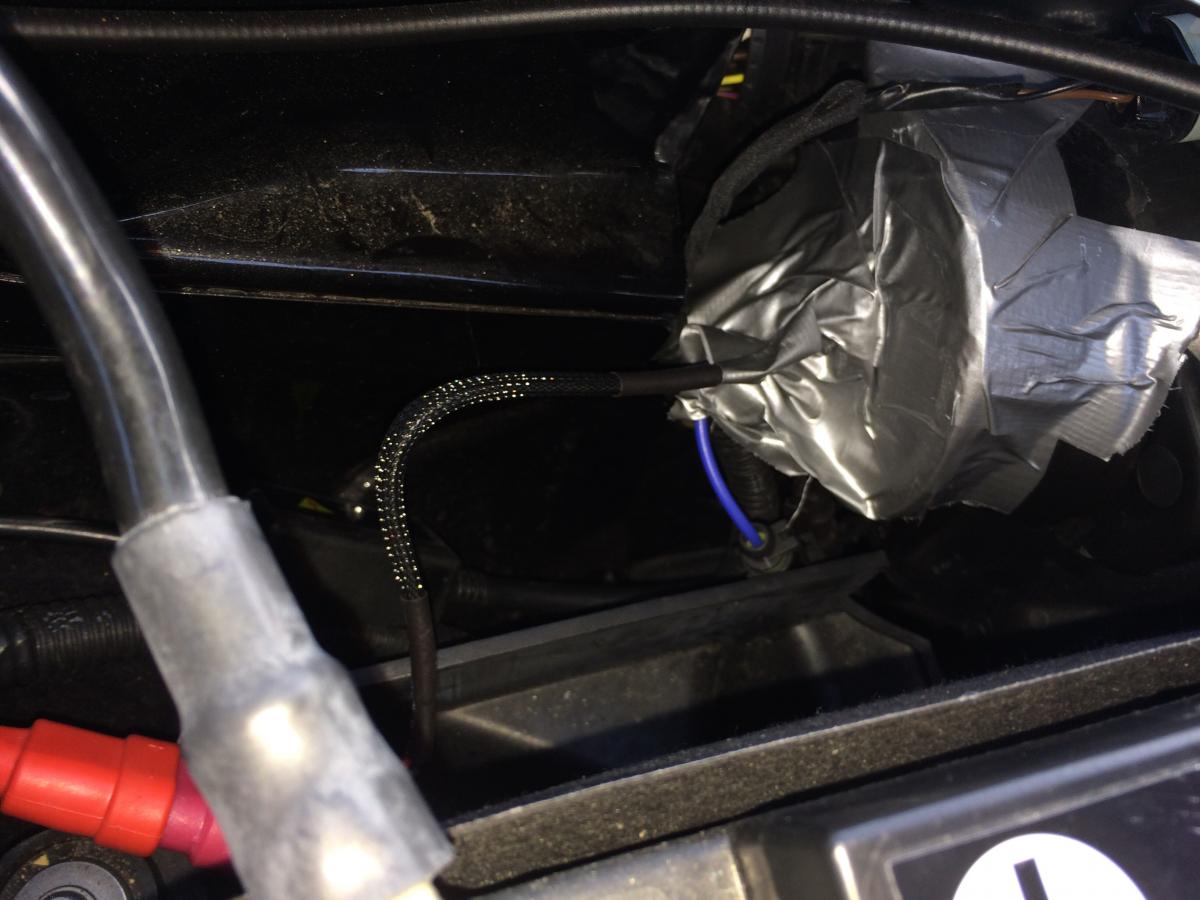

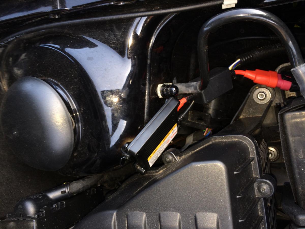

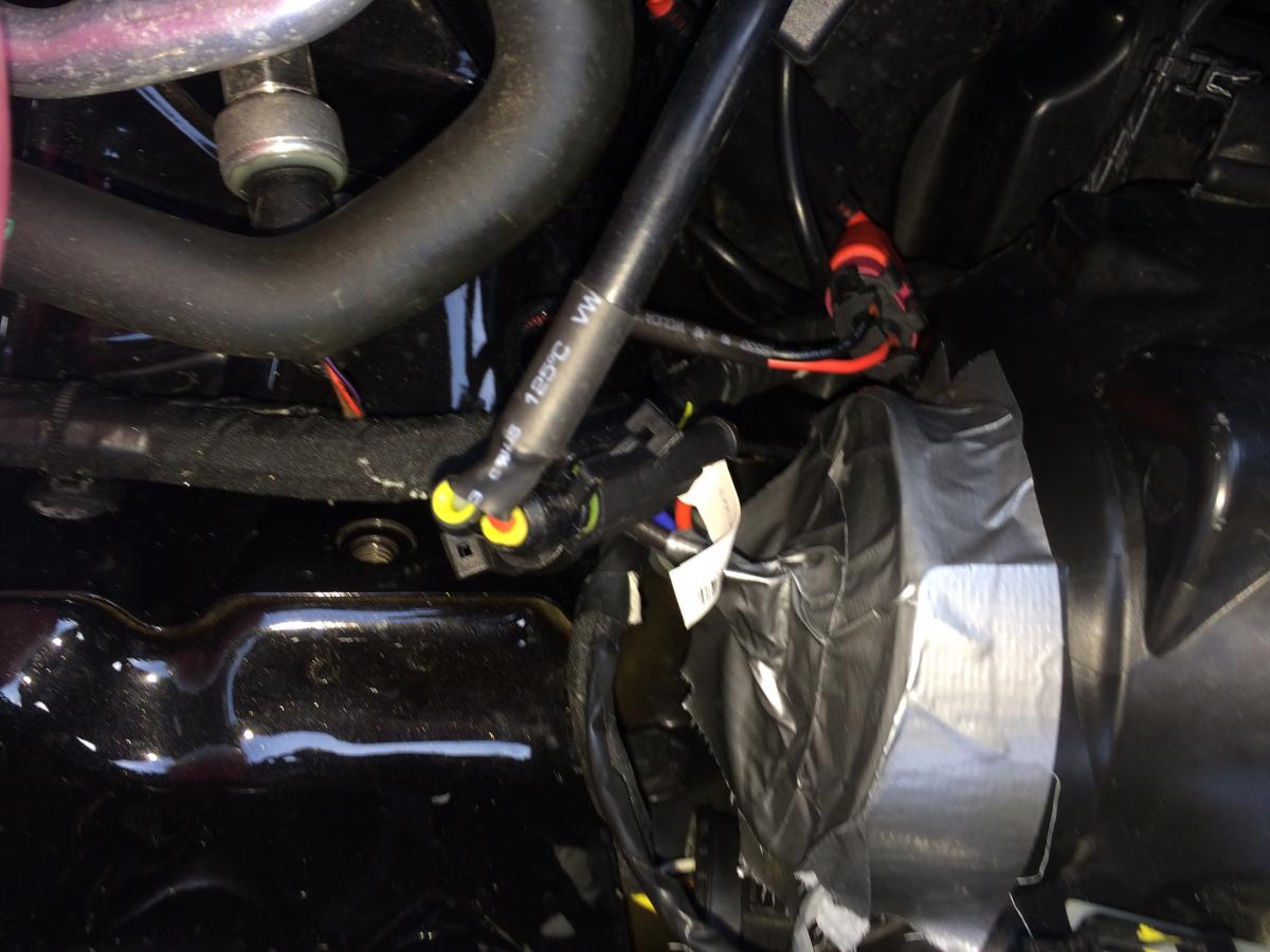

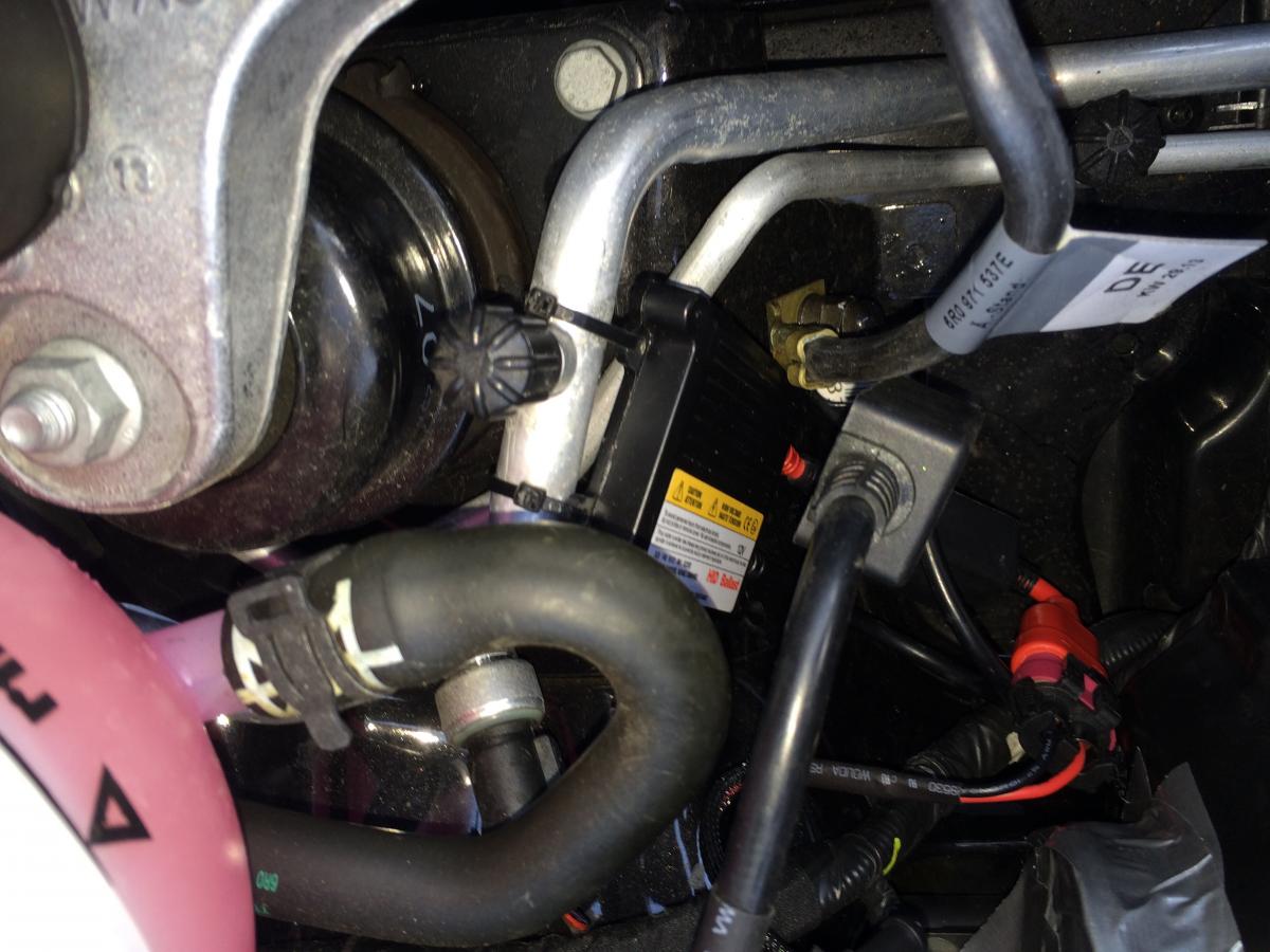

I done it!! Haha took me a while but i managed to cut the holders like some of you suggested and after another 20min struggle they finally fit into the headlight. I had to ducktape the rubber covers as i made a mess when trying to cut it to size so it should be fine, randomly zip tied the ballasts and the lights work but i need it to get dark, pics below and more to come when it gets dark, cheers for all the help guys

I taped my rubber covers as the grommets wouldn't fit into my 20mm hole i had to just put a few slices in... thankfully had no condensation!
Hope you're happy with the result when it gets dark! You'll never go back  :thumbup:

Do you think they will get wet then or get condensation? I put quite a few layers of ducktape on..

Mine never did and you have put more tape on than I had on mine, So I wouldn't worry!
My last car used to suffer a bit with condensation but nothing the hairdryer couldn't sort out  :D

Well done on getting the HID's sorted, I'd maybe get some new rubber covers though to make it look tidier
The rubber covers are only about £7 from a dealer.
I bought 4 last year as spares (:
