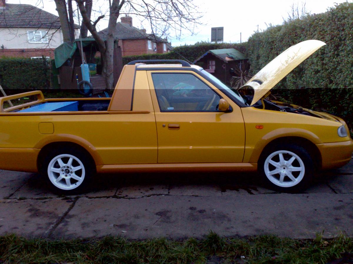

T735BHP has been undoubtably the best muli purpose bus ever knocking up 70k in it!    I have done some fantastic work over the years, 54k engine and box in 2011 due to the original being sick for running without a thermostat for years (buggered the rings up). Removed all the wings all the plastics and fully tackled all the inherent tin worm (these were made to rot) it now has rear arches off front wings grafted in very well I may add and it is booked in the paint shop in February. All the inner wings and front crossmember has been beefed up as well as the folded sill seams and jacking points.
To the point now! Took her out the other day and noticed a noise on almost full lock like a fubared cv but does a different noise for both locks?
Son reckoned it was coming from the final drive not the outers.
Set off for Lynemouth Power Station bright and early Thursday the peril settled down nicely on the A1 knocking on at her usual pace then I felt a sharp pull to the left on the wheel, slowed down few more miles started again more violently, slowed down more few more miles tried to put us in the ditch! Pulled over inspected everything possible all fine and dandy and well kept, however slight play noted in the inner cvs as they enter the box? (Not done 10k since all driveshafts, gearbox seals were overhauled in spring)  Set off nice and steady not long before we were walking along cos the steering was all bloody over. RAC time!
Got home run it on axle stands nowt except some meshing noises evident on final drive runs up and down our road sweet as except for the weird noise on full lock both ways.
I suspect the gearbox? Can anyone shed some light on this or has had simliar?

Finally fitted driveshafts and fully tested them. Verdict is it was the driveshafts! The old girl drives spot on so far managed to do around 30 miles under various loads and road surfaces.
The fully assembled driveshafts from Europarts seem quite good but time will tell. For the price I cannot complain at all.
