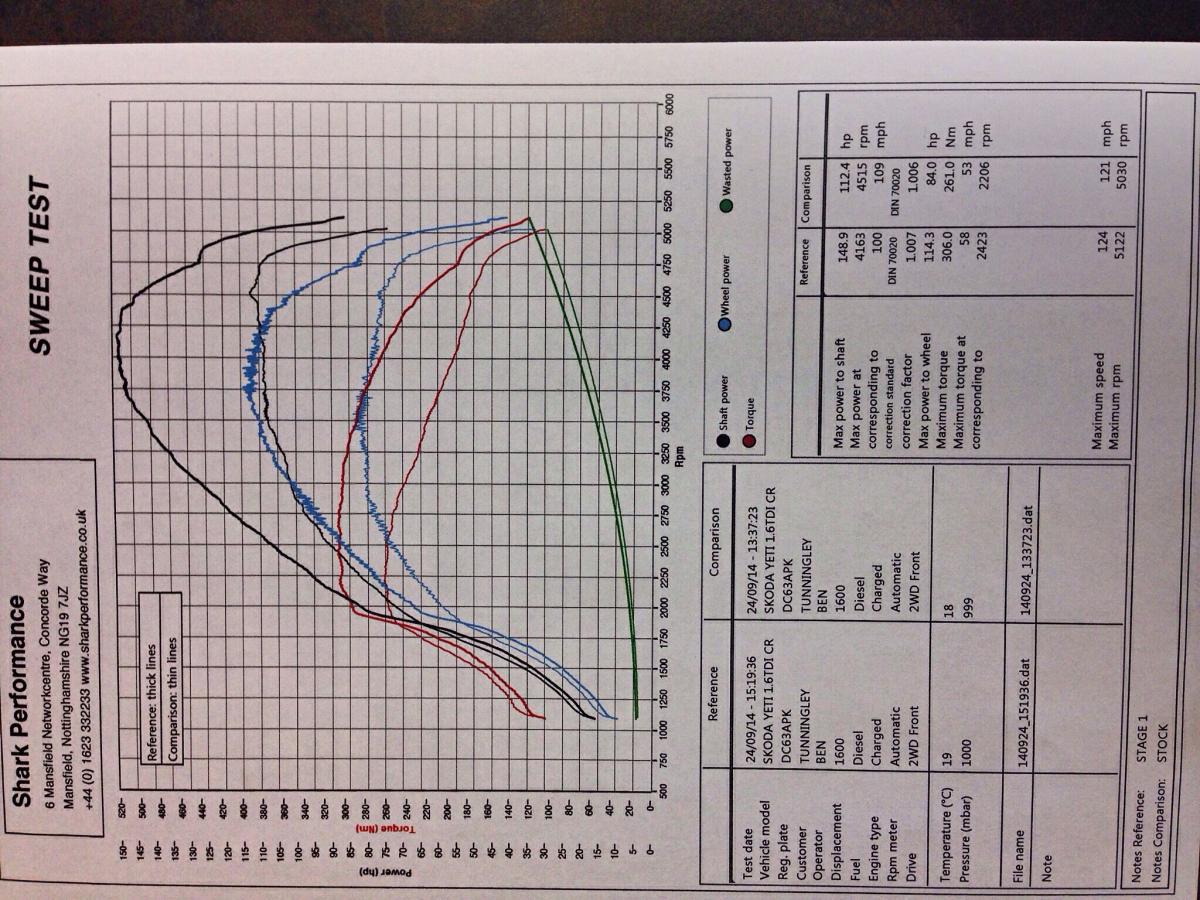

Here's the map from Shark Performance:

The vRS petrol engine might also be speed limited, especially in view of its less than stellar gearbox durability (7 speed DSG).    Note also that the vRS has actually 6% higher air drag than the non-vRS version (0.34 vs 0.32, refer to Fabia brochure), and that drag alone loses ~10bhp in competition to the diesel one at close to top speed. And the 5mph difference is still quite a lot in power, assuming at this point it's mostly air drag, it's about 20bhp. So 150bhp as shown on a sample map above would be enough.    Finally, my Octavia Mk1 with ~138bhp (remapped TDI110 mated to 6-speed drivetrain from a 130PD engine) was able to hit top speed of ~133mph or so (GPS).   Fabia 2 drivetrain is very similar (many parts migrated from Mk1), drag coefficient is slightly higher (0.32 vs Mk1 Octy 0.31), but frontal area lower, and mass also lower.

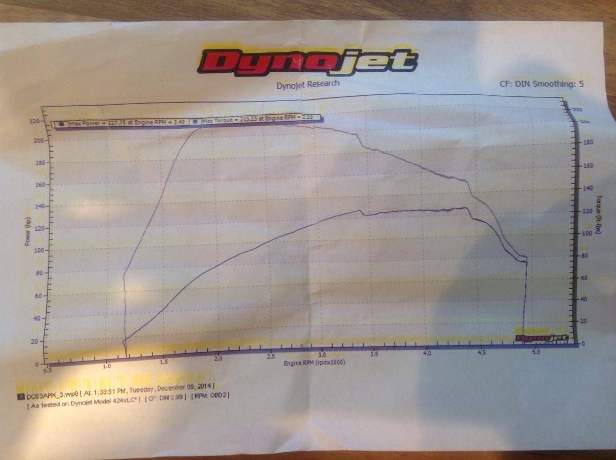

Been a long time since I've last posted on this. But this weekend had the chance to get on a dyno. Results from a Superchips remap...
142.5hp
261.1ft lbs
142.5hp
That's definitely one of the higher gains I've seen for this engine in the Fabia I do know the yetis for instance can go higher. Unless your car wasn't standard?
How does it drive? And how much did you pay?
Car was standard, has a panel filter fitted and a remap that's it. Drives really well, every gear still has abit of pull very impressed for a 1.6. Went to Wiltshire Superchips and paid £440 for a bluefin too so I can install standard map when I want.
Very good power from just a map
nice curve too, lots of power over a wide range :)
That's what the guy running the dyno said, happy with it for a 1.6. It isn't rapid but can go when it needs to.

Good result, intercooler upgrade would put you up at 150bhp, beyond that it gets expensive ;)
