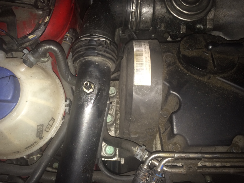

Unfortunately I'm a bit of a noob when it comes to the mechanics of the car. But I want to know if anyone knows why I seem to have a valve coming out of a pipe leading from my egr valve. Any help on this matter to enlighten me would be appreciated. Hopefully the picture helps people out. Will be willing to take more if anyone needs it.
it looks aftermarket to me, perhaps the car had an oil catch can fitted in the past.
Fitting for a boost gauge?
I'd have said this too!!
Yep, 100% for a boost gauge.
Is it ok as it is then it should it be capped off?

Cap it off, otherwise it will be leaking boost.
Does sound like the clutch is toast unfortunately.
It should be blanked off.

That spigot should be capped off. Otherwise it's leaking boosted air.

I'd guess your car has been remapped too, seeing as the previous owner had a boost gauge fitted.

That top boost pipe going into your EGR isn't pushed in properly either. Might want to check clip's on properly or the lugs aren't worn.

Top pipe to egr looks like its about to pop off aswell
I thought my clutch was slipping as mine was doing the exact same thing, then my boost pipe popped off, I then repaired & since its not happened (fingers crossed!) I put mine down to a boost leak?
Well I hope this is it then. As I really can't afford a new clutch and everyone has said that my boost pipe looks like it's lose. And to say that surely if have felt something gradually happening and not just an all of a sudden change if it was my clutch.
I'll be having a look at my boost pipe tomorrow so I'll let you know. Fingers crossed
Me and a mate have just spent the last hour now looking at my boost pipe and it seems that the pipe itself feels very lose. Takes minimal effort to move it slightly.
However once we had pushed it back into place and took it out the problem didn't occur in 3rd like before but then did in 4th. Pulled over and the pipe was loose again.
So is there a clip I could get to see if it will hold it shut or should I get a new pipe as I really wanna check all options before admitting it's the clutch. [emoji6]
