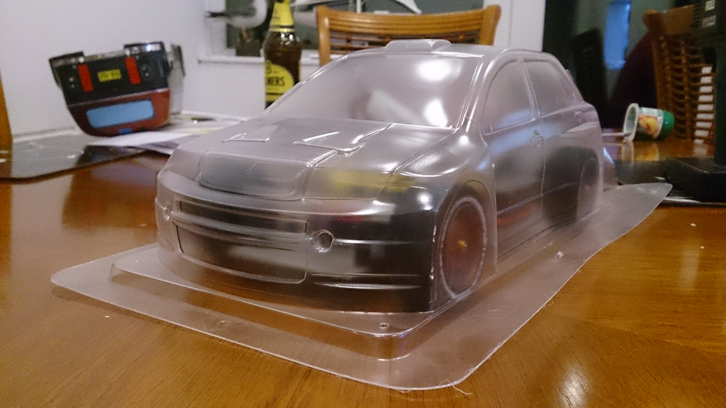

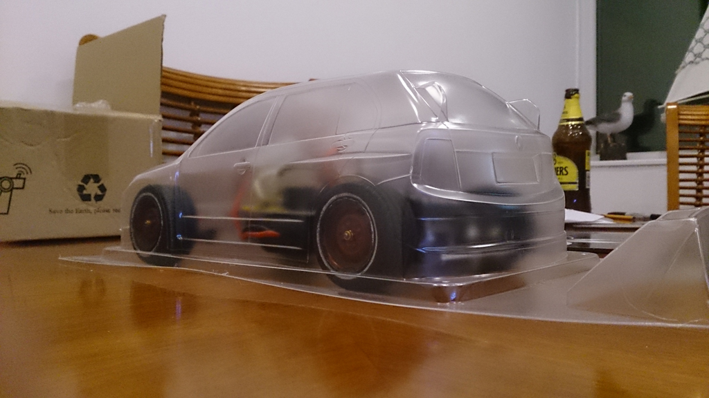

Took some pics of the shell on my chassis - the chassis needs lengthening by 7mm to sit right, as the wheelbase is 210mm vs the mardave v12's 203mm. I need to re-drill the mounts to move but shouldn't be an issue!
I've also got a can of black magic from halfords, so will be painting imminently (if the workshop is warm enough, might even get a chance this weekend!)
Couple of pictures of the "mock fitting" on the chassis before painting.
looks a good fit - what are you going to use to lengthen the chassis?

The chassis is a sheet of aluminium/steel with the wishbones mounted to it with bolts - I can redrill the mounts 7mm forward and re-bolt (there is ~20mm spare at the front!) Will need adjustment of the track rods but do-able.
The only worry is actually the track width. The rear will be a bit narrow so may have to be creative with some form of spacing/chopping to make it a usable model. However I may just use some 18mm ply and make this purely a "shelf beauty" if I can't adjust enough.
My Mardave chassis doesn't have that much spare at the front!
You can just about see in the photo above the wishbone mounted on the chassis and how it is set back.
I don't have bumpers in place on the chassis so this probably helps.
