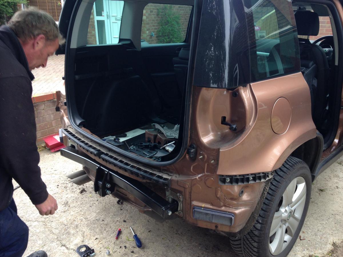

Did my tow bar last week, and definitely torx, you will need to replace the 7 screws back into the holes on the car, I also put some waxoyl on the threads of these screws and on the head, so hopefully won't rust or leak.
Getting a torque wrench into the space behind the wheel arch splash guards is possible without having to undo it, but a bit tight for space.
Loose fit all fixing bolts and then tighten each a little as you go..
Mine was a Towsure, and looked totally different to the one in the picture.
Getting the painted plastic upper bumper bolt panel ( below the light cluster) off, is a struggle if you want to avoid scratching it, I found it very easy once the light clusters were removed, as you could then see what you are doing.
