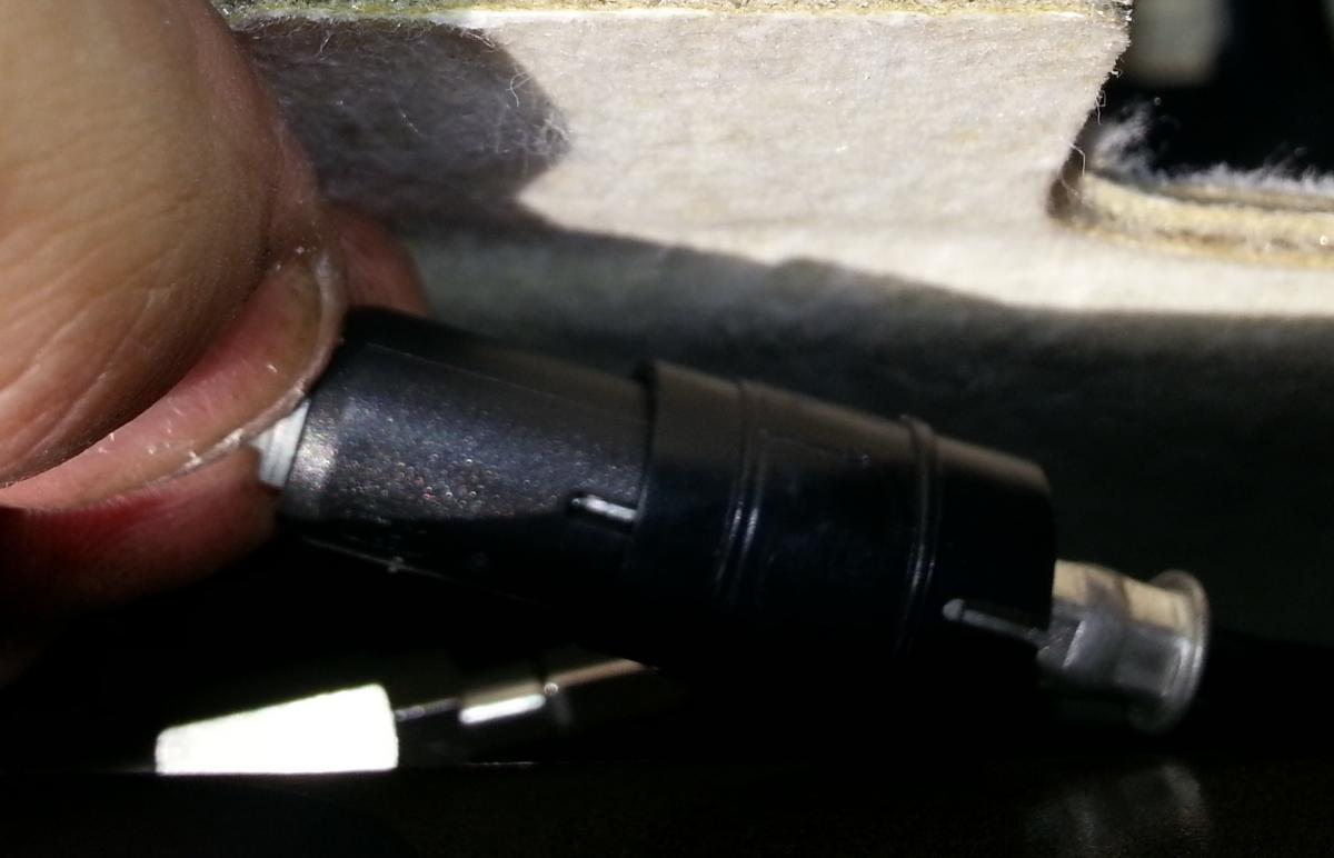

A little advise needed please:
I bought an aerial base and mast (6R0 035 501 D) for my DAB setup (see http://www.ebay.co.uk/itm/271685146748).  It works fine as a DAB and phone mast but when I have tried to fit it properly, I have hit a problem with integrating it into the existing loom.
Basically the old aerial has a GPS connection and two radio connections, but the new aerial has just two FAKRA connections, one for GPS and one for AM/FM.
I can see which of the old connections is the GPS and apart from changing the connector housing (from the old aerial presumably?) that bit should be easy. However, the FM radio connections confuse me.  I was expecting just one connection as per the FAKRA connection on the aerial base (I thought the second on the back of the Columbus would be linked to the aerial I have "painted" on the rear side window).  So my first question is why have I got two FM radio connections if I have got the rear side window aerial?  It is also not clear if to me if I can exchange the housing for these two connections (is it SMB or RAKU perhaps), to the new aerial instead of the FAKRA connector, so can anyone advise looking at the attached photo please?
Thanks in advance
Adam
Turns out what I thought was a second FM aerial was in fact something to do with the old cell phone preparation (pre cursor to BT) that was fitted but never used in my car.
