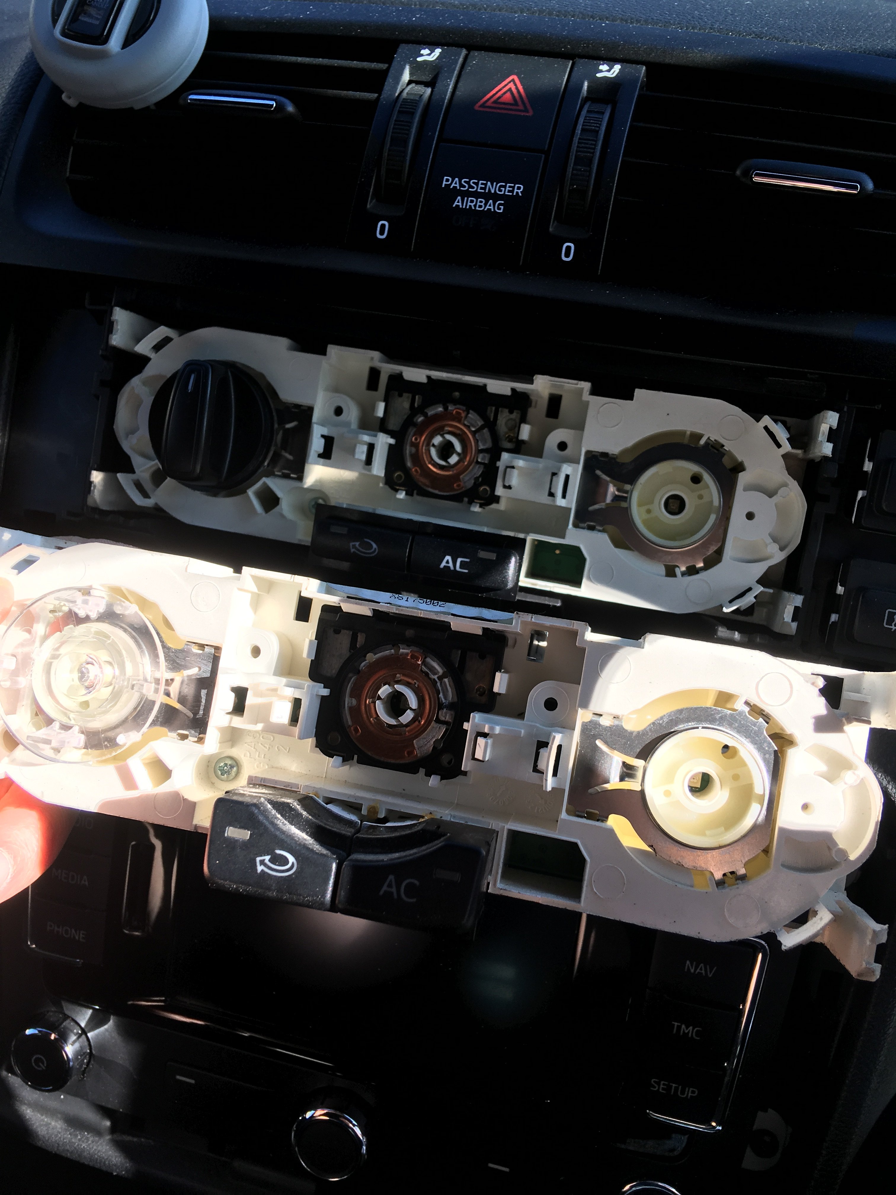

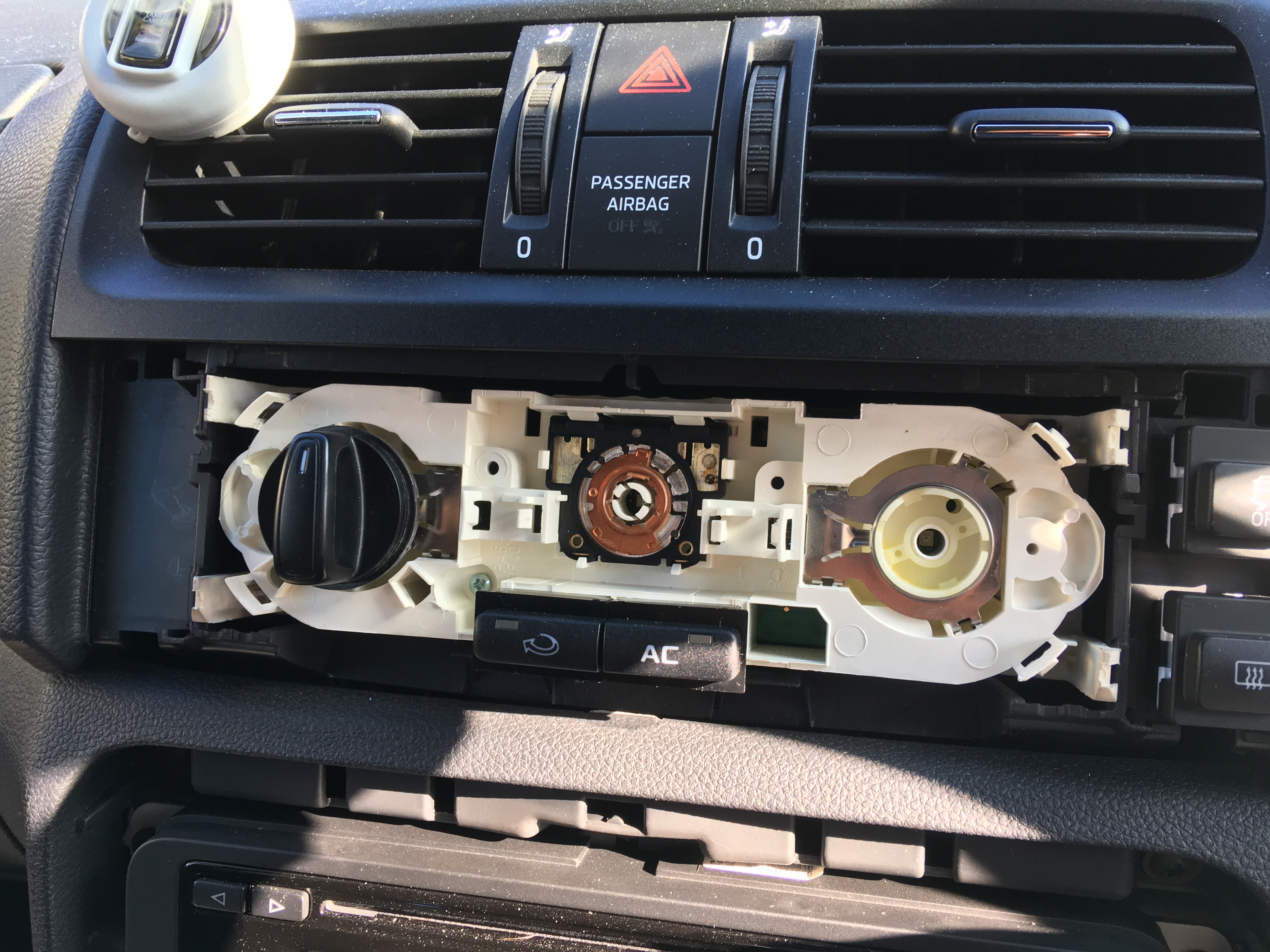

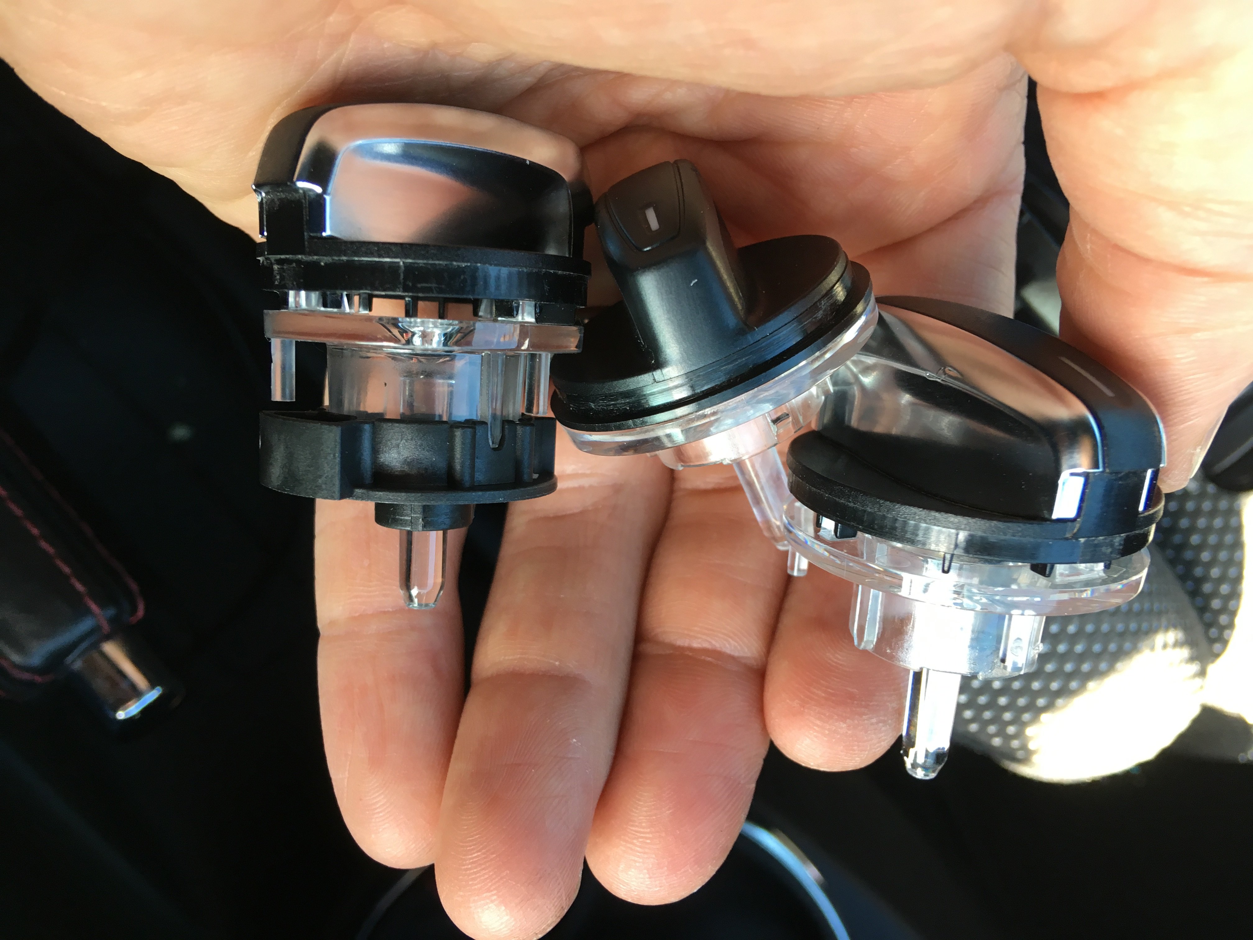

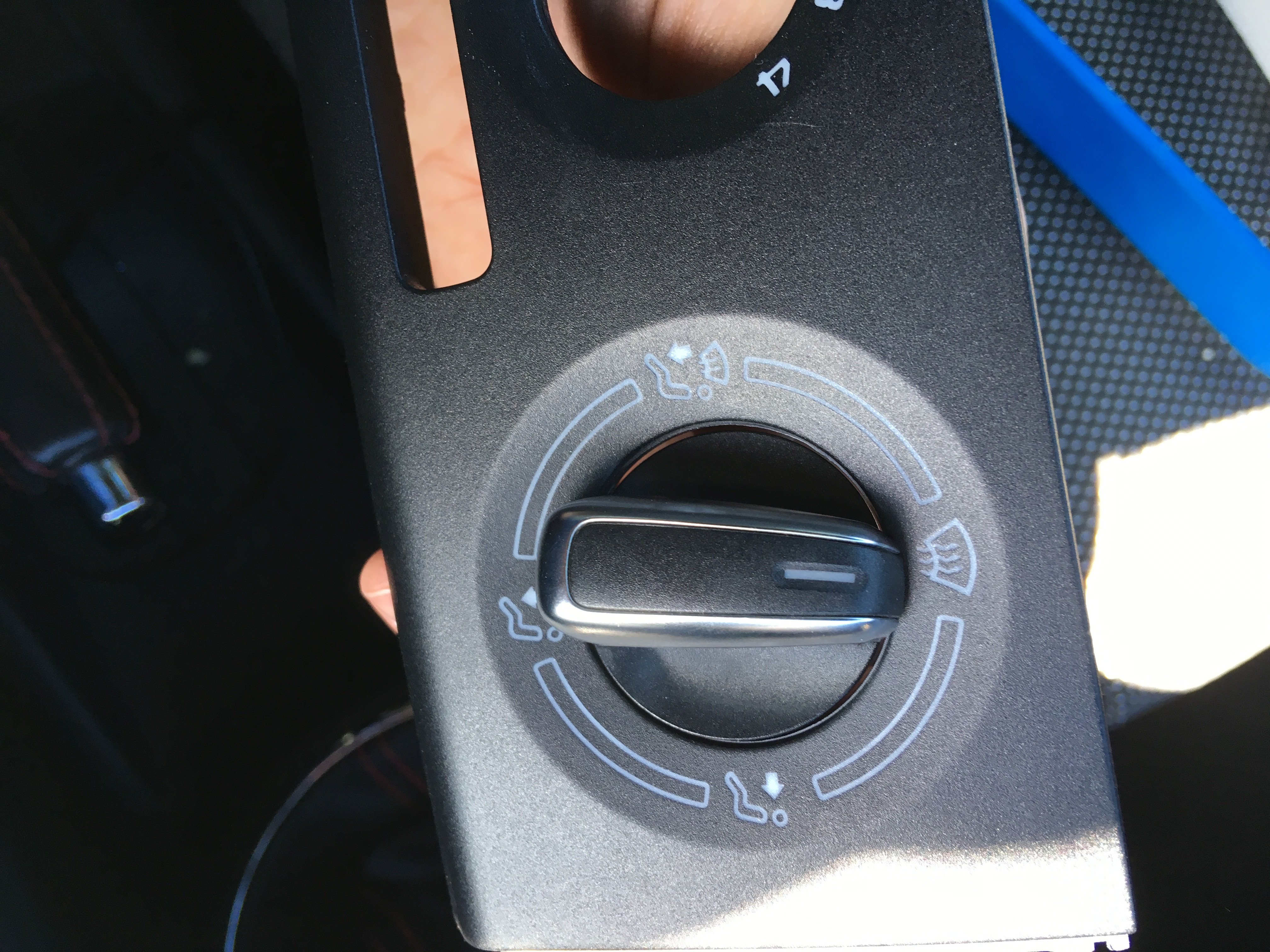

Ok I had a proper go.
the outer Fabia (temp and distribution) knobs are the same size as the VAG centre fan knob, they’re also on completely different mountings so it’s a real sandpaper and dremil job to get them to fit.  The white gubbins bit is identical, so it’s all to do with the faceplate.
only way I can see this working nicely is to have 3 VW heater fans and use two switches for the outers, then very carefully sand down the 3rd one to size for the centre, or sand down all 3 knobs and make the ring holes larger on the Skoda face plate.  Or, spray them!
luckily I got my polo one for £15 posted off eBay, think I will go the chrome spray route, shame it can’t easily be done.
