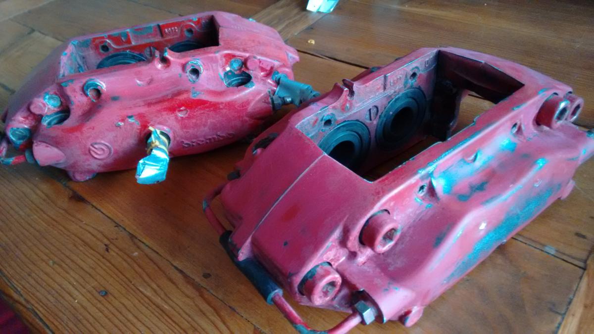

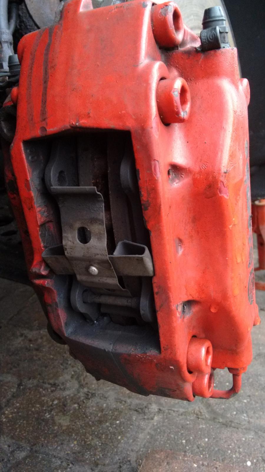

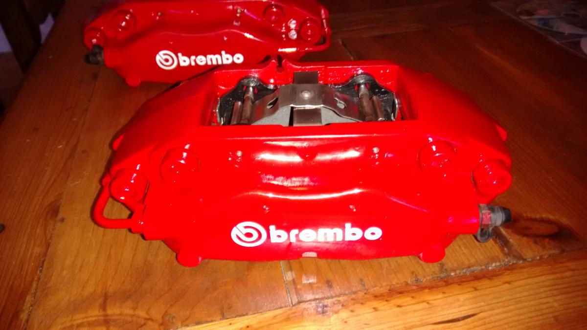

Brakes look awesome - my Brembo's are currently in pieces waiting to be powdercoated green! :)    Did you buy new pins and the centre retaining piece, or just tidy them up?
Alex - just cleaned up then polished with autosol. Springs and slider plates came up a treat. Pins still a bit discoloured but not worth buying new unless you are even more anal than me!
Pretty sure the pull is gone, though I haven't really given it stick yet as I was a bit worried about blowing the boost hose again. I've used the superpro anti-lift bush.
Nice one cheers for that. Thought as much. I did the same with my bike calipers a couple of years back when I rebuilt them.

Nice one on the calipers, I had wanted to get them refurbed before fitting but wanted them on before the last combe day. Would have been better with the 312mm on the last day after all that effort! Ohh well.

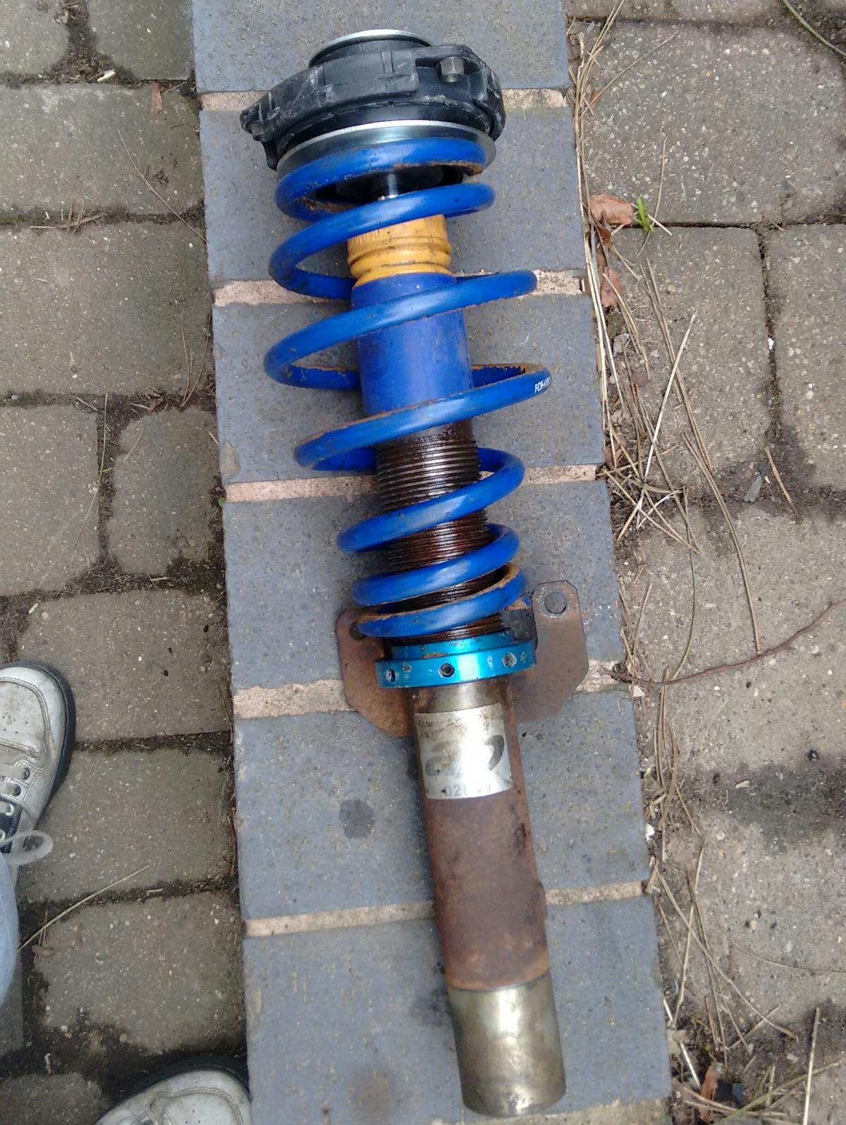

Fitted new Meyle top mounts and bearings this weekend.

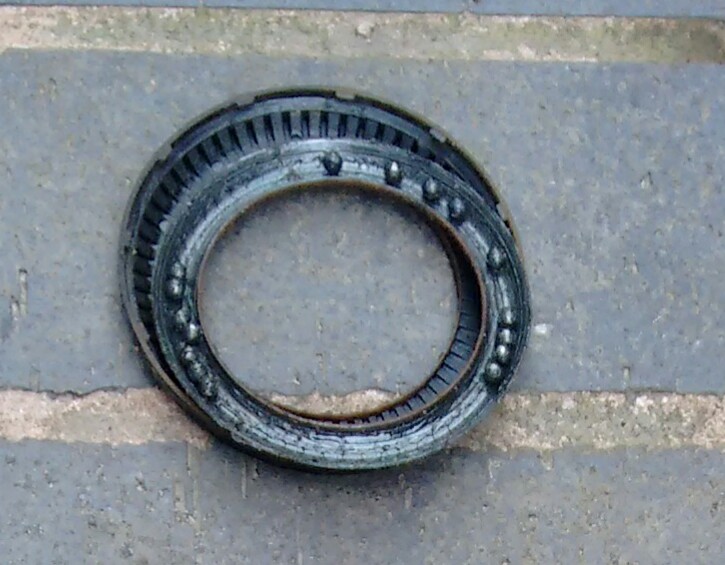

Had a crunching noise on full lock, and steering a bit notchy at times. Top mounts were the only suspension bits I'd not replaced so figured it was likely them. Relieved to see the bearings fall to pieces as I took the struts off.
Not that bad a job in the end, though one of the captive nuts on a top mount span, so had to grind it off.
Struts properly cleaned up, regreased threads and wound up even more! All level now, crunching gone, suspension feels great. Get it aligned this week, then enjoy driving not fettling!
Is ready for an oil and filter change though.
Are you running it on the lowest setting? Only looks like theirs about an inch of suspension travel before it hits the bump stop. :(
No, that's with the adjuster all the way down to make compressing the strut easy when fitting.
Read a few 'how to' guides and bought spring compressors on the strength of them, then found I could get the same effect on the coilies by winding the adjuster down: nice when a plan works!

What would have caused the top mount bearings to fall apart? Those were all brand spanking new when I fitted those APs, they weren't cheap ones either! Have you re-used the ibiza bump stops at the rear?
Those captive nuts are the biggest PITA ever, did you over-tighten it when you re-fitted the bolt after removing to removing the seat sport strut brace?
Guess just poor quality bearings. When I released the spring tension there were ball bearings dropping everywhere, both sides the same. Pic below. Didn't have the rears apart, but bump stops on the front looked brand new still, and front shocks in good condition and still working well.

In other news I've bought some secondhand KW v3 coilovers off eBay, had to buy new rear adjusters (which were missing) and a rear spring cup (damaged). Changing them went fairly smoothly except one of front dust covers was cracked, did a pikey gaffa tape repair which has only lasted one drive, so I've got to take the whole strut out again to change it :-( 'Review' to follow after alignment.
