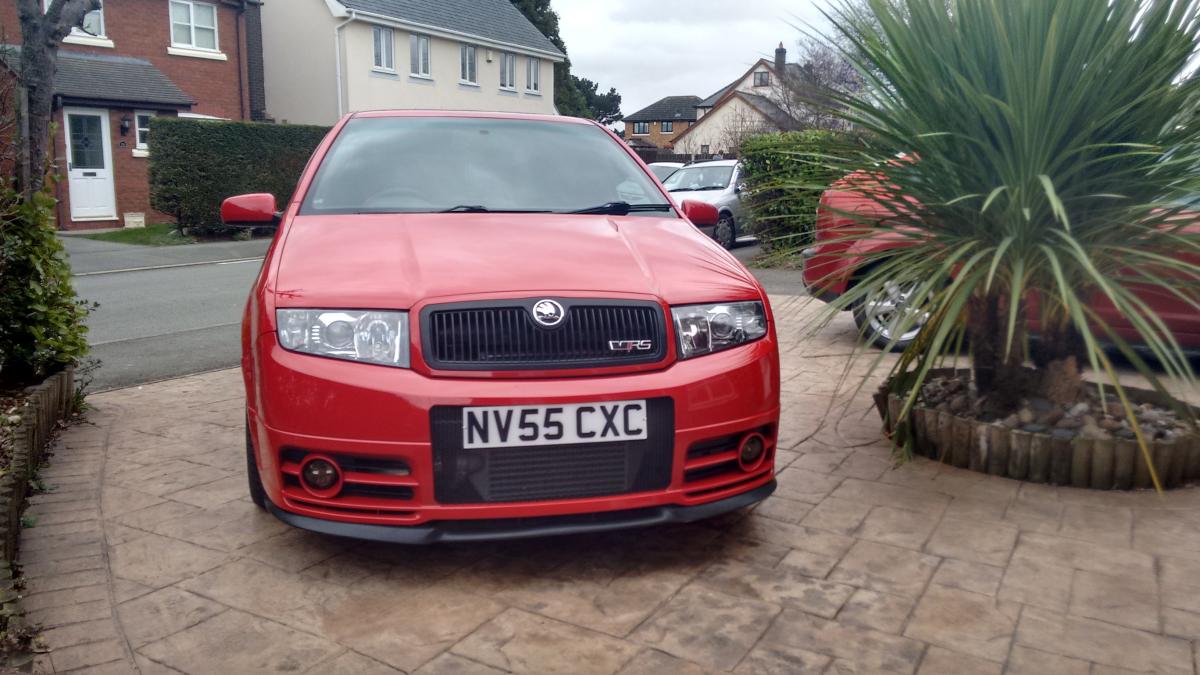

Dave's adopted mk1 VRS (aka Dan's GTB1756)
Looked at a few different Fabias, very nearly bought Terkin's VRS (sorry for mucking you about!), then Dan's came up for sale with loads of work done and i had to go have a look.

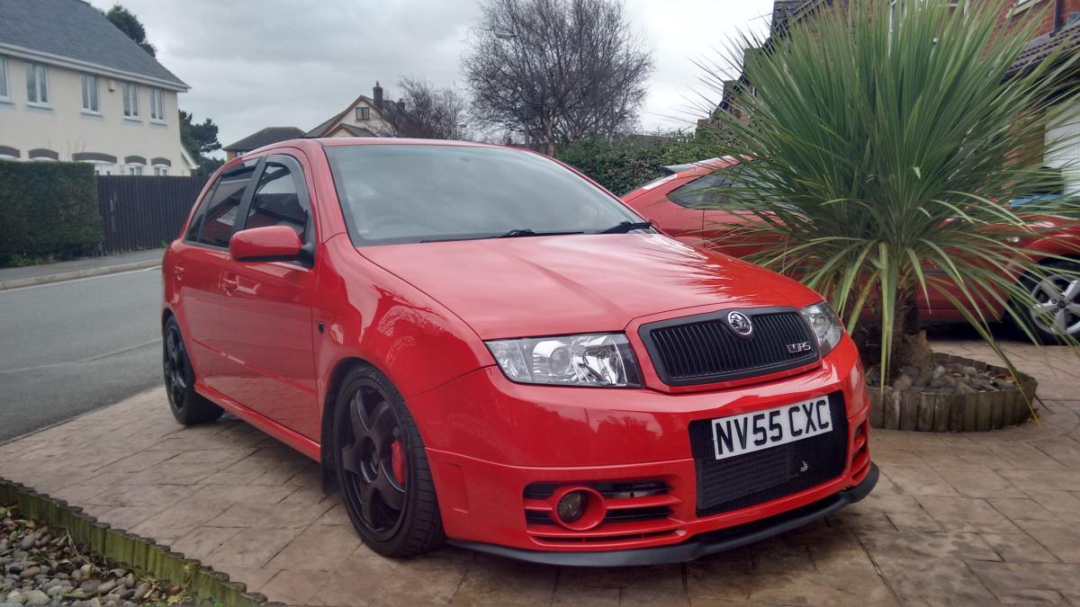

Lovely car and couldn't resist. Picked her up yesterday. Here she is nice and clean at Dan's
Adding in detail from Dan's original ad, to remind me what he did to it!

That photo really does it justice, what a beaut. Enjoy mate,
no issues bud it happens,glad it fell though as ive decided to keep it now :D
nice car man :thumbup:

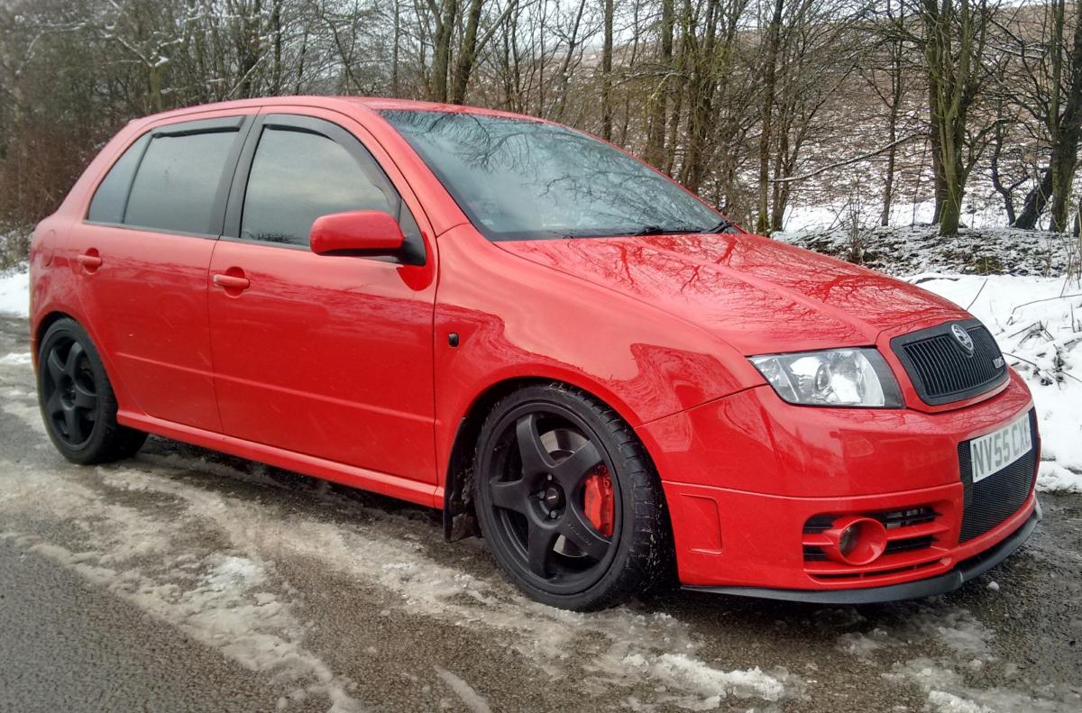

Another at Dan's before I get it dirty.

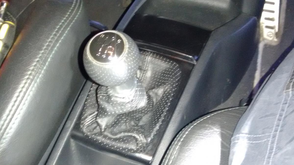

First mod, got to make it my own. Audi A3 S-line gearknob (on my Octy before).

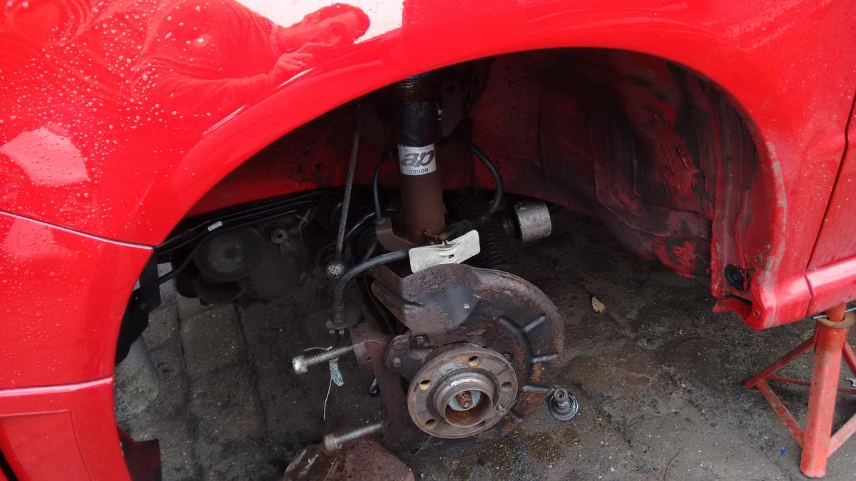

While it was jacked up I decided to do another couple of bits.. Got in a bit deep!
After nearly 2 weeks on axle stands it lives again!
Lot of time, but learnt a lot, enjoyed it in parts, and very happy with the result:
  • New track rods and ends fitted
  • New ball joints
  • Superpro rear console bush, front console bush and front ARB bush
  • Front arch liners fixed / bodged: bought some second-hand off here, turned up and only slightly better than my old ones, ended up cutting and rivetting them together to make one set of almighty franken-arches.
  • Standard airbox and filter.  Modded the bottom of the airbox to take Dan's cold air feed: worked a treat. Gone with a Bosch standard air filter: I'll keep checking it and see how it fairs.  I know some advise against it but I like to be different and the filtration hugely better.
  • New front genuine Brembo discs (cheapish off ebay, though kinda wish I'd gone for a grooved / dimpled set to match the rear) and Pagid pads (couldn't afford DS2500s)
  • Refurbed front calipers: what a ballache!  Someone had repainted the calipers in a really poor orangey/red finish.  Stripped back with paint stripper, sanded back, then resprayed with Japlac enamel paint (loved on one of the Audi forms: let's hope it lasts). Sandblast and powdercoat next time I attempt this! Full new seal kit while I was at it.  Then refitted and bled.
  • And boost hose back on: after reading a few comments about the Mikalors not providing even clamping force I've gone with a jubilee-type JCS HiGrip clamp: we'll see how it goes.
Slightly nervous driving it for first time, but handling massively improved: vague steering gone, goes where it's pointed, lost the pull to the left under hard accelleration, and if anything more comfy than before (I did raise it another few mms).
