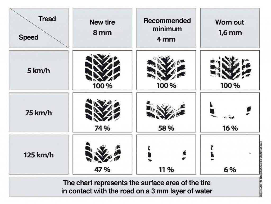

1,6 mm! Wow! That would make me sweat just thinking about it. I felt pretty nervous with my tread being down to just 5 mm this autumn. I would surely have swapped them for the spring if I weren't getting a new car.
This chart gives a pretty good idea on how important having enough tread is in the wet:
