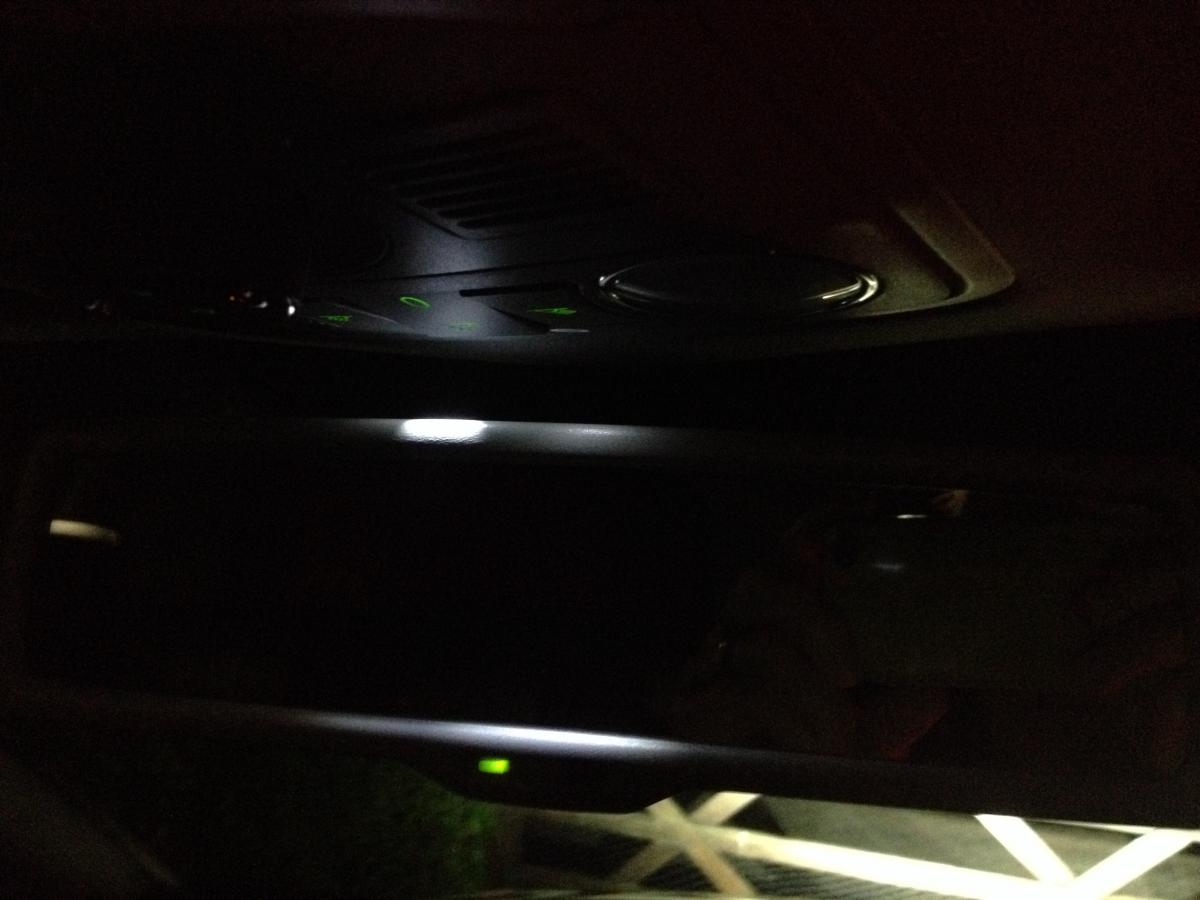

The distraction, for me, is the bright spot on top of the mirror frame which extends down the front of the mirror glass.
The right hand light is less of an issue as it largely clears the mirror frame.
Can you both post a photo with the lights on showing where they shine please.
I'll post one later of mine.
Why does yours have a green light under it?
It
It shows that the auto-dipping mirror is switched on.

I like how the little LEDs illuminate the interior at night, but can't get to like them shining on the mirror frame.

All have had identical roof switch/alarm panels and light sensor/interior mirror unit. On all three, they have also had cats eyes that do not illuminate. If they did, because of the position of the light sensor/interior mirror used on the Yeti when combined with the sunroof control panel, the cats eyes are in the 'wrong' place and would shine on the mirror so have been disabled at birth.
I reckon by my experience and all the previous threads on the cats eyes, you can take it that yours is, er, different! Be that by a strange build or a previous owner's DIY mod. If you don't want them to work - I'd do what others say, either cover them up or take the panel down and snip the wires....
Looks like the reflection is because the interior mirror is placed high up on the windscreen.
On my Yeti the mirror is lower down and the 2 LED's do not shine on the mirror.
I guess the easy way out is to either plug the holes with blue tack,
or cover the holes with a small piece of tape as close to the roof colour as possible.
OFGS! Hasn't this been done to death yet?  Just cover them up with tiny blobs of Blu-Tak.. 30 second job and almost instantly reversible if necessary.  Then we can get back to working for world peace....
