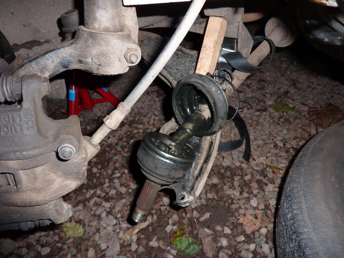

I've got a replacement outer driveshaft boot for the drivers side.
It's a proper one - ie not a stretch one or a split one.
I've got the shaft free from the hub, and pulled back the old boot and I've strapped the driveshaft so it can't slip out from the inner end.
As I understand it, the removal of the joint from the end of the driveshaft is the tricky bit so if anyone has any tips I'd be very grateful.
I assume if I get it off, getting it back on shouldn't be a problem?

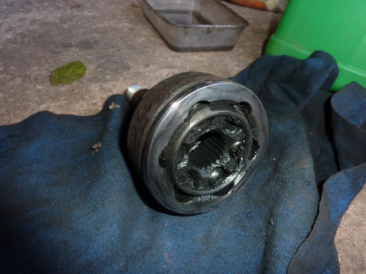

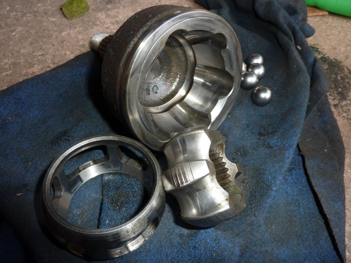

Excellent photos. Got any more?
Not really any useful ones - I took a one of the joint before I pulled it apart (in case I got confused how it went back together...)
But I had to clean my hands every time I took a photo - once I got on with putting it all back together, I didn't see the need for any more.
