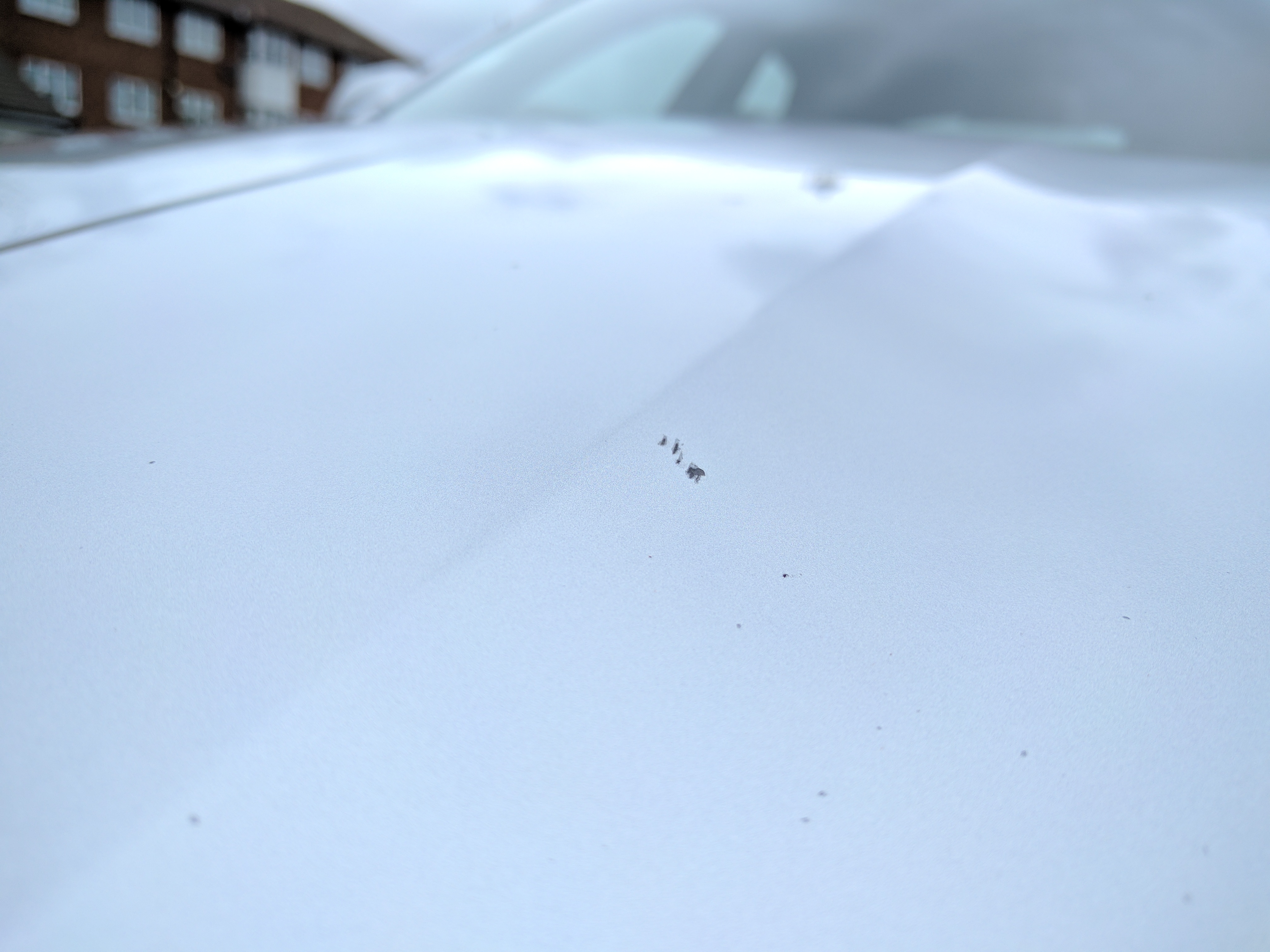

Here's some befores, followed by some with the first application of base coat.
Befores:

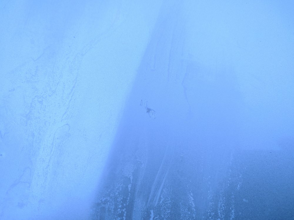

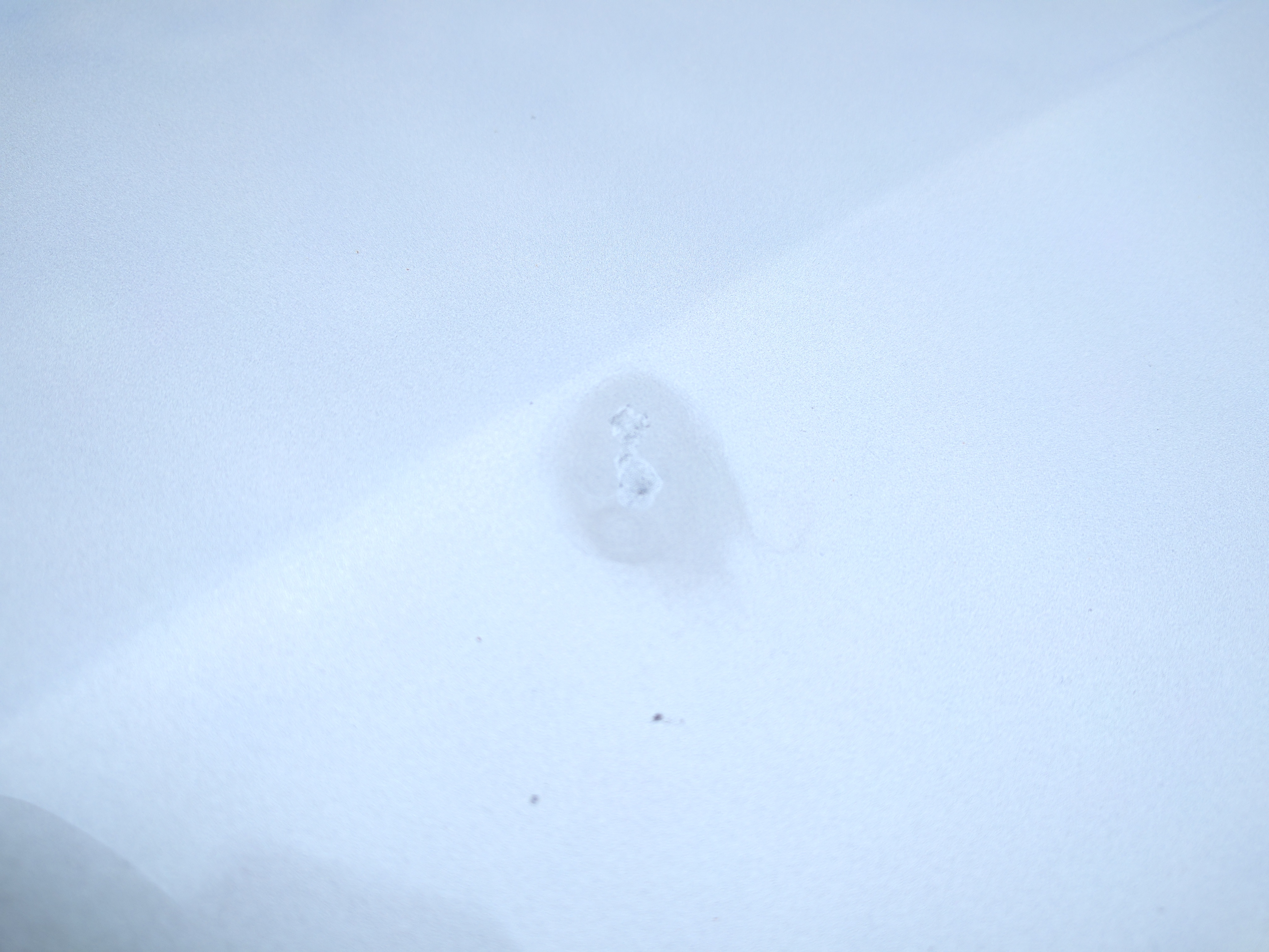

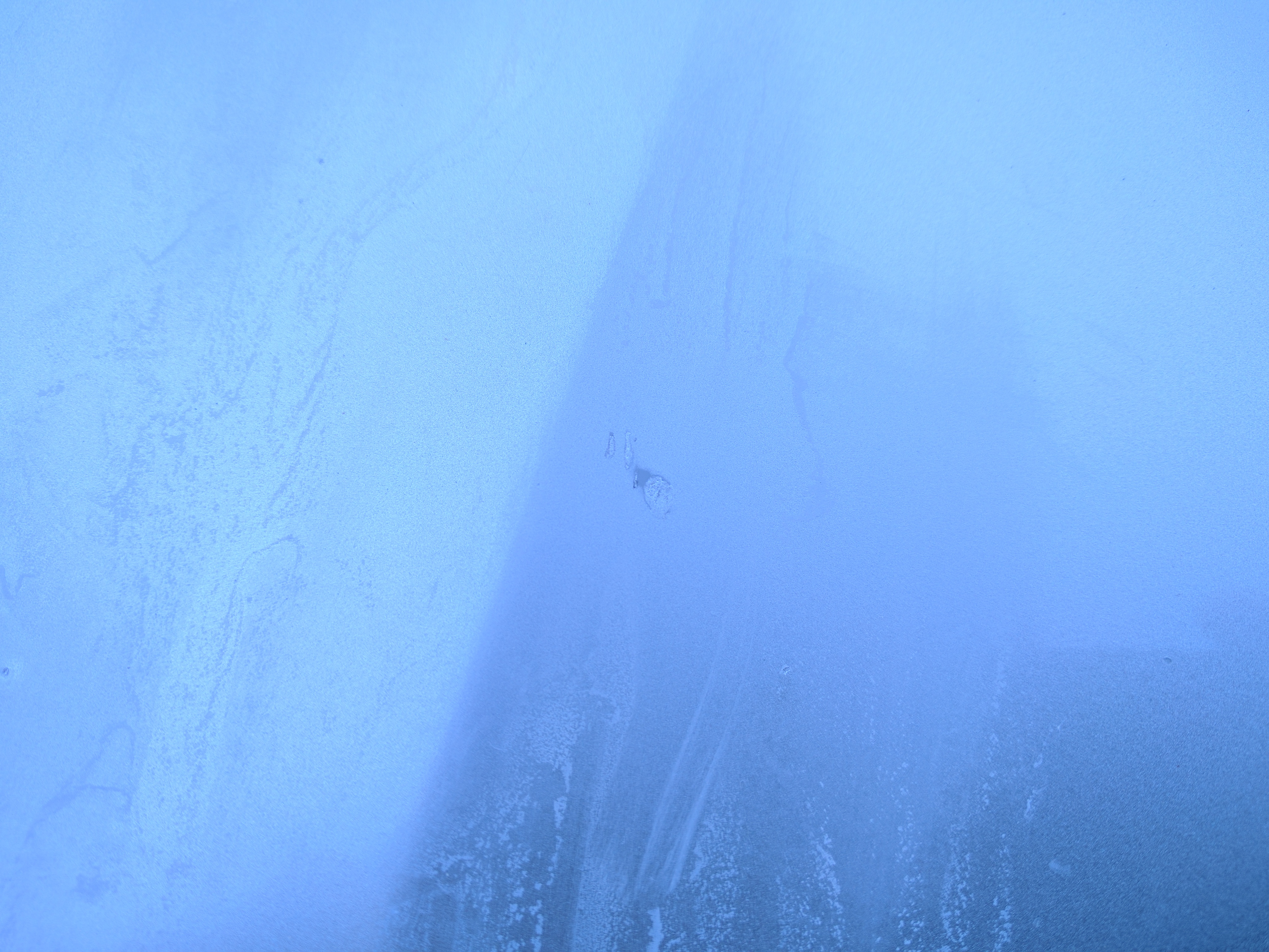

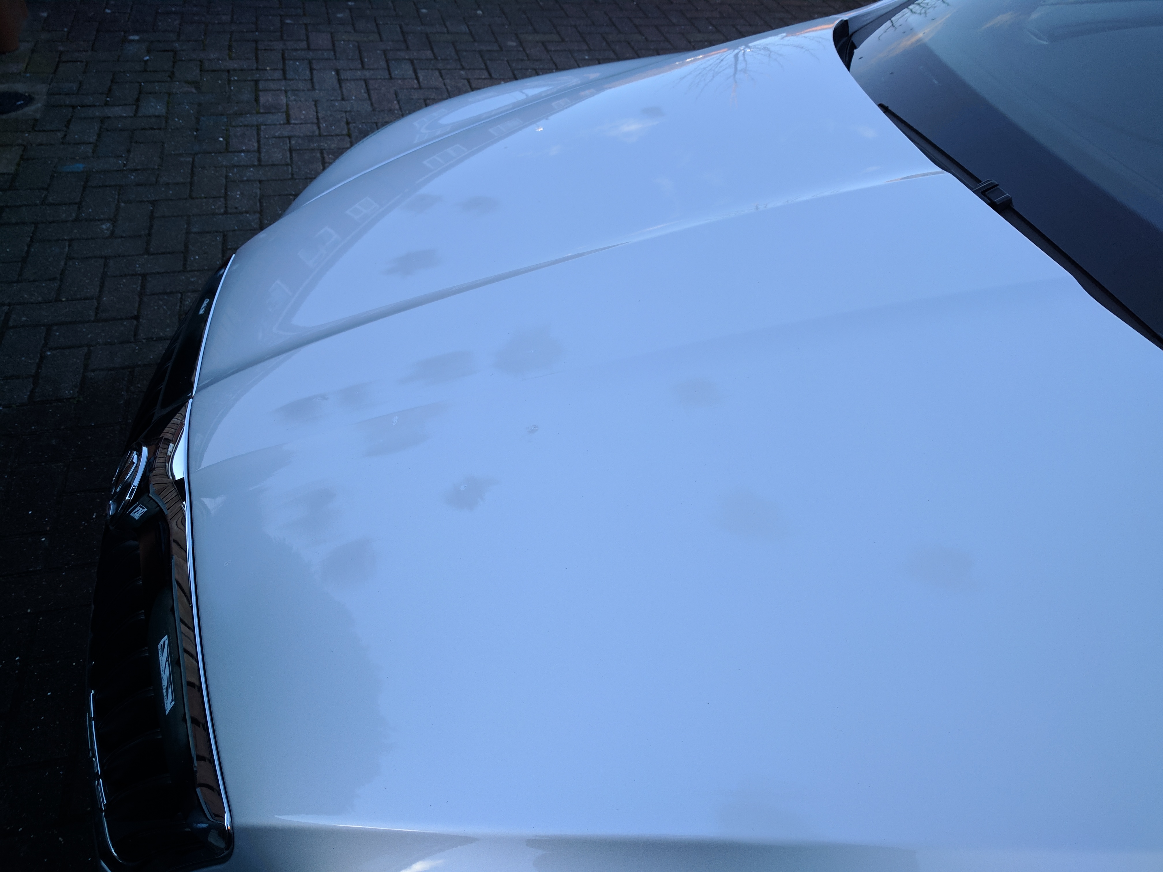

WIP, basecoat:. Ignore the cloudy surroundings - it's the result of 2000grit wet and dry to remove any loose paint and raised edges. It will all be polished out once the whole area is sanded with 2500 grit and blended.

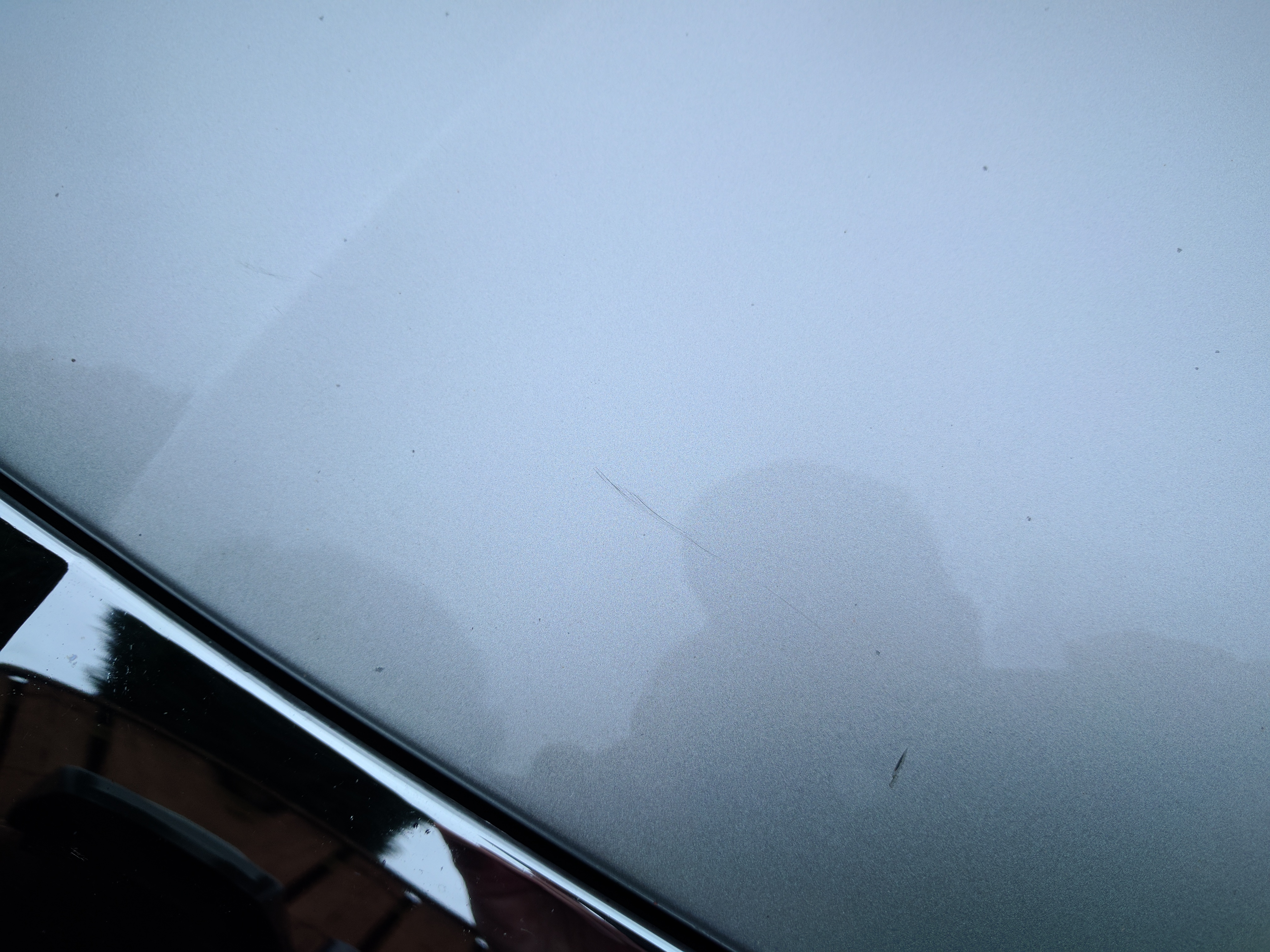

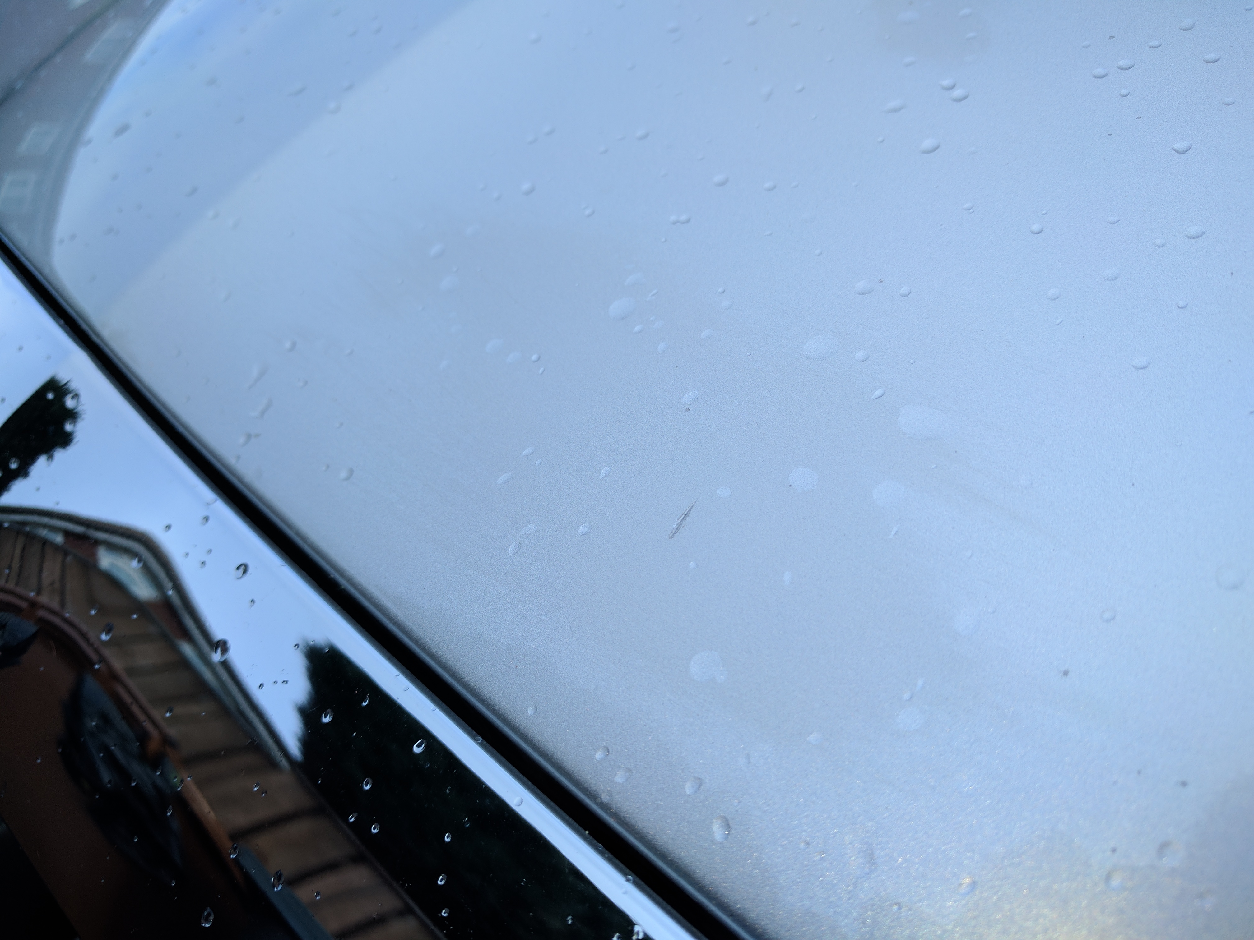

So, as you can see, hardly expert level, but as I say, silver is better than rust.  It'll all look a lot better when machine polished :)  The long scratch in the first photo is about 2-3" long, but thankfully only appears to be in the clearcoat.  I've cleaned and degreased (with 99% IPA) it and applied a layer of clear coat.  I'll apply a few more before sanding it down.  Should be totally invisible once I'm done.

Update:

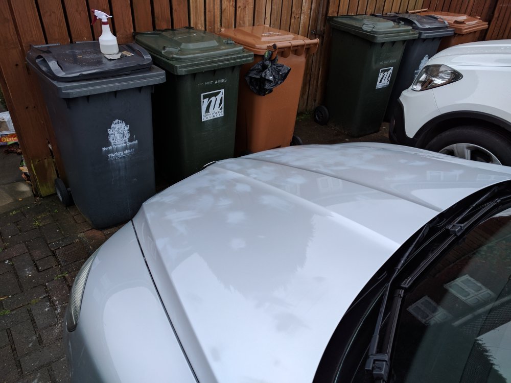

Base coat added to the some of the worst offenders on the bonnet and have given them all a quick sand with 2500 grit.  Waiting for the rain to stop so I can dry the bonnet (just rinsed and then washed it to remove sanding dust etc) and I'll begin the lacquer process.  The rest of the chips that need primer or base coat have been sanded with 2000 grit and rust converter dabbed in. Means I'll be driving around with a more noticeably damaged bonnet for a while but the end result should be good.  That 3" scratch is all but gone :)  I'll probably follow the scuff marks up with the farelca rubbing solution then will take a cutting a finishing pad across it with the DA and Sonax finishing polish.  I don't want to risk thinknig the clear coat too much.
Compare this image to the first image in the last post - use the deep scratch as a reference. The 3" surface scratch is all but gone :)

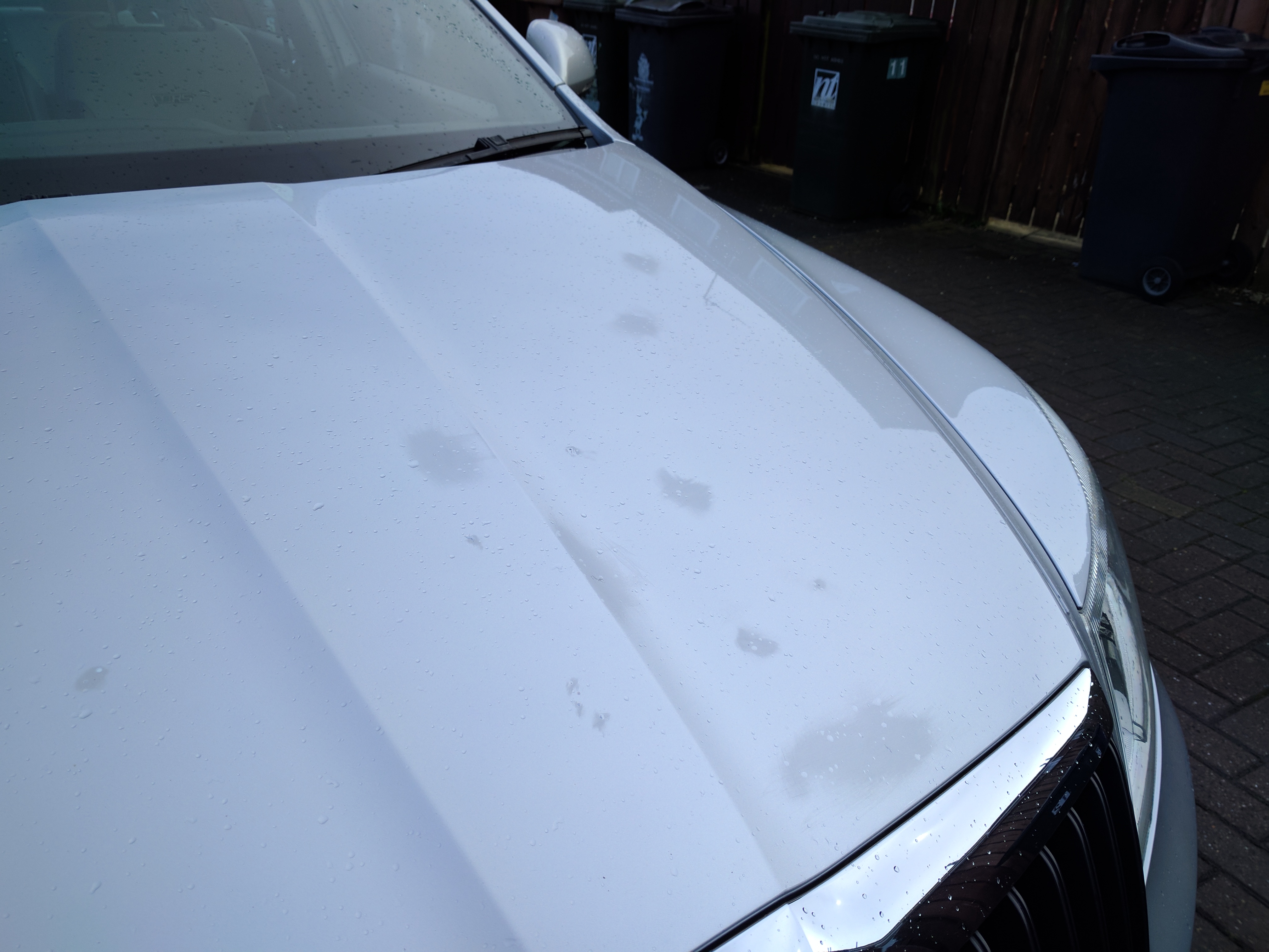

Don't do what I've done here, and that is to lose track of the amount of sanding you've done around a stone chip. I've managed to go down to primer! :blush
The bonnet is looking a bit sorry for itself:
