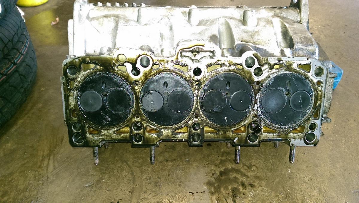

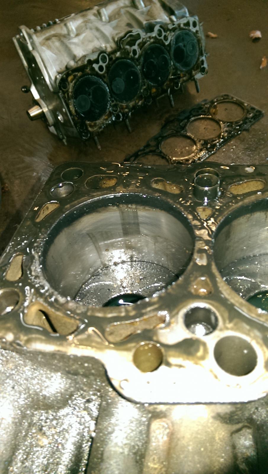

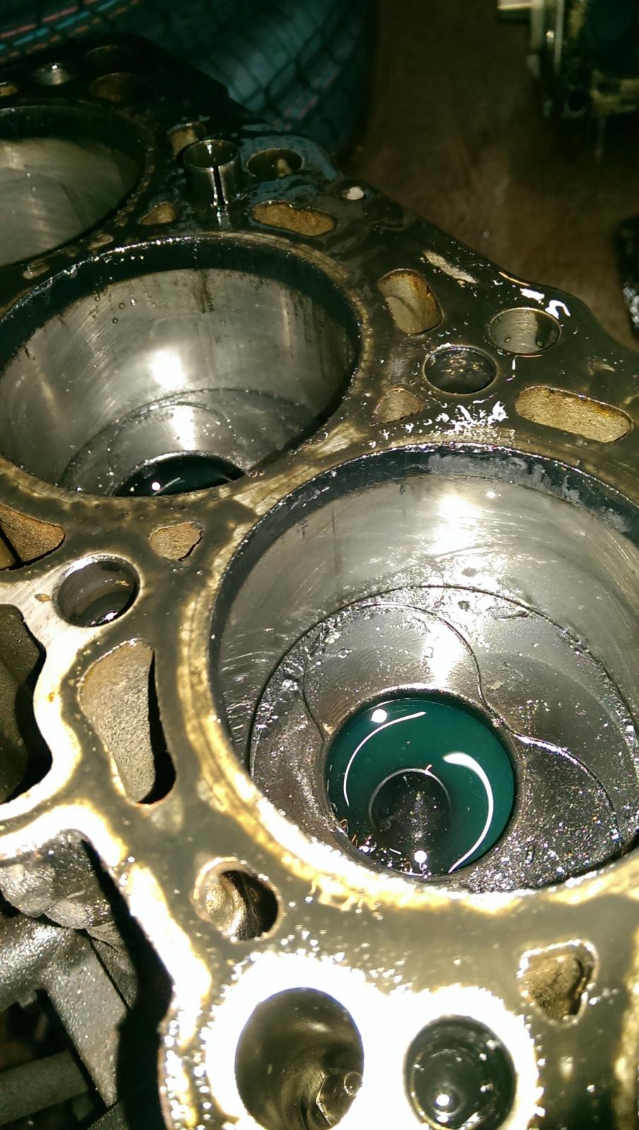

This is the internal damage done to my 1.9 tdi after only 104K its been serviced every 10 K

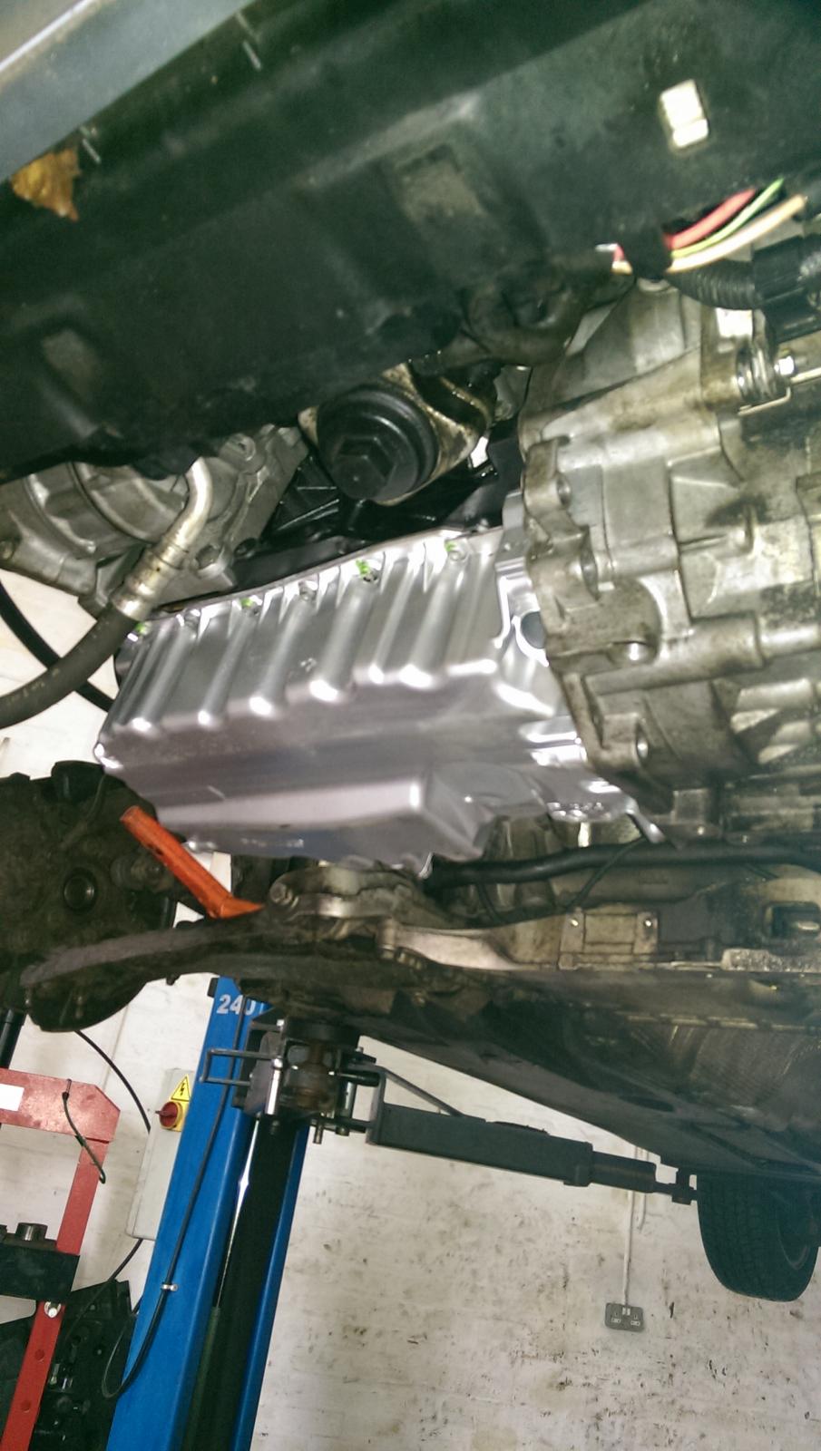

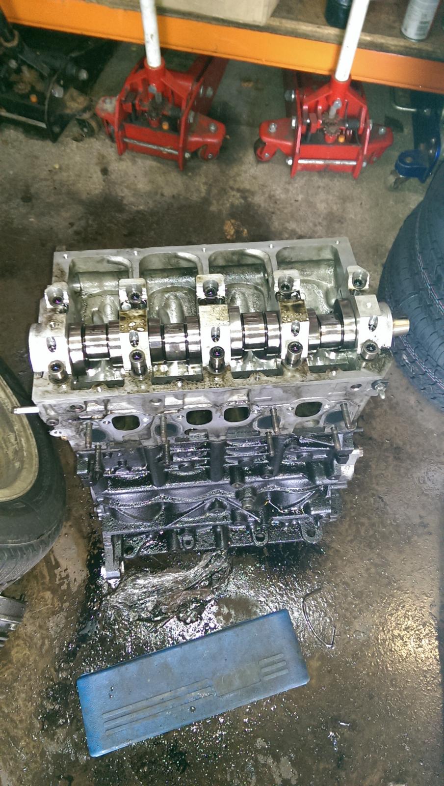

New engine in picture 1

What happened?
Engine failure at 104K is rare.
Engine failure on the 1.9 PD is rare.
Engine failure on cars on 10K service intervals are rare.
Something must have gone very wrong?
How much was the new engine Skip?
I think I'd have cut my losses myself.
recon engine £1140,with 2 years unlimited mileage, plus fitting
you can see the scoring on the bores it was pressurising the oil and forcing it out through the gasket and it was also getting burnt off
