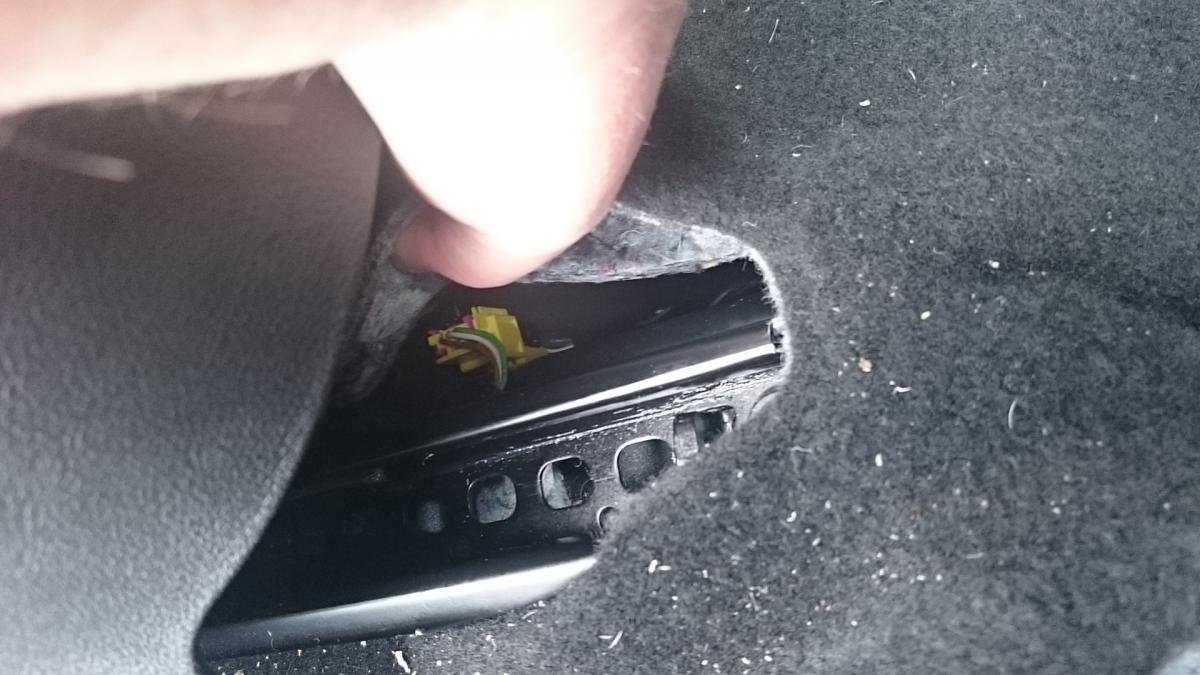

I've just been looking at this on mine, instructions say to remove the seat as well??

You don't need to remove the seat - you can feed the wire alongside the existing loom under the carpet :)
Cheers Andy, Ive taken the sill cover off and can see the wires, was just unsure about access under the seat. The instructions arent that clear (well to me they arent,  :notme: )
I can see a yellow connector that the seat is plugged into, under the carpet, I guess its that where i connect the smartgate?
lol
I stuck the smartgate unit underneath the vizi vest holder as the loom didn't seem to be long enough to put it anywhere else really.
You don't need to disconnect anything under the seat as they are the airbag connectors.
All the magic happens at the other end at the CAN Gateway behind the steering column
Is this it?
Ffs. I'm looking at it wrong way round.
Yep, you need to bring the loom up through there
I was thinking the connection went there ffs
But it's the module that's under seat lol
Connector behind steering then.
