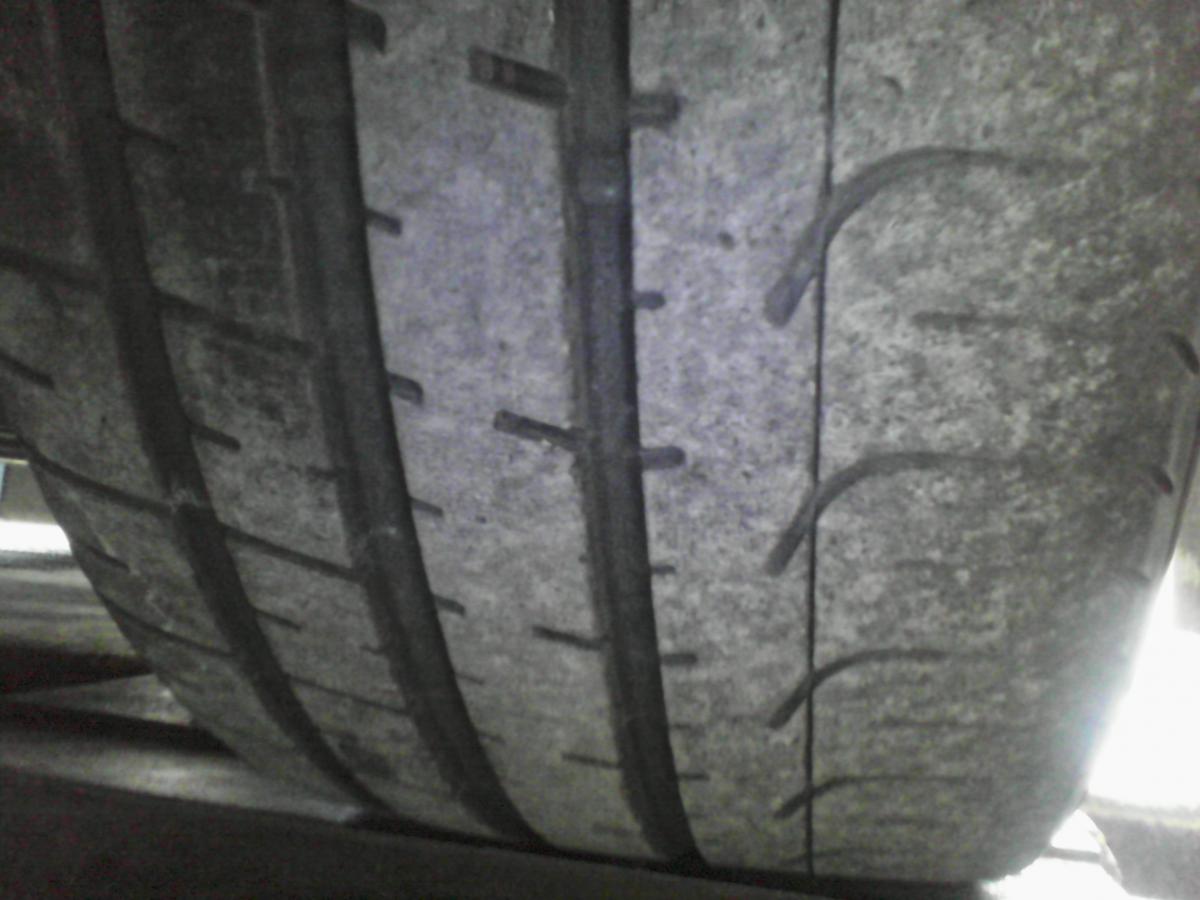

The tester can only take a tread depth measurement in a primary groove that is within the centre 3 quarters of the tread.  Have a look at the testers manual of the definition of tyre tread and what can be measured:
http://www.motinfo.gov.uk/htdocs/m4s04000107.htm

I don't see the problem really as they didn't fail it on tyres..
Legal limit is 1.6mm they advised 2.1 and 2.3mm.
Maybe they were incorrect readings but at 2.1mm you only have 0.5mm before it is illegal.
It could be down to that in a few hundred miles depending how you drive it.
The tyre manufacturers and no doubt main dealers would recommend changing them far sooner.
