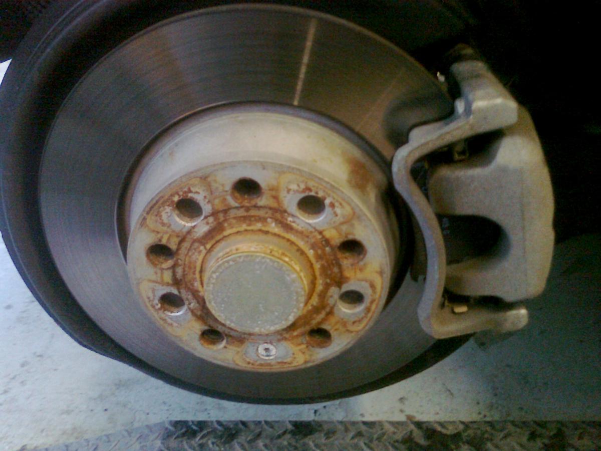

I mentioned that I couldn't see any visible corrosion on the outside through the holes in the (steel) wheels, to be told " oh, it's on the inner faces".
Looks like this?

Looks like this?
No, I believe they mean the inner swept surface. As they had not taken the wheels off, they couldn't have seen the hub.
