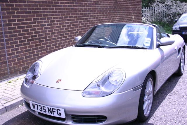

I did the whole Porsche thing a few years ago when I owned a W reg Boxster S.
Reliability when I had mine was a big worry, even before I picked it up the garage (Porsche Specialist) noted that the VVT was not working which delayed me collecting the car by 2 weeks. Apparently I would not have noticed, but as they sold loads of these they did.
I never had any problems with the one I had, but the 3.2 engine was known for issues with Cylinder linings, and the gearbox output seal (RMS) was a known weakness.
The car was fantastic, it went well and was reasonably economical. However the lingering reliability issues led to me selling the car, the biggie being the cylinder liners.
