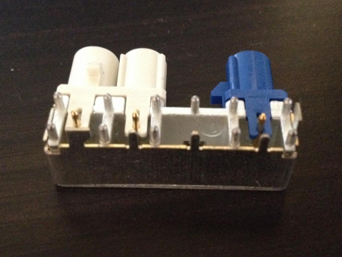

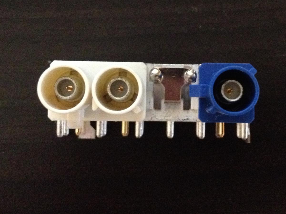

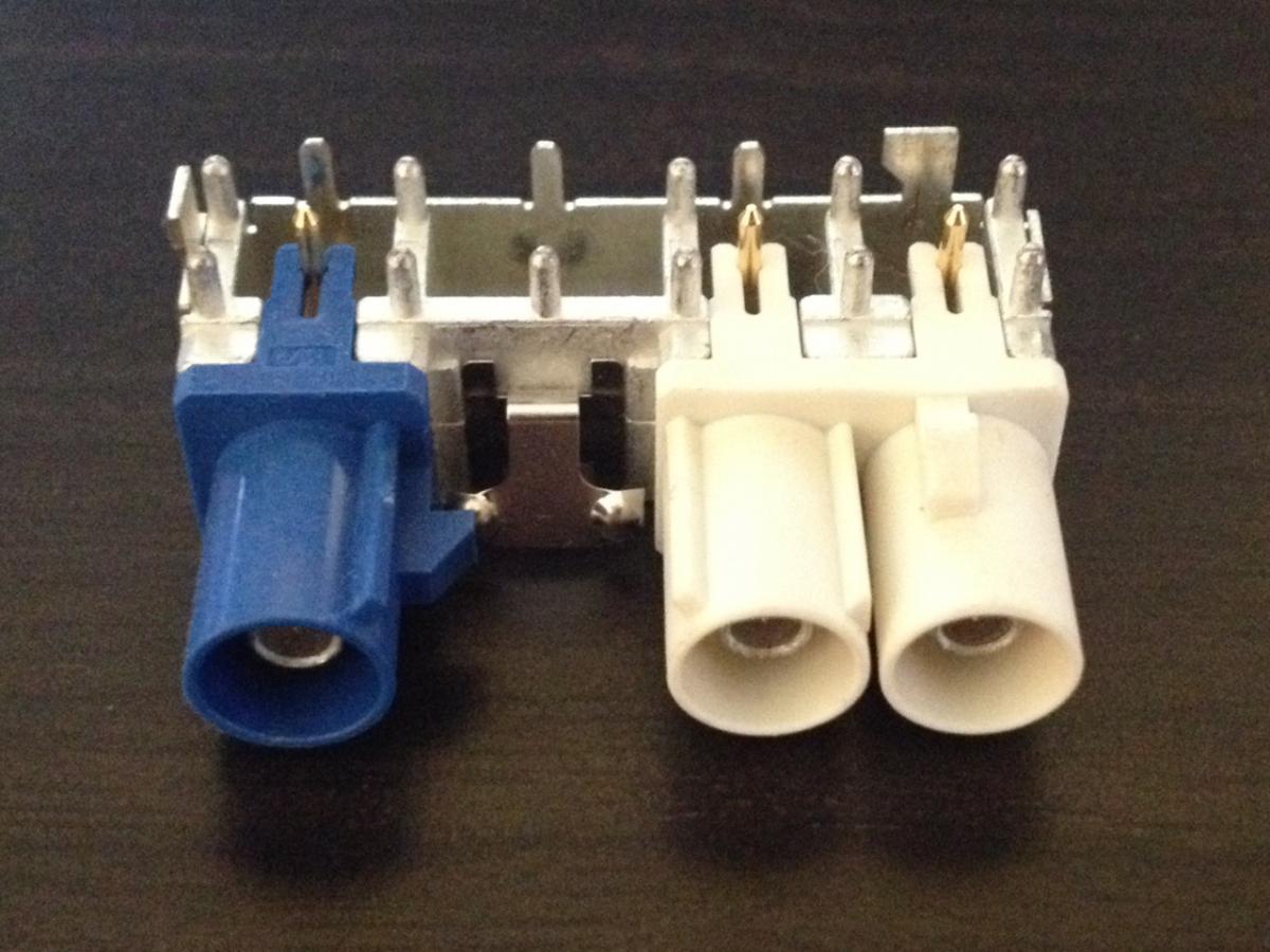

Here's some picture of the part in question and a link to the only place I could find them for sale.
post-59543-0-07703800-1425121257_thumb.jpg  post-59543-0-94696000-1425121324_thumb.jpg
In the next picture you can see the three thin pins inside the metal sleeves. My Columbus (2010) did not have the metal sleeves and consequently I managed to bend and snap one of the pins.
To be clear, the one nearest the blue GPS connector is for FM and, if your car only has one antenna, is the one I recommend you use for best reception.
