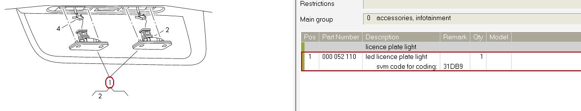

How about these I found on ETOS when I put my MY2015 VIN number in....
Do you have the part numbers?
Do they match those on the packaging from the Audi LED's pictured above?
It's in the picture... Lol
000 052 110
I don't get anything come back for that part number with or without spaces on skodaparts.com
Me neither which is why I suspected it wasn't a Skoda part number..?
ETOS is the official parts software for independents which I subscribe to, so any dealer will recognise that number.... It is a genuine number and comes up as an accessory for my 2015 Superb using the VIN number
£5.71 each from the dealer according to ETOS ;)
Don't forget they will still need resistors fitting though to stop the bulb warning.... But at least they seem cheaper than the VW ones people have been buying previously that have been in the region of £20-odd plus resistors.
Not sure on that, they are a genuine accessory and the picture shows the coding for them, so they may just work when coded
On new Superbs they can be just fitted..... In fact any old LED CANBUS bulb can be fitted but on older cars my own included it doesn't matter what coding you do via VCDS (Note my earlier post #11 above) they will still need resistor installing unless they come with them fitted inside which i doubt.
It seems something has changed on the newer FL cars compared to the pre FL cars.
PM me a VIN number for an earlier car, I will see if they come up :)
