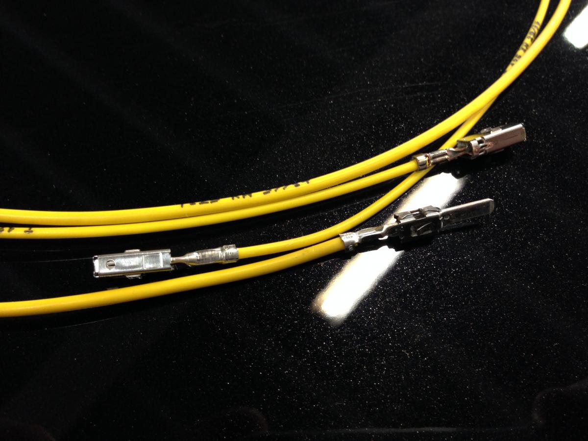

After some googling I found out that you can buy replacement pins for the multiplugs that connects the doors wiringloom to the B-pillars plug.
Those pins comes with wire on, so you can solder on som cables, but don´t have to crimp the small pins on a cable.

I have attached a picture of the pins I got from Skoda.

Hi friends i need help. Please tell me the code of terminal parts ( male/female terminals with yellow cable).

Where did you find those replacement pins? Link? search quote?
How did you get through the rubber sleeve between the B-pillar and door?
pins ... that's a good question. Can't find a partnumber online :(
 - Bret
okay, so 8k0972701 and 702 appear to be the housings, but the connectors are not clear....
 - Bret
I've been informed (thanks strandgaard) that the pins are called Junior Power Timer (female) and Junior Tab (male)  (http://www.c-j-l.net/Home/automotive/audi/electrical)
N 906 844 05 (female/Junior Power Timer) and N 103 189 05 (male/Junior Tab) or
000 979 133 (1,0 mm²) (female/Junior Power Timer) and 000 979 134 (1,0 mm²) (Male/Junior Tab) <-- with wire

I can´t remember the number, it is simply new pins with cable, that can be used to repair damaged wires. I just asked the dealer and they got them for me.
