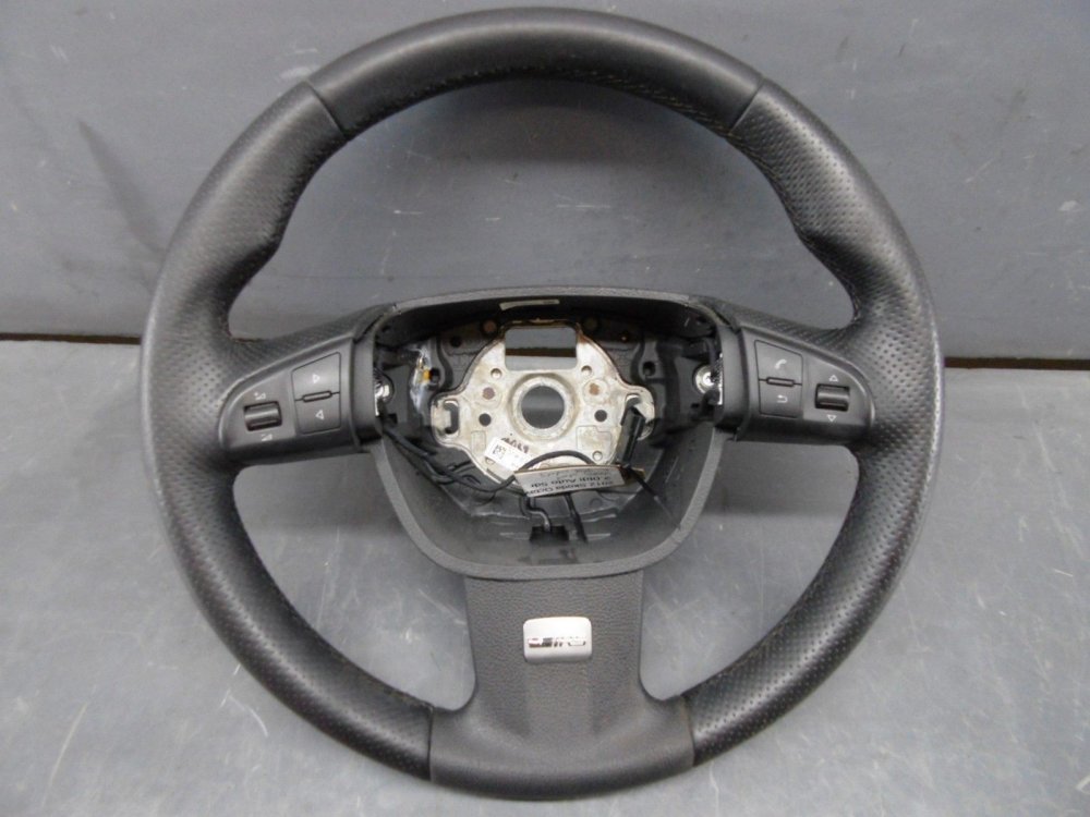

I have a question. Car: Octavia 2FL, MY 2012
Can I replace my 5K0-953-569-C for a used 5K0-953-569-H which came from a Passat, 2012? Both controllers produced in 2012. The original (C): HW15 SW 140, new (H): HW14, SW140.
The "new" steering wheel is like this:
Thanks for any reply.

you have one ending 569 so as long as you buy one ending 569 it will be ok
Only thing is not to buy one from a passat as that doesn't have an ignition switch
569E
569H
569L
569AL
are ok for the Octavia 2 FL

Now I got a 5K0-953-569-H, 3-spoke MFSW and a 3T0 971 584 cable loom (I still have to make the latter from an old cable) .
The car has cruise control, normal "dumb" cluster with b.computer (buttons on the right stalk), RNS510 Columbus+BT. Coding is no problem.
Do I have to change the right stalk to a normal, without buttons?
Or what problem I can face if I have a non-maxi dot cluster?
Thanks.

You won't have full functions on right side of MFSW
on a VW mfsw it can work trip computer even in non maxidot
Skoda mfsw can't control trip computer in non maxidot
leave your stalk to control trip computer
