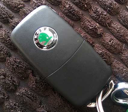

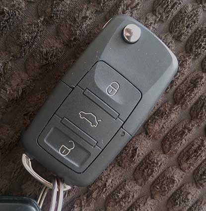

Just one more thing to consider it is also possible to get the genuine Skoda kit which I believe consists of the CCM and a genuine key fob which will also need the immobiliser transponder take it from your current keys, (if you only have one BE CAREFUL they are glass and delicate)You will need to do this anyway with the ebay kit, I can tell you how I did it on both keys without issue if you need me to. There was a very knowledgeable bloke on here someone that had fitted this a few times but his name escapes me. The ebay kit is the cheapest way I would have thought but just another option to consider. These are the keys from the ebay kit once done.
