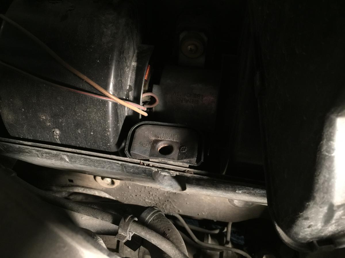

If it was raining really heavy, maybe the drainage holes in the scuttle couldn't cope and it filled up enough for water to get in through a grommet or the heater box?
Speaking of which, I have always wondered what is the point of designing what appears to be a draining hole then sealing it with a rubber plug... Anyone ?
trauMa, is that plug still in place?
My best guess is they're sealed to stop you drawing any fumes from the engine bay into the cabin but the rubber is designed to sag under any weight of water which then flows out. I can't see any other reason.
You mean something like a one way valve? I thought about that too, perhaps somebody with a garden hose will test that. But in my opinion, that rubber will either fall off completely or will seal so good that water will pour on driver's knees. To me it looks more like a drain plug that you take it off manually after a heavy rain. But that would be silly, since I don't see why you would need a pool in blower's housing... to add humidity in the cabin and fog the windows more than Felicia heating system already does??
It is a mystery. Till somebody finds the truth, I will take off the rubber plug. We have terrible rains in here and I don't want the blower act like a paddle boat...
Hello again. It's been a while. But I finaly found the time to do some more reasearch and repair. So I cheked the plug Ricardo, and it was still there. I refitted it, and it seems like it's some kind of one way valve. It looks like the side of the plug bends down under the pressure of water, and then closes again when there is no pressure. Did not test it with a hose tho.

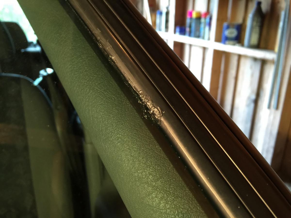

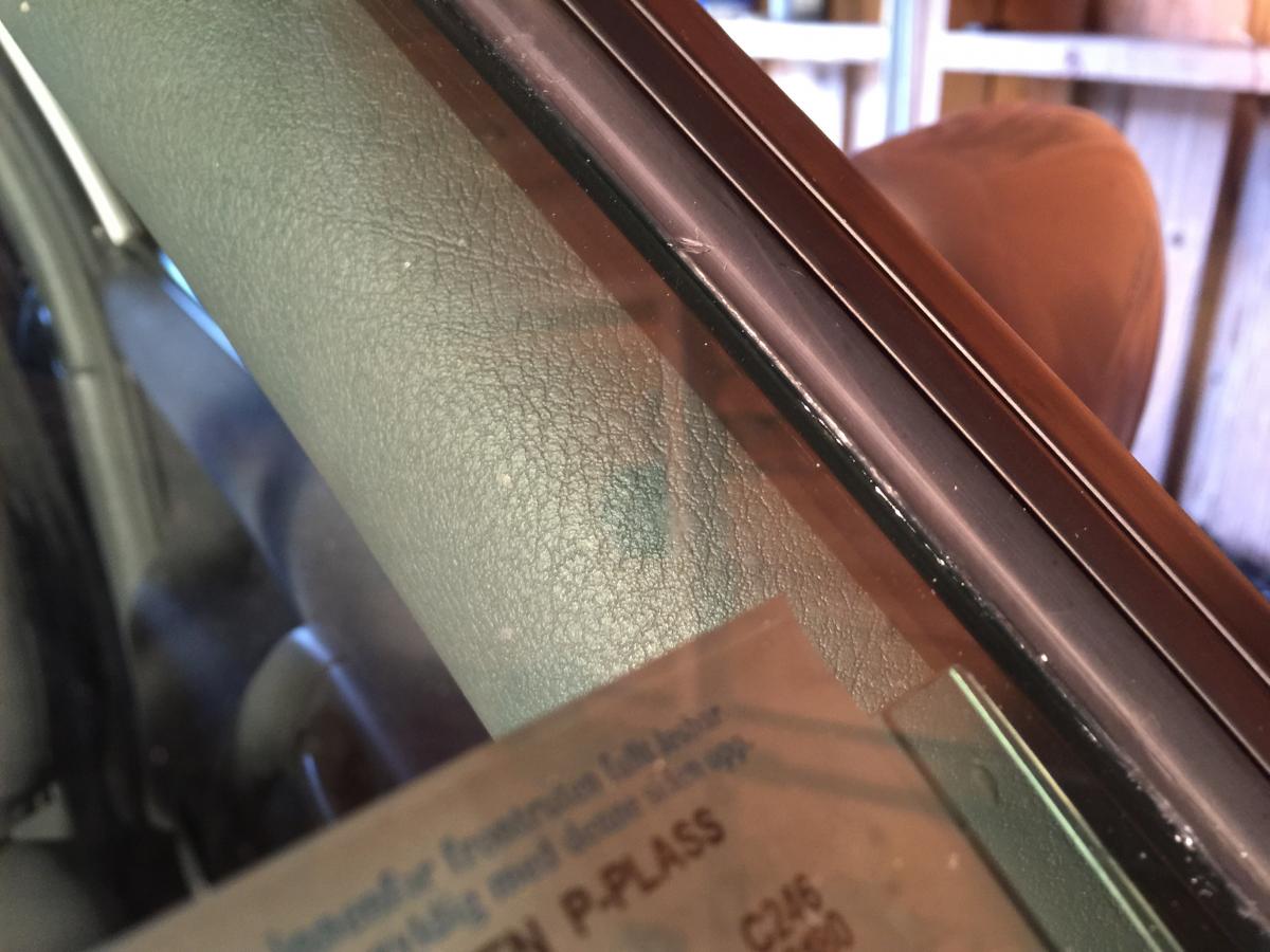

Anyways, I sealed off the windshield with silicone. Hope that helps to stop the leak! As usual I took some pictures.
This plug was completly blocked by dirt and other stuff. Also found a lot of leafes and stuff inside the fan compartment, it was nice to clean it out.
Cleaned the plug and put it back. Is this the place for it?
I don't have that plug on my fan blower housing.
The place for the plug is shown below.
I got the bottom plug in place, but I thought it was something odd about the top plug. The way it was cut on the side just didn't seem right/ original. But i find it logical what red studio is saying about stopping you from drawing fumes from the engine.
