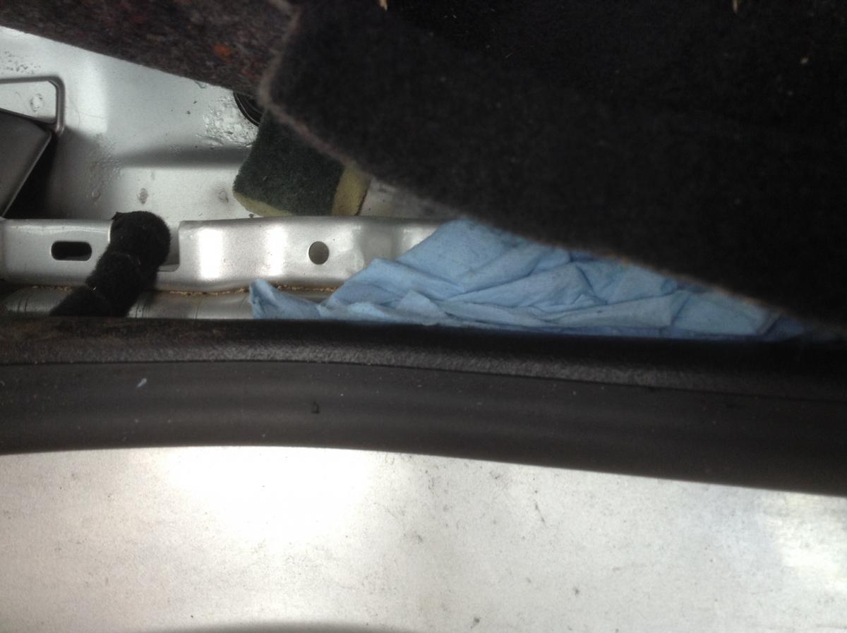

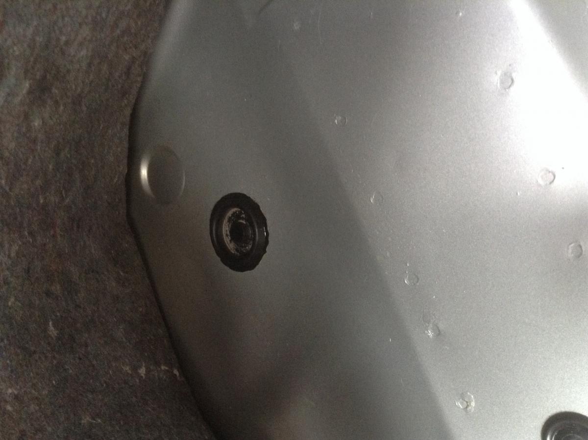

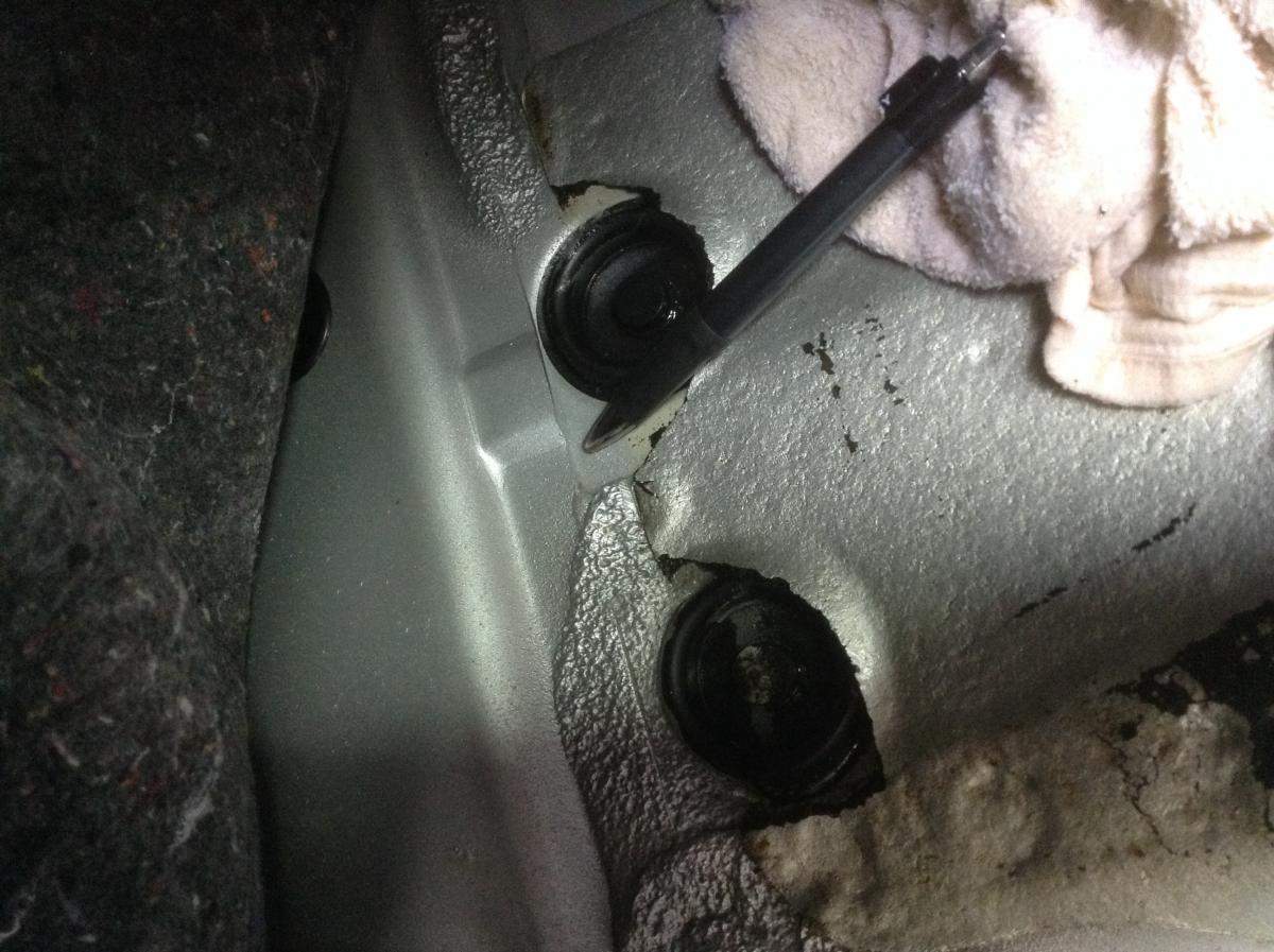

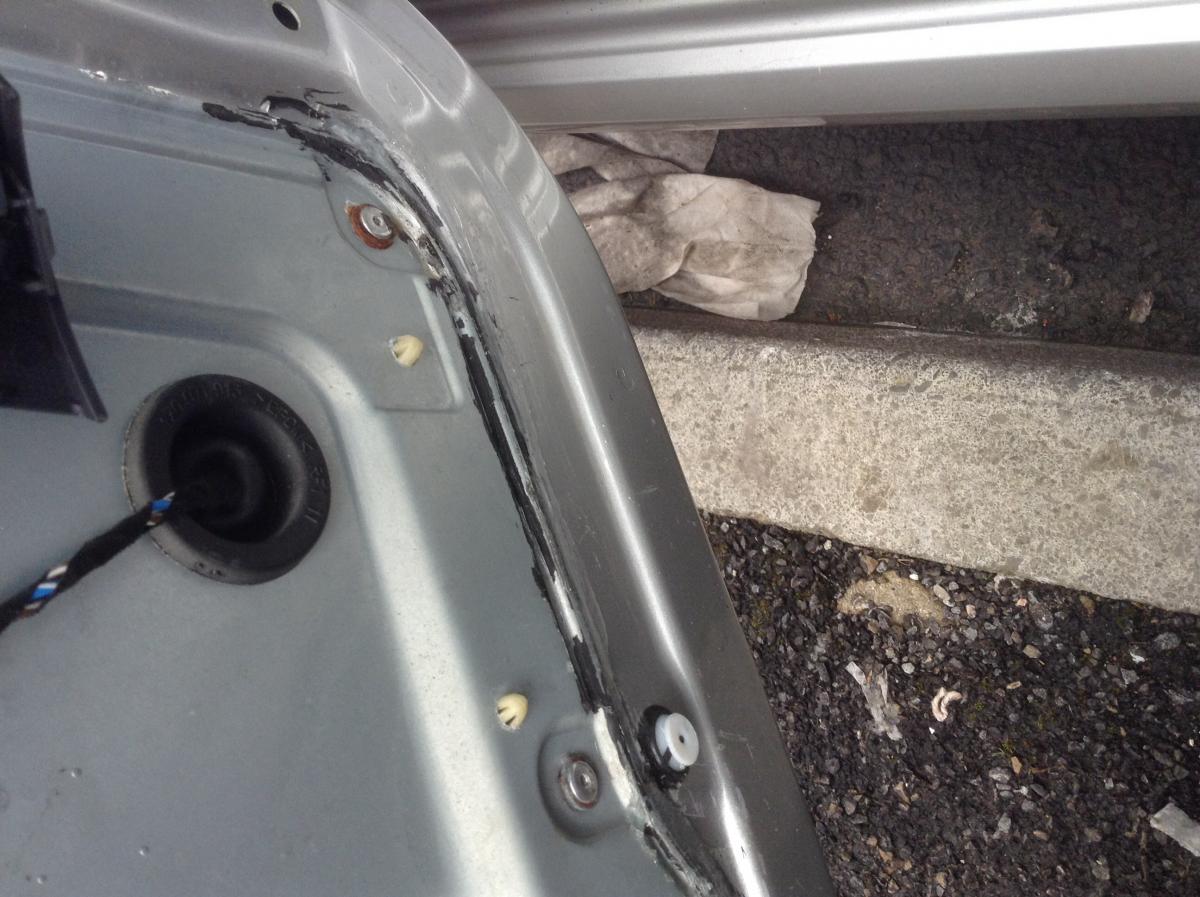

Car leaking from the bulk head area passenger side I think, pen is pointing to the area where leaking, also from the rear seatbelt attachment see pictures. Rear door has been sealed but leaking from bottom clip and from a rivet, think water is getting in via the rubber seals. Help.

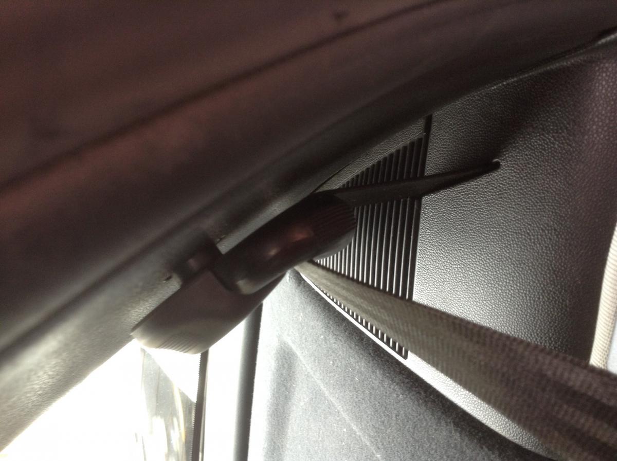

Rear seatbelt area one will 100% be the rear washer connection which is just in that area, either completely or partially (as shown below) disconnected:

To seal Rear door's properly you need to drill out the rivets, remove the panel, clean up and reseal, then makesure you've got sealant around rivets and that the rivets are tight in the hole.
You will find the original rivets are slightly loose, which causes the leaks.
Or the other way is too cover the rivets fitted now in sealer.

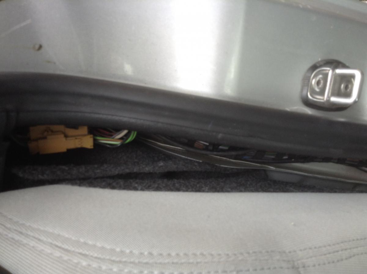

Thanks for advice wino, faradaycage and coskev, coskev I don't have a sunroof, doors won't be a problem, remove and reseal, it's the leaking from the front I'm more concerned with picture 1, when I wiped the water away It just reappears from under a small gap, I've removed the plastic bungs which has an open space underneath, I thought it was running from the boot area right through to the front and soaking my carpets, also the door rubbers Ive noticed collect water in the corners aee pictures 4/5 and it then tracks into the car, it's defo doing this as I've put blue roll along the area an it was soaking yesterday. I will look later.
So the pic with the pen is the bulkhead or the floor?
If it's bulkhead I would take the panel off under wipers and inspect all areas of scuttle.
Wino I've checked the rear washer pipe and it's ok, coskev that's my next plan of attack remove the plastic and check behind it, coskev where the pen is pointing ie the tip, there is a gap and water runs from here, still is, thanks again for your advice.
Is it on the bulkhead or the floor though, can't tell from the angle of the pic? :)
This is in the the footwell coskev, I'm going to run water on it tomorrow, long day.
can you zoom out abit, can't work out what/where im looking at
