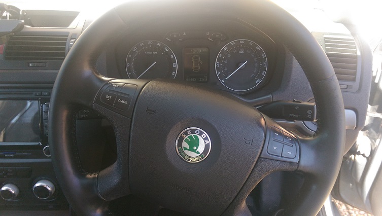

I'm not sure a maxidot or MFSW from a MK1 Superb is going to work.
Superb MK1:
Octavia:
Superb MK1 (note the buttons on the sides):
Octavia:
Only the wheel is from a Superb, the maxidots are from a TDI and are already in and working 100%. The wheel I have is very similar to the octavia one, I may have to change the buttons yet not sure as mine has cruise and audio, think I did see that in VCDS though:
