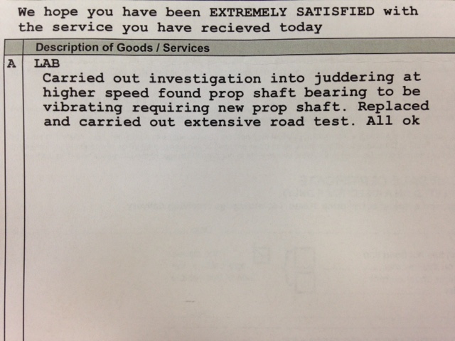

So, the car is back with (allegedly) a new propshaft... I shall be underneath it later checking for myself!  I haven't driven it but the workshop assures me it has passed a test drive (and it was driven back to me).
And with it comes the paperwork.  Here, in black-and-white, is what I consider, in my opinion, to be either a bare-faced lie or an enormously ignorant mistake.

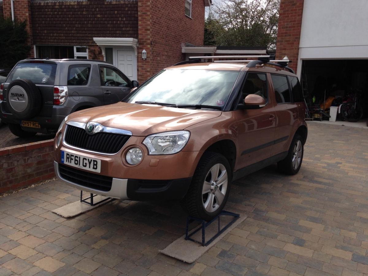

I'm sure you took some pictures before sending in? ;-)
Yep - see post #4 of this thread (I have others too).
...I even took pictures of it up on ramps and being recovered to prove that this all happened.  It is a sad state of affairs when you expect to have a fight about these things and have to proactively gather 'evidence' to prove your position.
