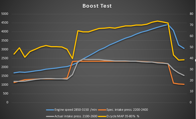

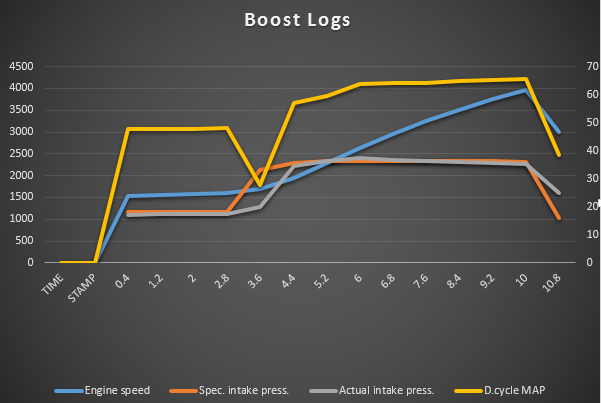

Right, I think I've discovered something.
Before when my car was running better, my duty cycle for the n75 appears to have been higher.
See graphs:
Previously: Dcycle MAP climbs to 64% at approx 2400rpm and peaks to 72% at approx 4000rpm.
Now: D-Cycle Map climbs to only 57% at approx the same sort of point and only reaches 64% maximum at any revs
What does this mean? I've done a tonne of Mr Muscles and haven't touched the screw on the VNT actuator. This could explain the lack of power. Perhaps its caused by the timing?
