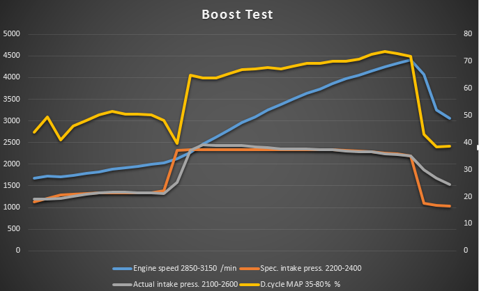

Right, heres my boost log. Looking ok isn't it?
What he is saying is that if the Turbo wasn't sooted up beforehand then cleaning it will make very little difference, that's not to say that it doesn't help on a turbo that needed to be cleaned.
I don't know much about mapping but to me that graph looks ok, the specified intake pressure is nigh the same as the actual so correct me if im wrong but that would indicate no boost leaks?
