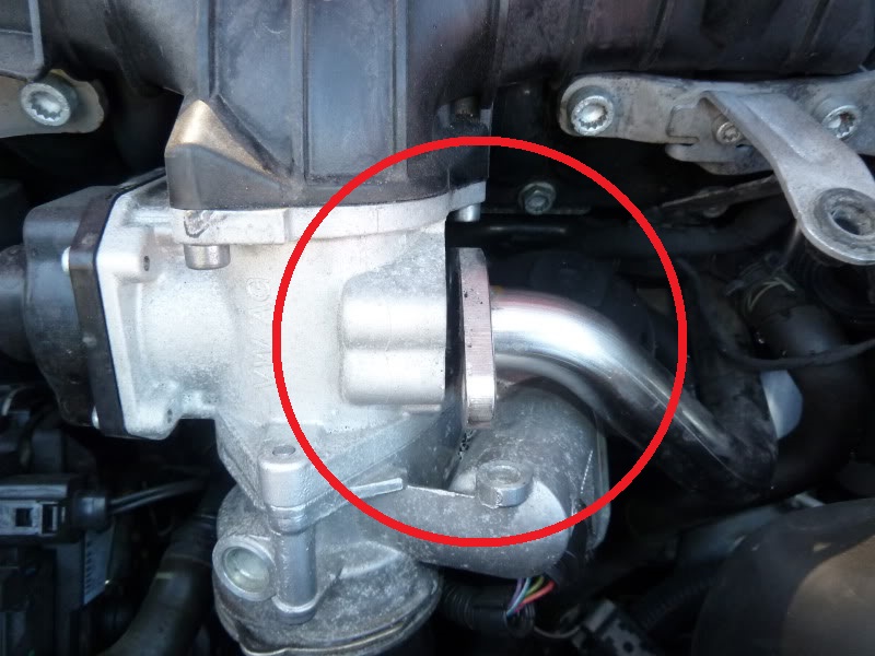

Do you have any leaks of boost anywhere? a smoke test will show this up in 5 minutes
Also its easy for the EGR connection near the inlet manifold/anti shudder valve (ASV) to sometimes leak
I checked mine a few days ago and it was seeping air as it had a blanking plate added
I tested with a fairy liquid solution making tiny bubbles now sorted with cleaning and small amount of hi temp sealant

EGR Plate ordered, and i work with sealants at work and make gaskets etc, so thats not a problem.
Interesting read on the timing, I will have to check l/h figures out. for the rear cam. Though tickover is silky smooth.
Hopefully this will sort the lag out. I found a good EGR delete kit from europe that works out as £38 delivered, its slightly more agricultural than the fancy ones but looks identical.

Can you show me this EGR kit delete? and does it keep the anti shudder device ?
