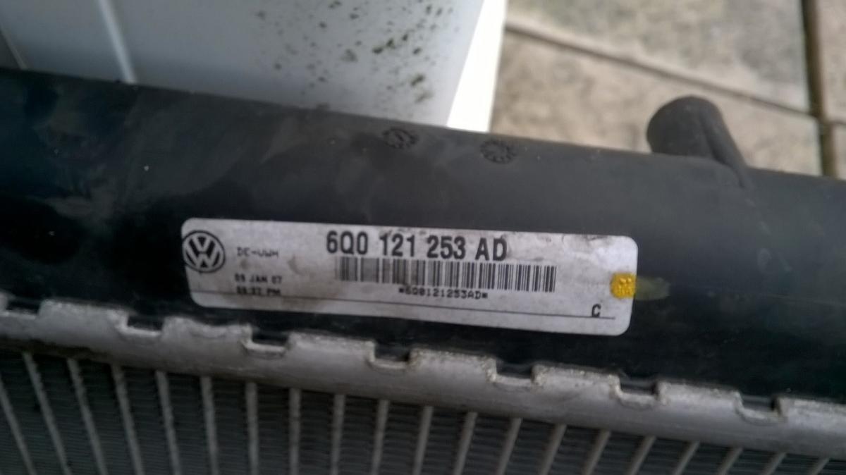

As the weather has warmed up my radiator has suddenly sprung a leak from the bottom corner (I know its a common problem).
Its an 2007 Vrs S.E BLT Engine and the original radiator is part number 6Q0121253 AD which is well over £100 for OE.
ECP list one on their website (EIS Germany brand) for £35 and when I put my reg in it says it is the right one and replaces 6Q0121253 AD.... lovely I thought so off to ECP to buy it BUT when they bring the box out out the label on it (Part no: 203 44 2200) says it replaces 6q0121253 Q and 6q0121253 R ???
I know VAG superceed part numbers all the time but acording to VAGCAT the "Q and R" part numbers are for the ATD engine and even the sizes look different (One is 632mm x 414 and mine should be 630mm x 408)
Confused????...I am!!  Anyway my question is has anyone here fitted / tried fitting a ECP radiator to a VRS......does it fit???? Or shall I just go and give the dealers a load of my hard earned cash???

Thanks for the replies. I took my old rad out and went down to ECP. The EIS one that their website says fits the car is NOT a perfect fit, it is about 1cm less wide (from side to side), it would fit the car but would leave a bit of travel from side to side (Not ideal) also the holes for the fan cowling do not line up so you would have to re-drill new holes on the fan cowling and also cut a lump out of it as it would foul the fan switch!!!
This was done without taking it out of the box so I have no idea if the other side (Holes for the scews that hold the aircon radiator) is the same? So with the weather about to change for the worse I bit the bullet and went down to the VW garage round the corner and bought the proper one. Interestingly when I googled the part number (6Q0 121 253 AD) it seems that this is specific for the Fabia VRS and the the Polo GTI 1.8 turbo petrol only so I am wondering if it has more cooling cabability than the standard / cheaper rads??

it was £115 +vat and 73p each for the 2 o' ring seals I am sure you could get it cheaper from TPS or an online dealer but soon as I already had the old one out and the other half needed it for work I went for the quick option.
Its all done and fitted with no messing about, also with the front end off the car its an absoloute doddle to whip the intercooler off and give it a clean out as they tend to accumulate dirty engine oil in the bottom of them over time.

Ok thanks for that so the one you got for £74.82 + vat is part number 6Q0 121 253 AD
Hi Fozzie. I just called to check my order and it is indeed the same part number. All I can say is someone did me a big favour on the price at TPS. I don't want anyone to get in trouble over this.

Definatley AD on the end of the part number on my 07' plate VRS and as far as I am aware it has not been superceeded by a new part number as the new rad from VW had the excact same number.
Yep sorry AD is correct, the part that ended R, was a coolant hose that somebody else phoned about. Must be right about the weather as we has a few enquiries about radiators and hoses just in last couple of days, got too many part numbers running round my head and ive just started making my own up lol.
