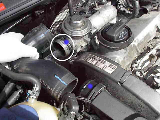

Haha I'm not quite sure to be honest. After more research I've now established it might be coming out of the EGR valve? I've found a photo of where the loose connection is. If you can tell me exactly what it is then I might be getting somewhere!
The white circle is where the loose connection is, although the pipe the guy is holding looks like a different type of connection to mine...post-127008-0-21039800-1429889472_thumb.jpg
Ok that's where I'm unsure, don't know those engines well, sure someone will pop along. Might be worth starting a new thread with that pic and asking.
