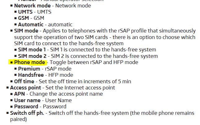

On mine, although a MY2015 car you can select the connection option via the MAXI-DOT, this will then either connect as rSap or HFP, I think HFP may solve your issue as the phone stays connected to the network rather than the car reading the SIM..
I think the issue is that "3" SIM cards have an issue with rSap...
It should be in the phone settings menu in MAXI-DOT under PHONE MODE
