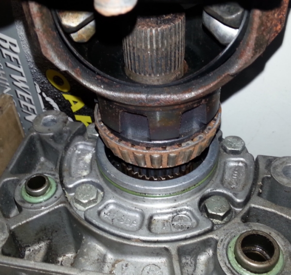

You wouldn't need to do anything to the front diff - the rear pto is powered via the outer casing of the diff
Thats the front diff sitting on the transfer box (its an 02M diff/transfer box, but same design) - the rear pto drive splines are below the roller bearing - the splined shaft sitting inside the diff is the right hand driveshaft pto
The transfer box has no step-down gearing, the prop runs at 1:1 ratio
iirc the rear axle diff casing can be detached from the central haldex diff unit

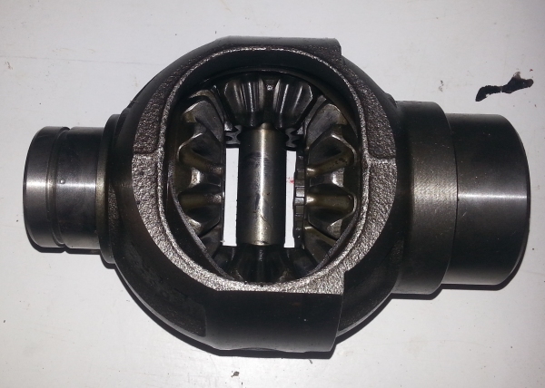

The rear diff is standard type of thing, easy enough to weld up
