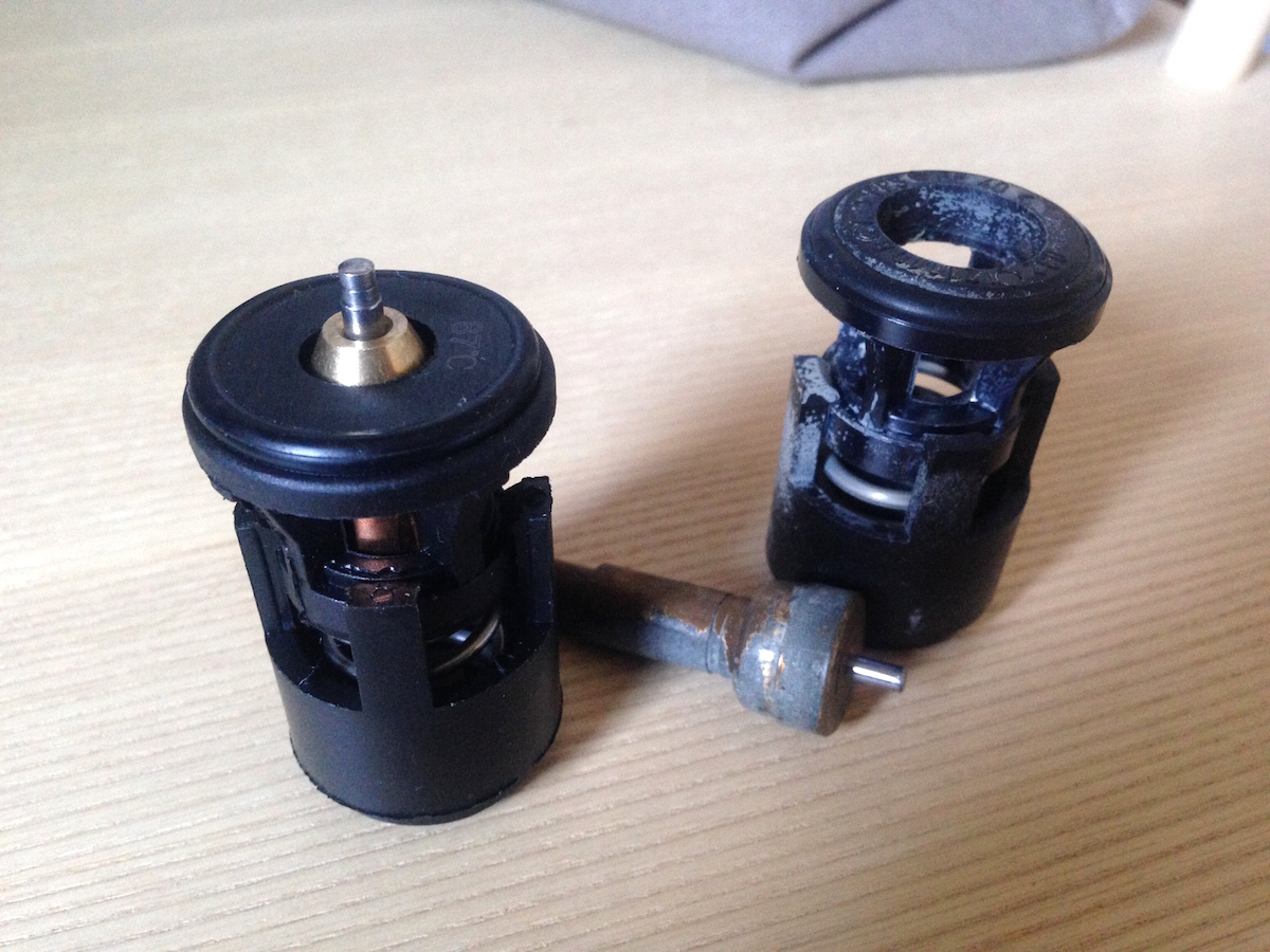

Inspected the thermostat while i was at it, is it normal to be able to disassemble it? Like removing the metal core from the plastic housing?
I wish i could show a picture, but i don't know how to attach it!
I'll PM you an email address and post the picture for you if you want, but do you mean that part number 5, here, the thermostat itself, can be disassembled from cover part number 4, and the main plastic housing, number 1? If so, that seems quite normal to me.  I replaced my thermostat and cover just a couple of months back (the cover was fine but came as part of a cheap ebay deal).

I thought you meant the plastic cartridge with the metal internals, not the housing, because that's obviously a housing with a circular plastic cover that you remove to access the thermostat and not part of the thermostat itself.

Ah, I see there are two very different types, the 032121110B part number with the plastic housing, or the 032121110F version which is just metal. As you can probably guess, mine is the latter. Google imaging those part numbers educates me about the difference.
Just gotta walk the dog, back in half an hour. :)
Yes thats the one, and i probably ment plastic cartridge like sepulchrave mentions above, just part number five, in other words the thermostat itself..
That is probably what i ment, my english is not that great. Im just limping around in this languish trying to make myself understod. Haha :D
032121110B are the one i'm talking about. :) What I'm trying to say is the brass plated metal "core" did come out of the cartridge.

Yeah, once I saw the google image of the B part number, what Sepulchrave said made more sense to me. The F part number has no plastic cartridge, presumably because they kept breaking.
It is definitely broken, fit a new one and all will be good.

Yep, here it is, looking broken:
That's what happens to them, it's why they changed it on the BBY, all the stuff on the AUB that was bad evolved on the BBY, thermostat, crummy dual wasted spark coil pack and leads, over-hard piston rings that wouldn't bed in properly unless viciously spanked.

I installed a new thermostat yesterday, the new one i got have been redesigned so it can't fall apart like my old one.
